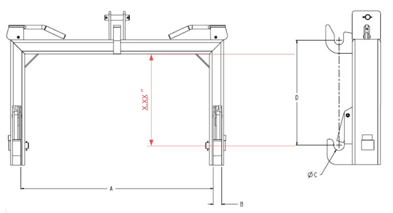

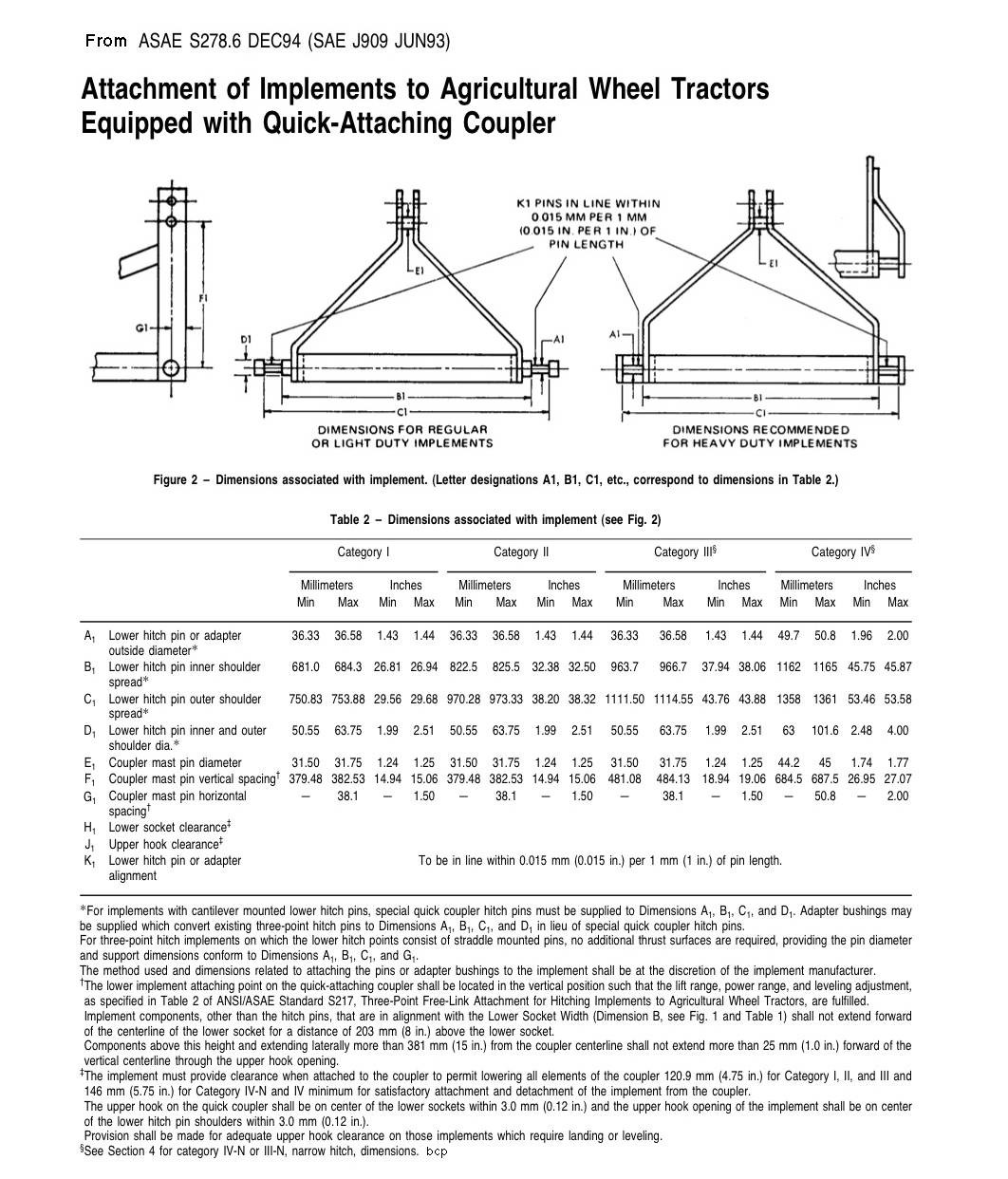

I currently do not have a category 1 quick hitch put plan on buying one in the next few years. I was interested in making a few rear implements and would like to know what is the typical dimension between the center pin and the bottom of the frame member of a quick hitch to make sure I have enough clearance. I understand different brands have slightly different designs and looking for a rough estimate of this dimension. This would be greatly appreciated.
Can you please provide the the following of the category 1 quick hitch. If manufacture or model is not known, then dimension only will be ok.
Category 1 Hitch:
Manufacture
Model
Red Dimension as shown in the drawing. From center of pin to under of frame member.

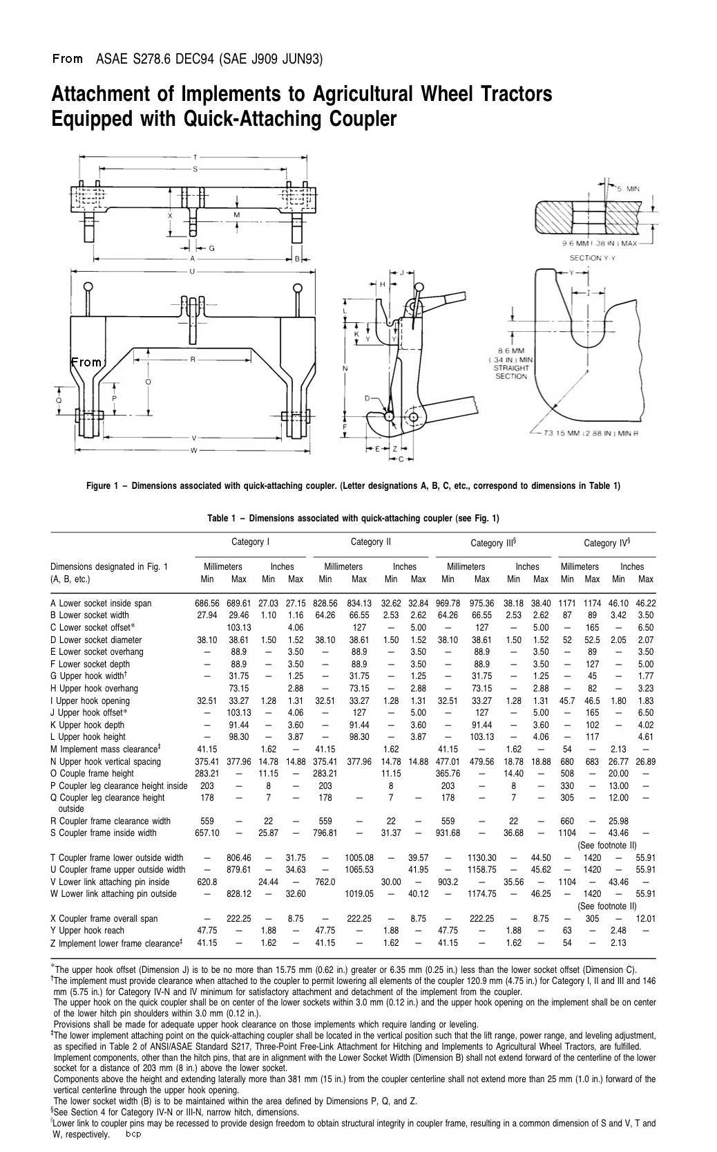

These should have all that is needed.
Bruce
Hitch dimensions
Implement dimensions
/ Rear Quick Hitch Dimension and Clearance
That is perfect, and even has more information that I currently need. I did not know that document exists. Thanks.
