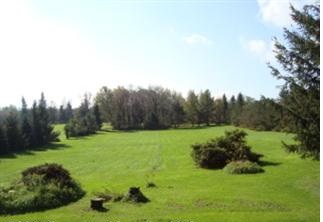

Boss has a 21 acre yard he mows, uses a green tractor with a 15 foot bat wing finish mower. He says it takes about 8 hours to mow.
/ Rear finish or MMM
#23
That doesn't look like its mowed with a finish mower,,,,,,it looks bush hogged,,,,,and you can run a 72" RFM On a 2920,,, or a 5' hog
It's mowed with the current owners TYM tractor in combination with a zero turn. It appears to be 60" MMM on the TYM. There were no other implements I could see around or on the tractor, not even a FEL. I agree. with most posts. The "Yard" in the most back section of the property is going to be let to grow. There is about 8 more acres behind that yard that is all hay. While I am used to rural living I am not a farmer nor do I have the experience to Hay or Raise cattle. Future plans are a nice horse barn and some horses. The upper most lawn gives the property a nice feel. While surrounded by mixed woods and Evergeens it opens up the back making it feel BIG and secluded at the same time. I'd like to keep this mowed. Doesn't have to be a gold course or mowed on 2 inches but at least walk-able and a good place to let the dogs open up. I appreciate all the comments.

Pictures of the property or the tractor? There pics in first post.
EDIT: Here is some better pics.

You could advertise to lease it for pasture, someone in the area with horses could put a dozen or so horses on that and keep it eaten down nice for you. They'd have to throw up some kind of temporary electric fence, but for that kind of pasture I'd be willing to do a little work if it were around here. There's nothing prettier than a field full of horses that you don't have to take care of.

We get a respectable cut with our 6' Land Pride and 10'6" Woods DS1260. We use to use 7' and 8' RFMs, but quit as we had to go too slow and mow too often.
Very nice looking property.:thumbsup:

Personally, I think your looking at too little tractor and and too small a mower....
Take a look at an L5240 or L5740 with turfs and a 96" rear flail mower with an offset....

Wow thats a big. I don't know if my budget is going to allow for that unless I find a nice one used...Why do you say go for the L series? Weight? Power? Or the HP on the pto to drive a 96" RFM?
/ Rear finish or MMM #33
Doug,
I own a Kubota B2910.. It is the predessor to the 3030. It's a nice little machine.
The reason I reccommend such a large machine is because of all the factors weight, power, stability and the pure push/pull grunt power that a larger machine has.
You can get a smaller mower... mowing will take longer.... I think mowing with a flail mower will be faster than a rear finish mower but they weigh a lot more and they take a lot of hp to run.... a 96" unit will take 50hp . Also a flail will not bogg down if you let the grass get 12' high... 12" grass and a RFM is a no-go.
You will have a lot of open space out there and it doesn't look like you need a small machine.... and believe me a 3030 is small when your doing a job like that...
