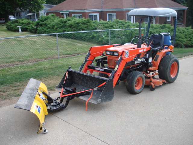

#26
Well, I threw in the towel, and being I sold my ATV, I adapted the plow mount for use on my loader. Long, but seems like it will work good.:D
/ Rear blade options #28
And your mower can blow away what the blade misses? ;-)
