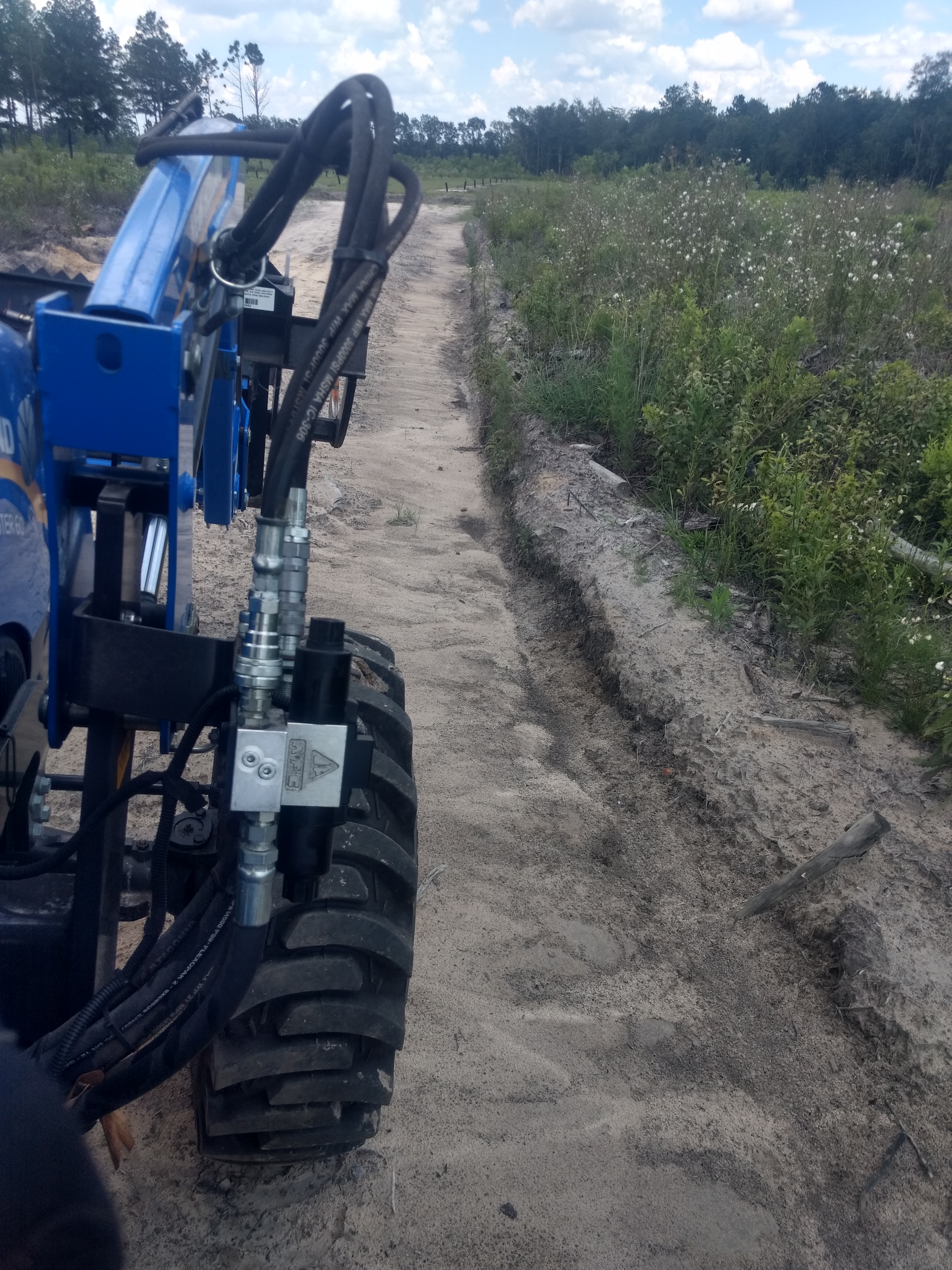

You could try like mentioned about to just adjust a side link down to allow one corner of the box to dig a ditch and push the dirt up on the road then adjust it where it is just slightly tilted and make a few passes to see if it値l give you the amount of crown you like then set it level and finish the job. Disadvantage is you will have to ride in the ditch if you make more than one pass. But, this could do good enough and save you some money.
If you really think you need a rear blade and buy a 6 way definitely look into how much offset it has. You want the most you can get if you are already spending the money. It will keep you out of the ditch when pulling them. Also weight is like with most ground engaging implements is your friend. My Land Pride RBT 4096 has 30” of offset. Also, I ordered mine without the adjusters and ordered my cylinders from Fit Rite.
Look at the Tufline, Allied, Dirt Dog, Land Pride, Woods, and Bison just to name a few others outside EA. All make great blades!
This is mine pulling ditches with the offset keeping me on the road.
