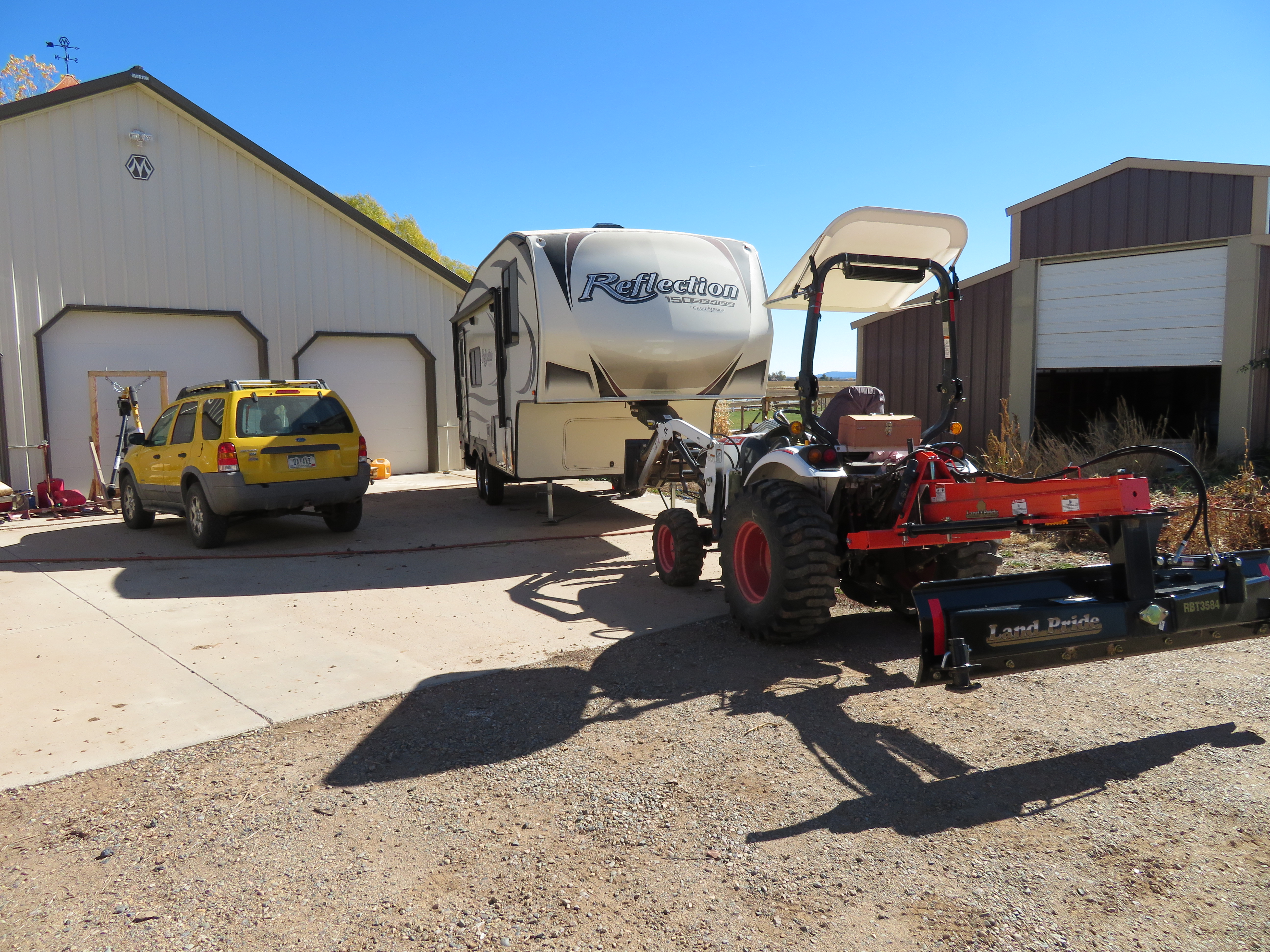

When I finally realized that my 565# Land Pride RB3596 just WAS NOT heavy enough for summer driveway maintenance - I spent around nine months researching on the internet. I'm very fortunate - there is a Rhino dealership just 14 miles away and they had the exact rear blade I had decided on. My Rhino 950 @ 96"/ 1100# makes summer driveway maintenance possible. After the spring rains my driveway dries out and becomes extremely hard - my very own mile of concrete.
BTW - that Bison looks like a good unit.

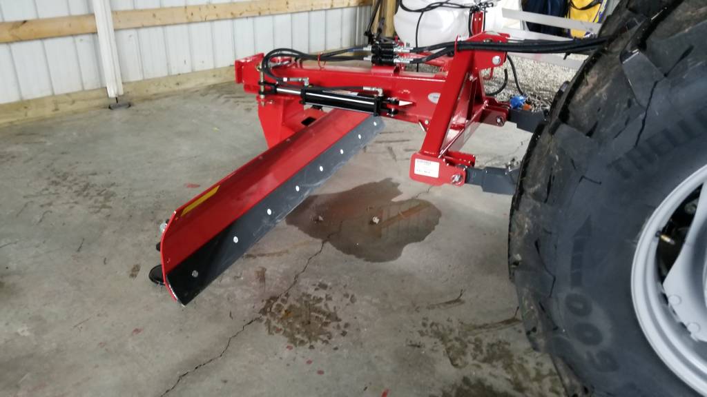

Highly recommend the Land Pride RBT3596 for your tractor. You can get it with all manual adjustments and can easily add hydraulics later. While the ETA blade is nice, the LP unit is a little nicer IMO.
Whatever blade you get, get skid shoes. They just make life easier.
Pretty much all the rear blades of this caliber are very good quality implements, some have features that are a little different than another, but they are all pretty nice.

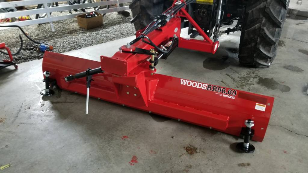

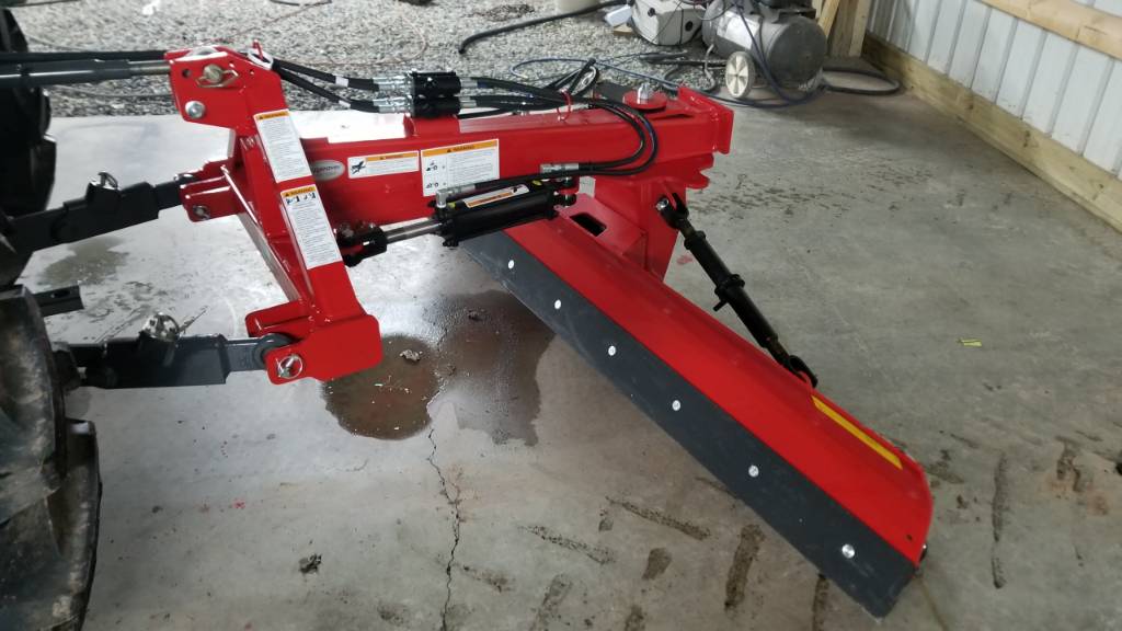

Take a look at the Woods RB96.60. Get the hydraulic angle and offset with manual ratchet tilt. Excellent blade! About $2200...money well spent
I priced out the Woods RB96.60 today, a local dealer quoted $3k for all manual, another $600 hydro angle. 4-6 weeks.
Seemed high.
I am waiting on quote for the LP RBT3596 from my dealer.
Messick's quoted 2900. Freight makes it a no deal tho.
