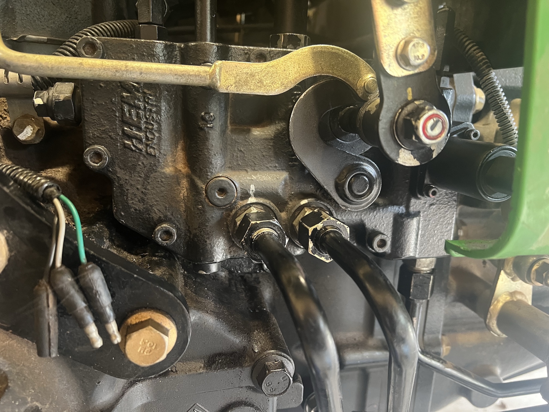

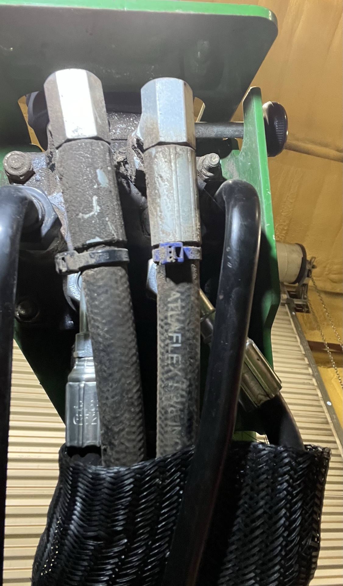

What does the line with the blue zip tie connect too? It is the line in picture 5282 with the long hex fitting two connections above hose labeled 1. That style of talk hex is sometimes an indicator that it is a power beyond sleeve. I can’t tell if line next to it has same style fitting or not.

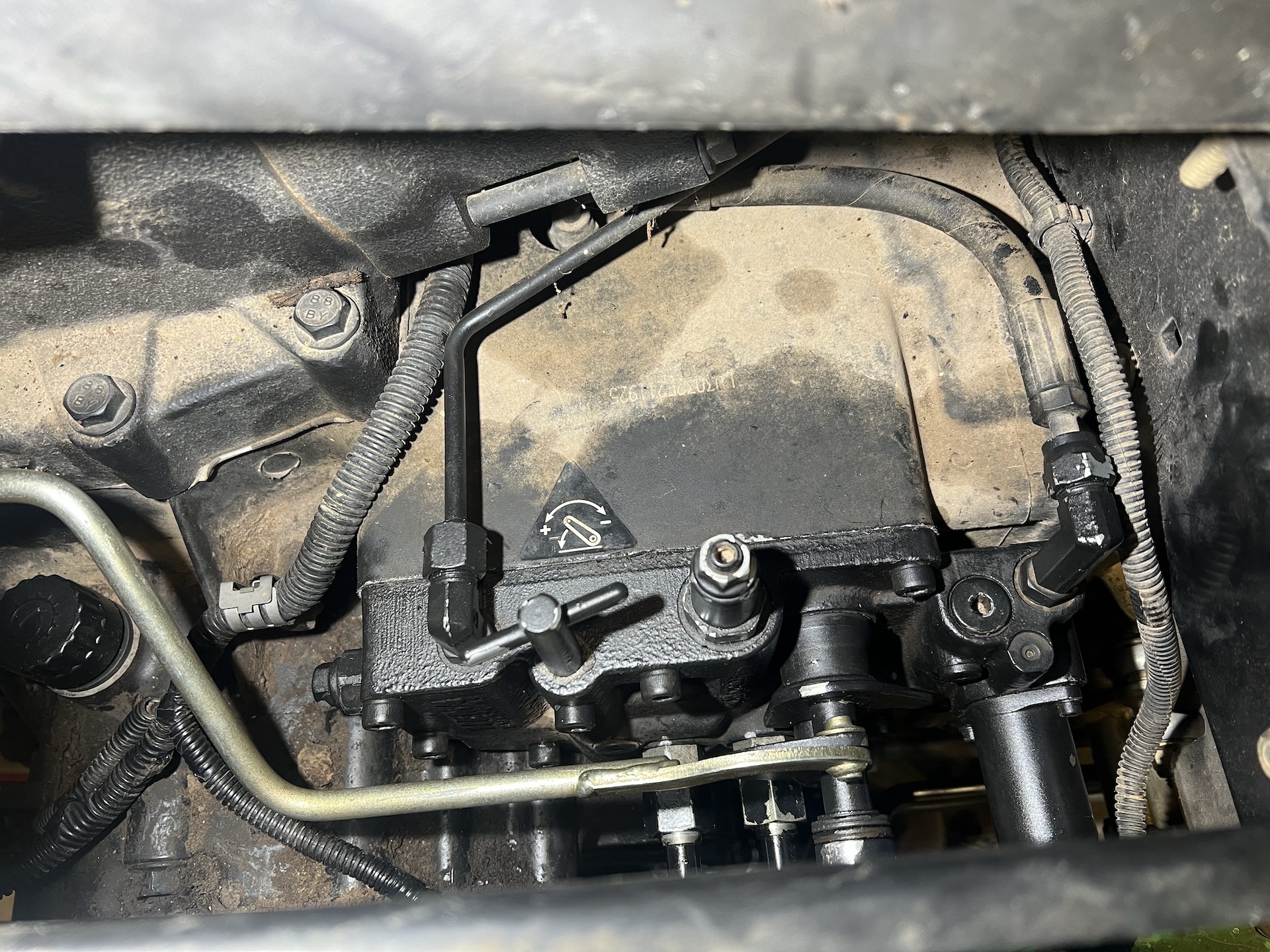

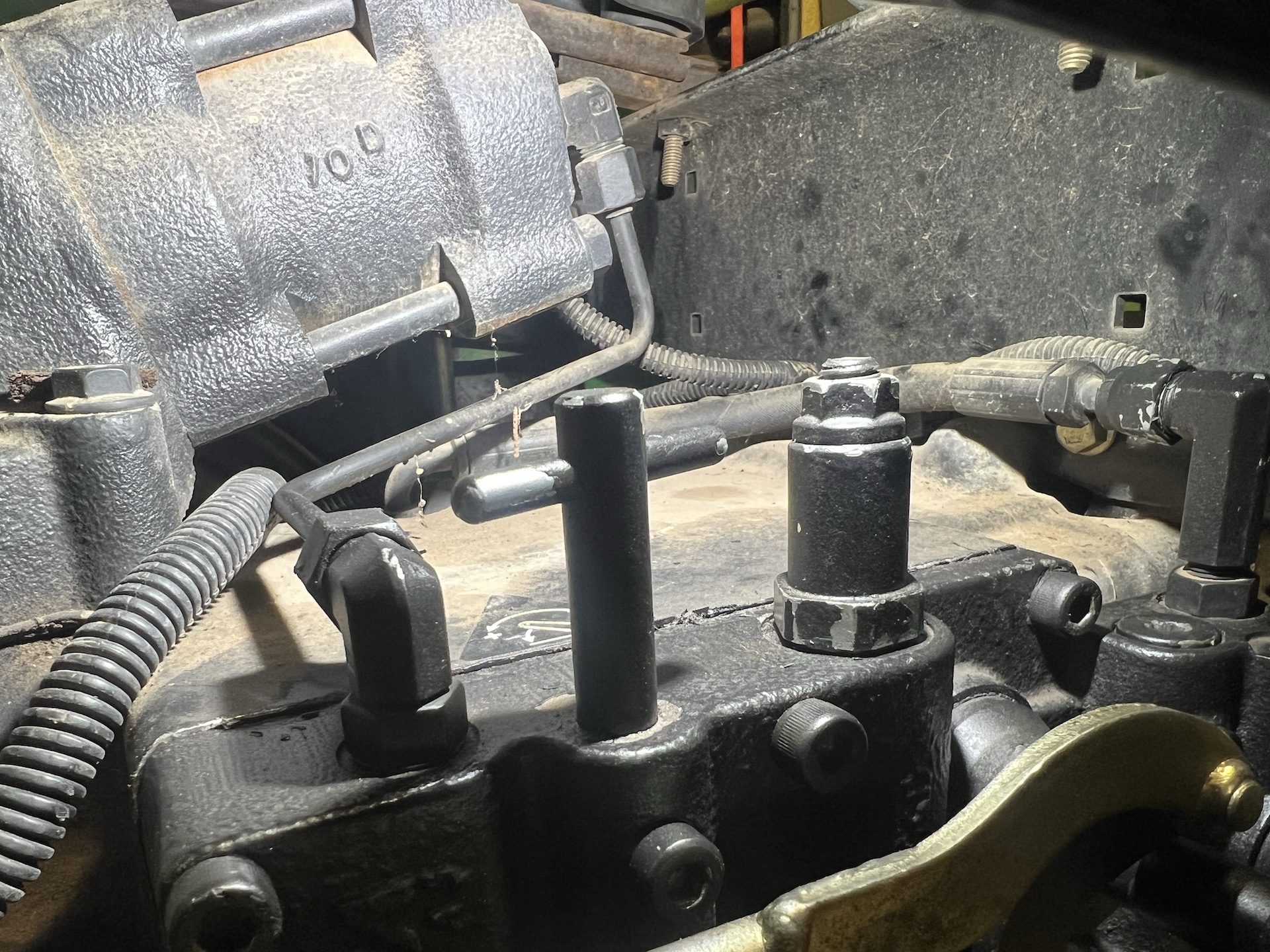

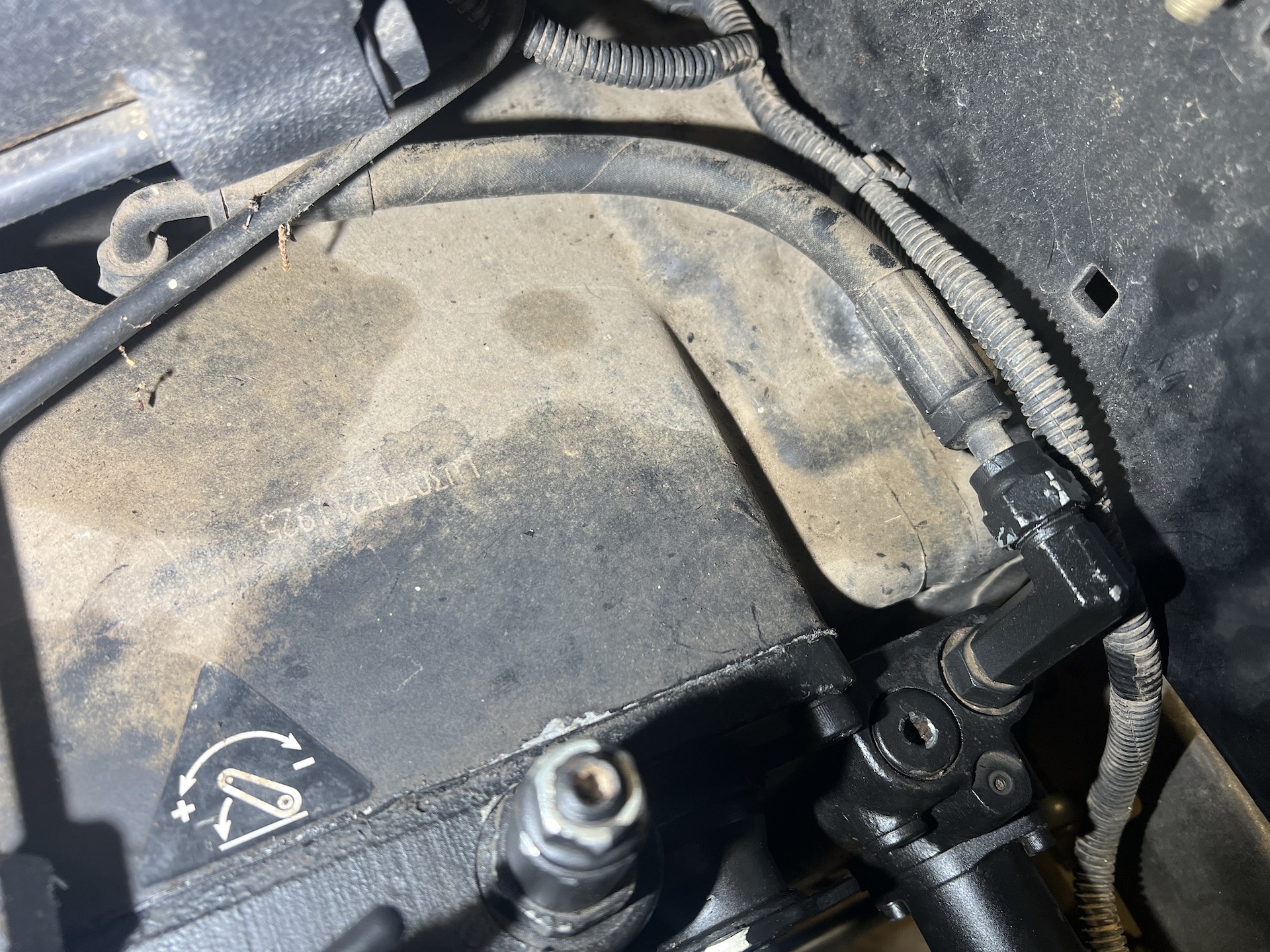

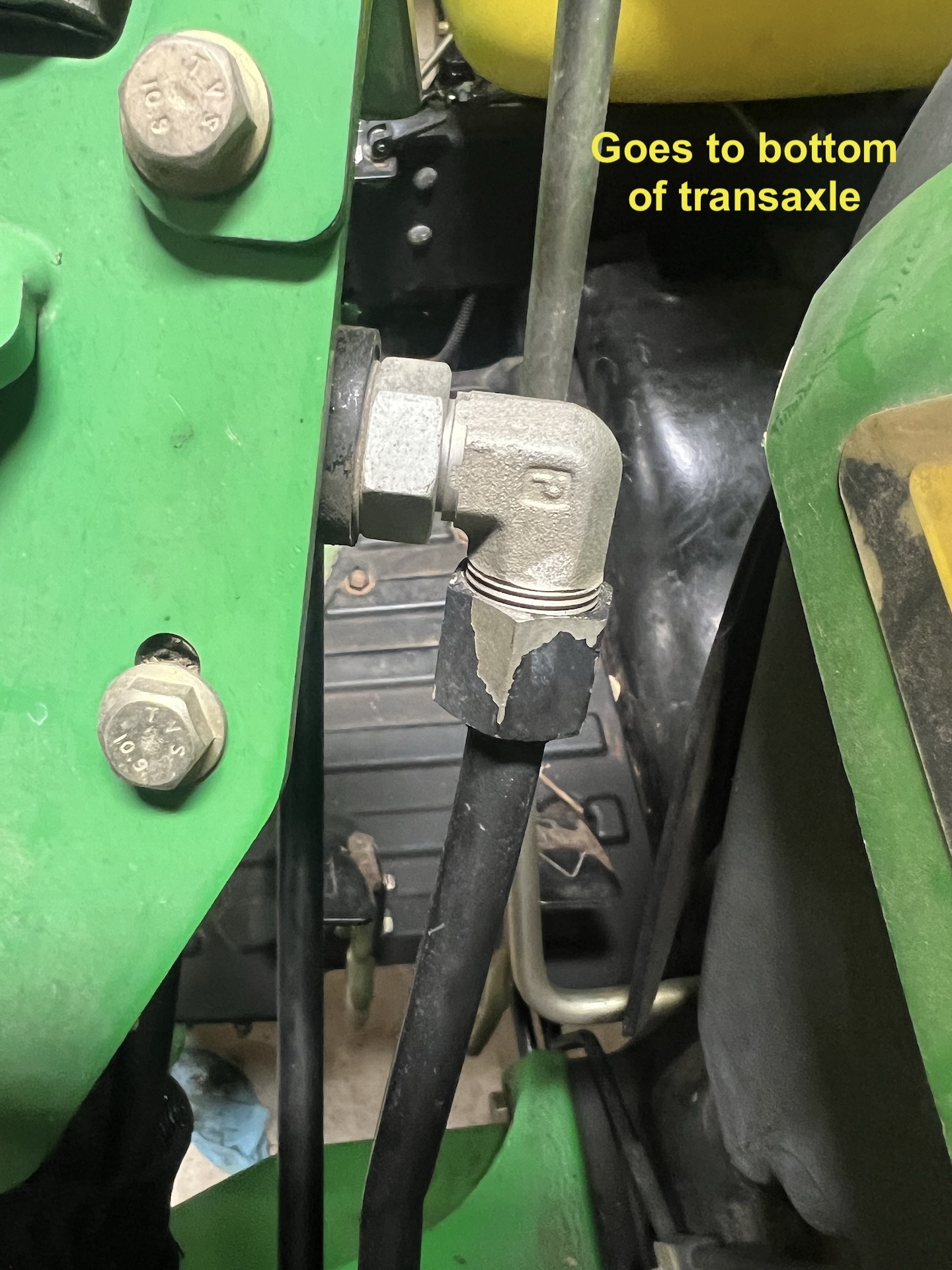

OK here are the lines and where they go. Which of these would be the PB port? - EDIT- I don’t have PB
The blue zip tie is a loader hose up front.
The 2 metal lines underneath go to the 2 ports close to each other on the manifold.
The hose on the side of the FEL valve goes to the port at the bottom of the transaxle.
On the manifold, the one on the lower right bottom goes to the transmission. This is Item H on the hydraulic oil line schematic.
There are 2 smaller lines on top of the manifold as the photos show. The one on the left side goes to the piston under the seat, the one on the right side appears to be a return line and enter the top of the transmission/transaxle.

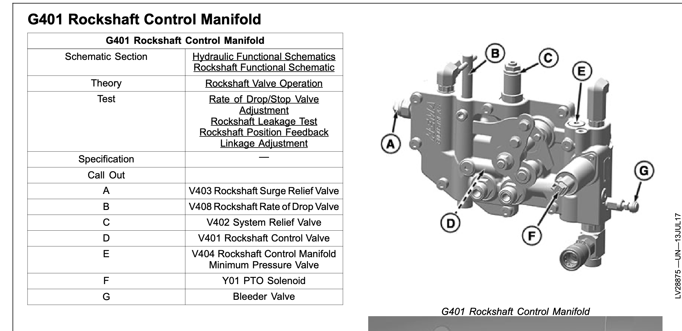

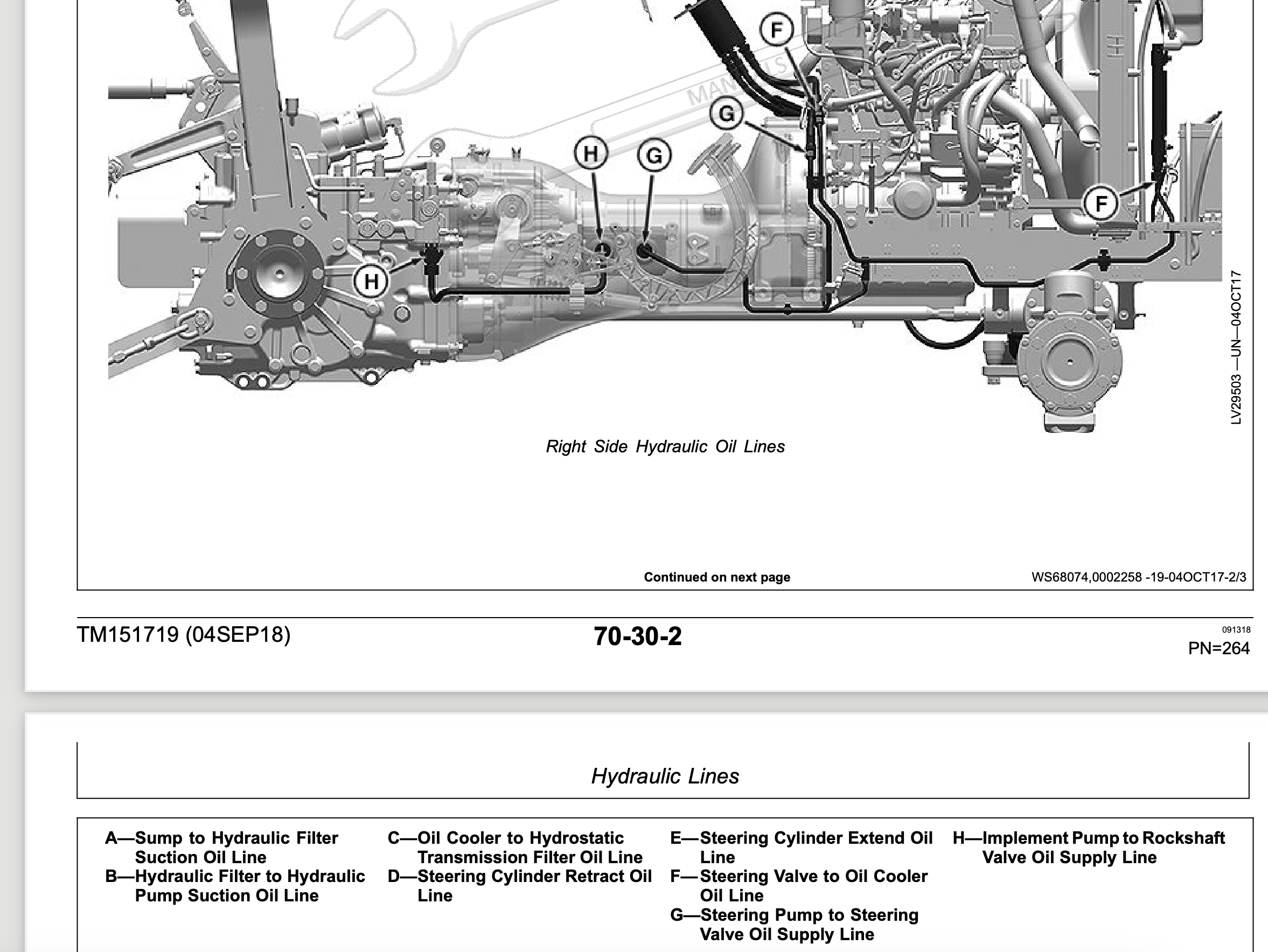

Lastly, here are 2 schematics from the my Deere manual. I don’t have a Bleeder Valve (G), although here is a hex cap. And where H would be on here, there is not a side quick connect
Hope this helps

Page 70-30 -2 shows item H as implement pump to rock shaft valve supply so if my interpretation is correct line H would be connected to power beyond line from FEL to rock shaft valve which is 3 point hitch.
This is based on that diagram on page 70-30-2 not including an FEL valve.
