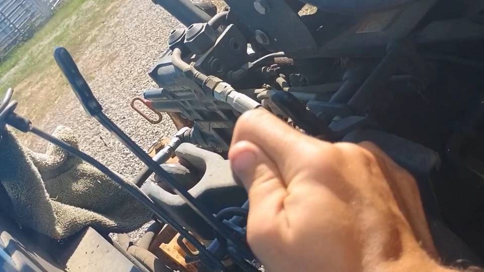

I have a Ford 5610S. Just changed the five O-rings under the unload valve on top of the Hydraulic Lift Cover. Very easy and simple job. However, when I got things back together and tightened down, there is a squealing sound coming from the rear 3-point hydraulic when lifting. I think there is more than likely air in the system, but I have no idea where to start on bleeding the air out of that is the issue.
It did not make this squealing sound prior to replacing the O-rings under the unload valve. I tried to attach video but it won't allow me. If you want to hear it, message me your email and I'll forward it

Is the sound coming from the unload valve?

This video should work guys. Sorry I am not good with uploading videos.
