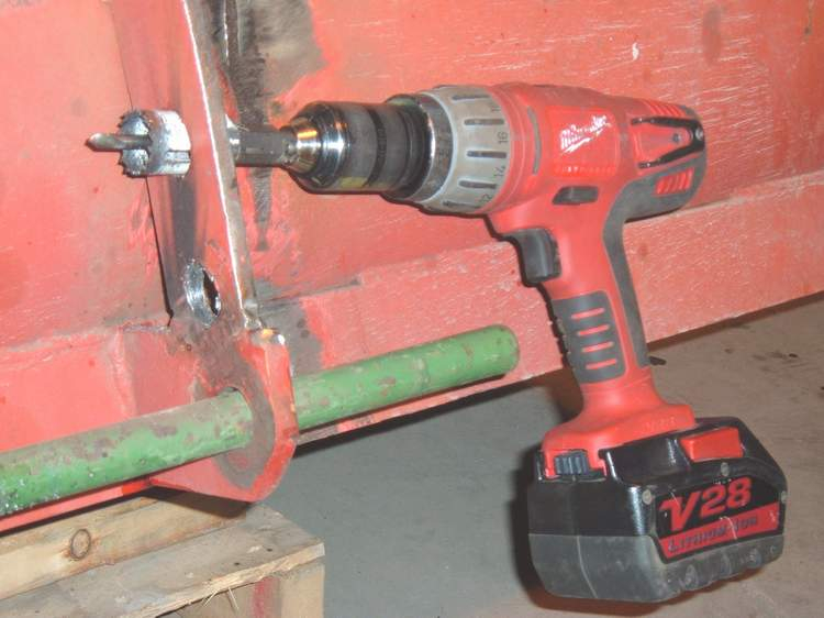

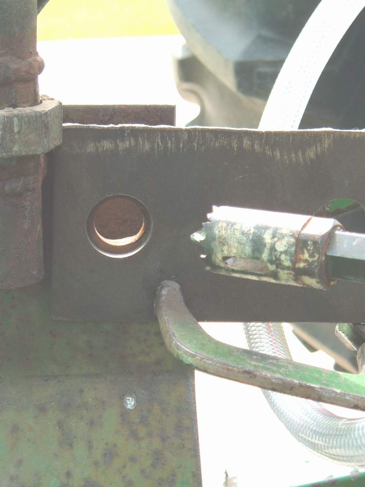

I used to use every tool they ever invent and have rotary files and super air power but as I ripen a little lean to easier and simpler, cheaper and faster. This is a version of this but get a bi metal with more teeth, they make a couple versions but this size bit works fair and lets it be done battery drill and chances are can use the bit for another couple dozen holes. The uni bit would be great as a starter to seat the holesaw.

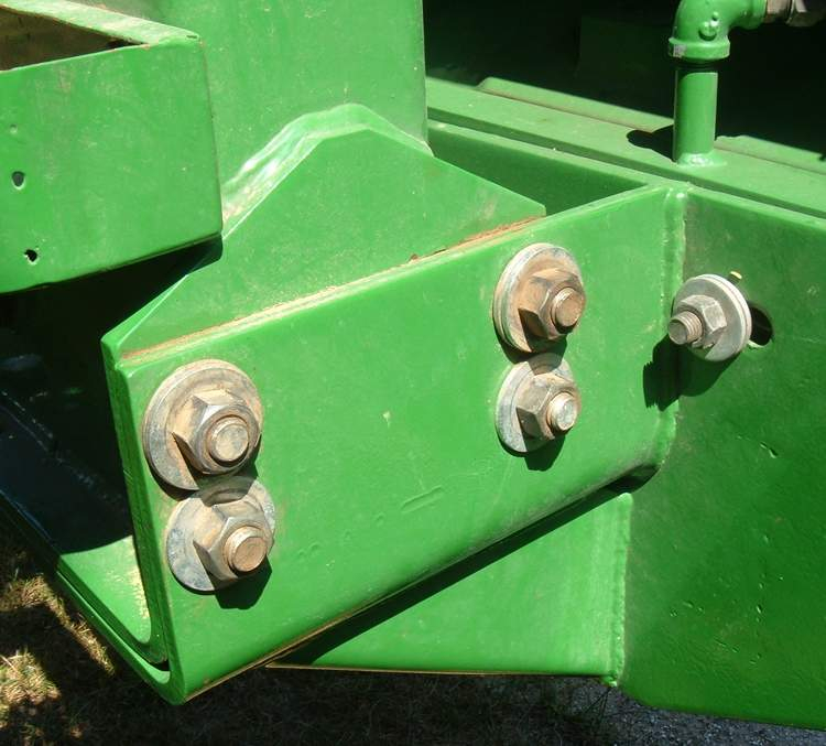

In hidsite it might have been easier to get 2 bigger bolts fine thread each side to fill worn holes let this loader come loose but I drill 2 new 3/4 below the old to use typical bolts. Made 4 holes, 2 each side thru a couple 1/2 plates, took about 5 minutes each with a little water. Drilling horizontal is good, lets the shavings out.
New holes let me use common bolts I stock, all same size and can hammer them tight 1/2 impact. Hasnt come loose since.
Some of those dont even drill a pilot hole, once the bit starts its good. Fix oblong holes this way also. Weld the "egg" part up in a drawbar lets say and true it back up with a holesaw. Lets a guy to quite a precision tight hole.

Both, the red pic and the top were 3 point assemblies come to think of it. The top was 7/8 and a pain to fuss with a bushing or find a smaller bolt than the rest of our stuff and one day I reached the end and punch the holes out to inch.
We dont use it a lot but hook a couple times a year and it just added a step we always forgot till we got there. Just made it standard.
