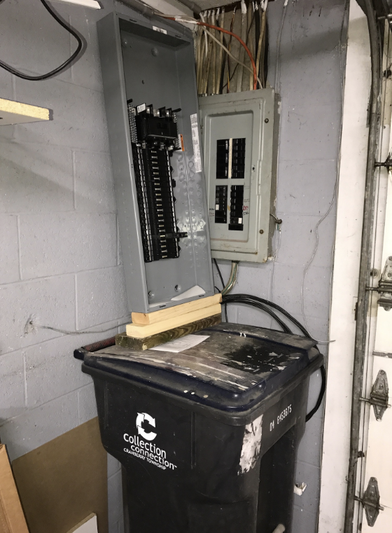

Looking at the new box next to the current one, it doesn't look like my mains will reach even if I stick more of the main coming in at the bottom. The main ground is my concern now. I may have to step down to a 30 circuit, 60 space box since they are about 5" shorter. If I hand the box upside down, the neutrals will not reach to the bottom of the box where the neutral bus is located. I'm scheduled to have the meter pulled this coming Friday so I want to be prepared.

So if you ran the panel right way up, slid the box as high as you could go with the amount of mains length you have, your bars would be at the top and all your circuits you have now would be at about the same level...so what would not reach where doing it that way? Would the box itself just be at a level you are not comfortable with?

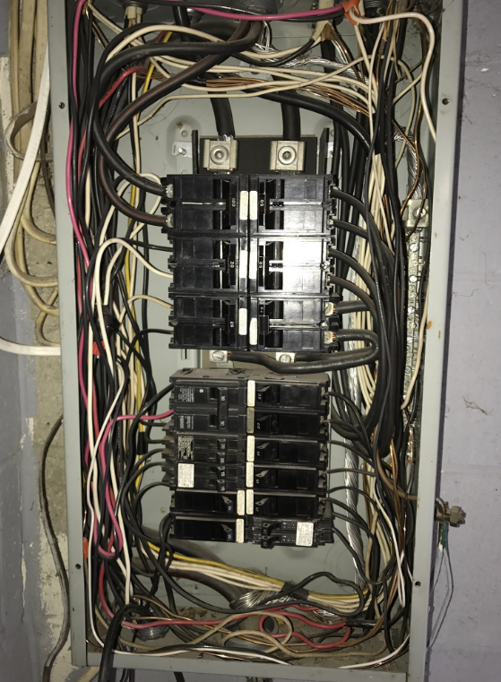

I don't think the mains are going to reach by the time they go up the side of the box. Here is a pic of the current box. The main ground on the right is going to be an issue reaching to the new box in the center.
