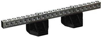

You can add an insulated ground bar in the panel (you should be able to get one specifically designed for your particular panel, but here's what they look like):
.. and then connect it to the other ground bar using a piece of #4 AWG (solid bare copper, or stranded THHN insulated). This guarantees that the green bonding screw that's actually bonding your neutral on the other bar will affect both bars if it is removed. It's common to add these for isolated grounds, where they're connected to a different ground altogether instead of the other bar.
Note - the one you buy may come with its own bonding screw, and the appropriate tapped hole to receive it - so check for that prior to connecting the two together (IOW, read the installation notes that came with it).
