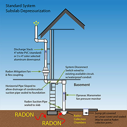

I need to do a bit of sealing first. When when designed and built our home, we left a 7 ft by 7 ft elevator shaft going from basement to the second floor. I left the 7 x 7 area in the basement floor open, no slab. So good news, a place set the sump/pipe for the fan to put a negative pressure under the slab.
We have a poured concrete basement walls and floor, 3800 sq-ft. About 8 inches of crushed stone under the slab, gravel even to the top of the footer.
I get the basic concept of the Sub slat suction method, make a slight vacuum and any gas that would normally rise via cracks and gaps between slab and wall will be drawn out the 4" pipe. If the suction pipe is really sealed to the slab, the only out put will from under the slab. I assume the output of the fan should be quite small. How much air can leak through a hairline crack? The slab at the edges is poured on top of the footers.
Our basement is huge and has poured internal walls so we are likely facing several suction points. One method to determine if you are creating enough suction is a vacuum test. Imagine drilling a 2 in hole and sealing a 2 in shop vac hose to it. Then at some given distance drill a 1/2 in hole and see if there is suction. One way to see if there is suction at the 1/2 in hole is to insert a 1/2 in tube and see if it will draw water up any bit.
One thing I read is making a sump, or pit under the slab where you have the 4 in pipe for suction. I don't see how having large void or a small void would have any difference. Suction is suction. Volume is controlled by how many cracks/gaps and the out put pipe dia.

I have never seen a system installed with more than one hole drilled with 1 suction point in the slab. You can do it yourself but you will need to rent a 4" hole saw for the concrete floor and a 4" hole to get outside. You will also have to run electrical to the motor outside. You should also seal all cracks as well as sealing the sump pump covers. I think we paid $800 to have ours installed. I'm in new homes all the time and they are all pretty much the same type of install.

Not sure what you mean. The 4" pipe goes through my concrete floor then runs outside. The air pump sits outside and then the 4" pipe continues above the gutter line. The actual air pump is almost silent and pulls very little air. Where would you get heat loss? The air is pulled from under the slab of concrete.

As kcflhrc pointed out, it is important to understand that radon mitigation systems aren't designed to pull radon gas out of your house and get rid of it, it is meant to pull the gas from the soil under or around your house and vent it away.

The air/gas is pulled from under the slab and is in the gravel bed. When that air is pulled out, it is replaced by air from your basement via cracks and gaps. Then air from doors and windows replaces that air. Thus cold air in, basement air out.
These fans have a rating of 170CFM, and not sucking 170 CFM from compacted dirt. The fan just creates a curtain of air flow under the slab pulling air and gas with it.
