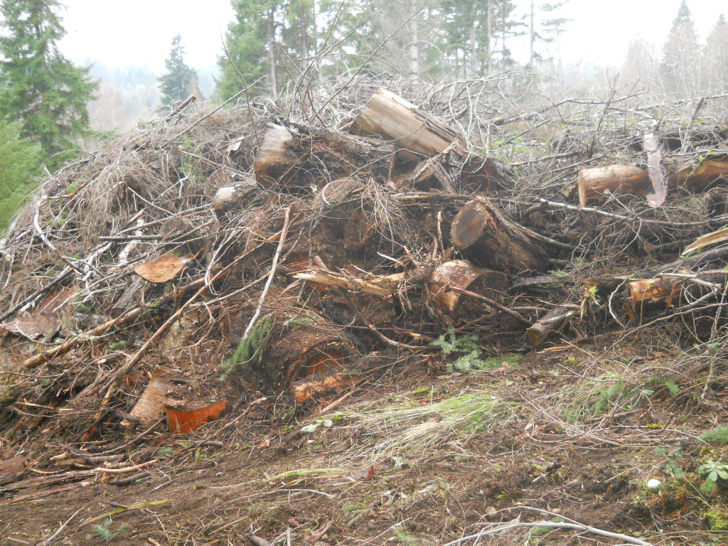

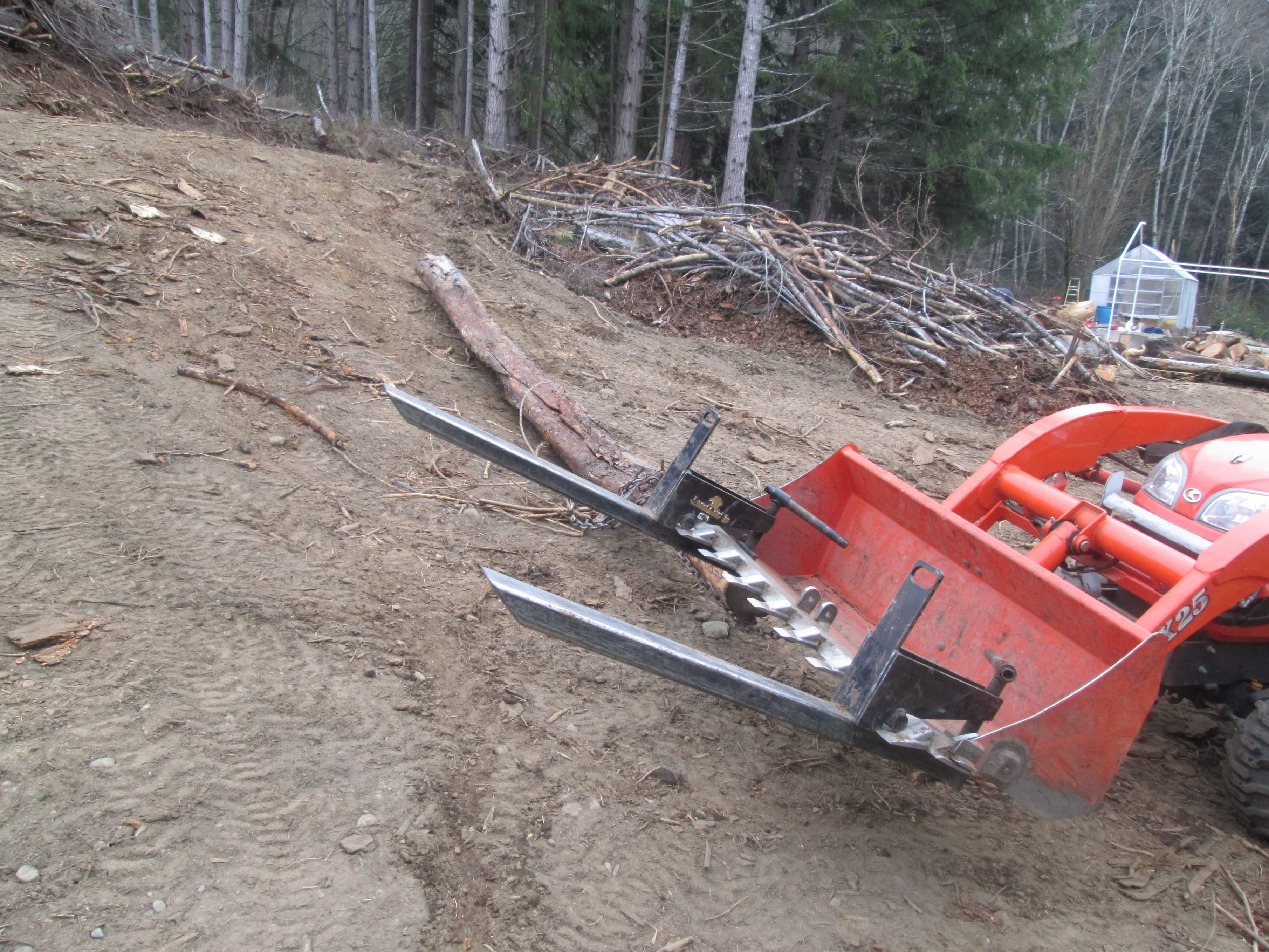

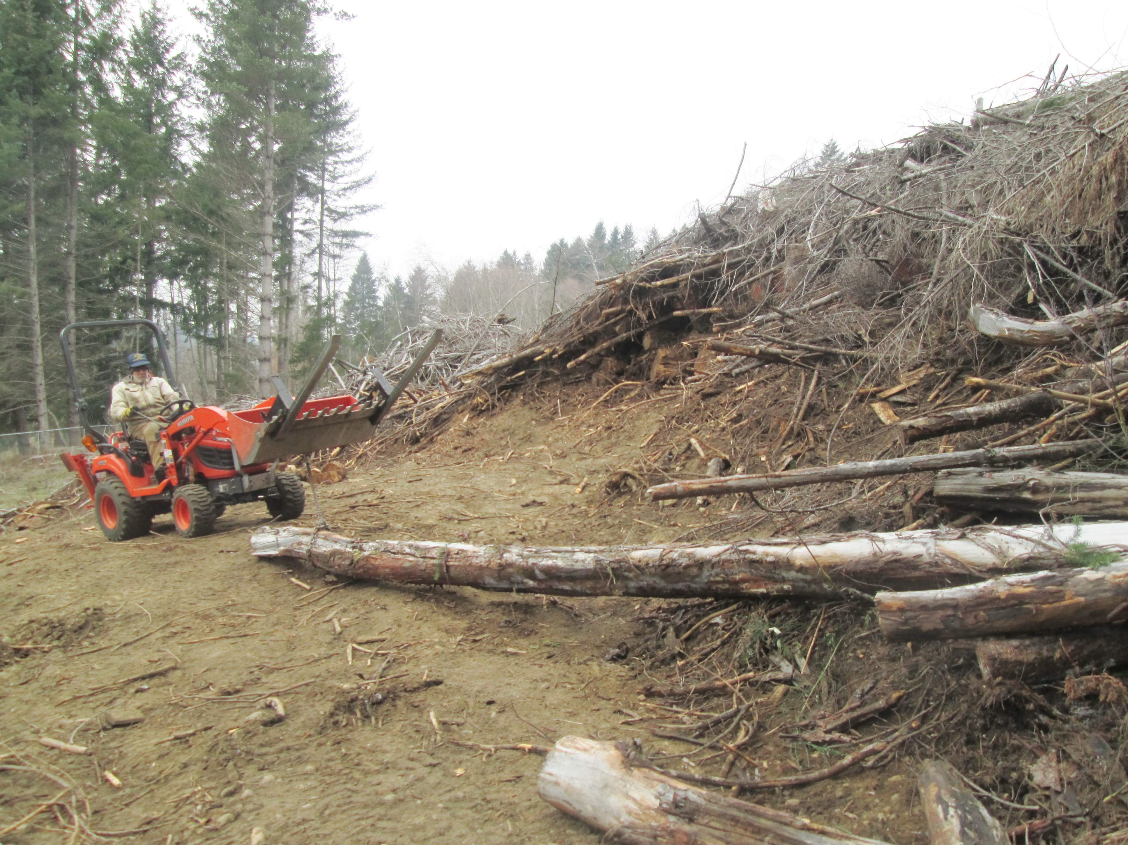

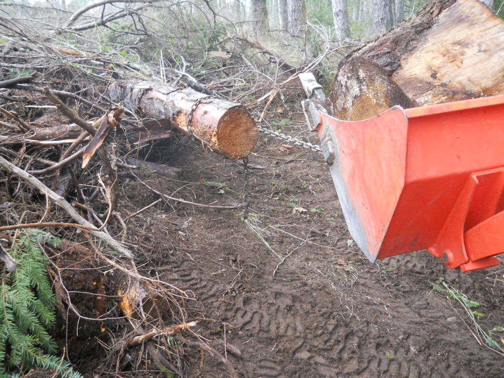

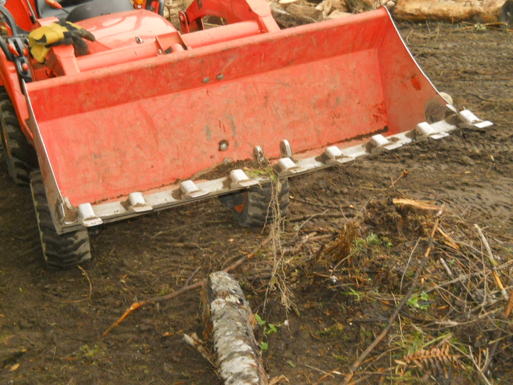

I looked at both plus other solutions and decided my requirements need something heftier and more aggressive to use on my BX 25. See the attached pictures. This sucker will now dig like crazy and curl back and I can still back blade. I spaced the teeth so I can put up to 4 clamp on forks with it still on. I even made a clamp on class three hitch to move trailers around.
D203.JPGE204.JPGIMG_0402.jpgIMG_0416.jpgIMG_0409.jpgA205.JPGH210.JPGK212.JPGIMG_0418.jpg
Some show me at work with the BX. That log is green Madrona and probably weighs close to 500#. I pulled that pile of logging slash apart using the FEL with those teeth. A smooth edge would have never done it.
Ron
