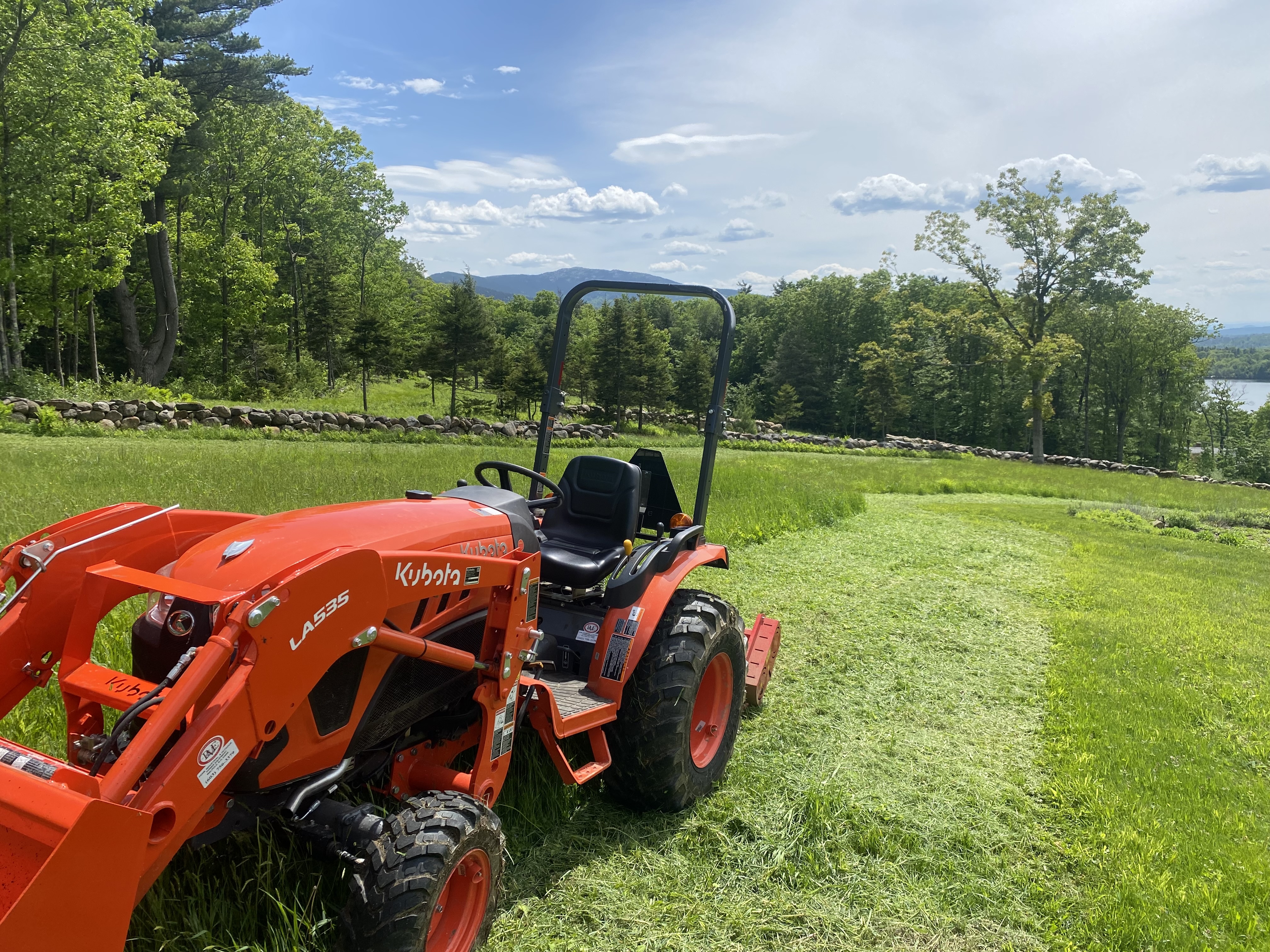

We're looking at getting a ~25hp CUT (B2601 and LX2620 are the top of the list).
Tasks will be general property maintenance - mowing, brush hogging, snow removal, material loading, logging, rear blade work.
However, we are probably going to down sizd our tillage to run with the smaller machine - 3 point passive implements like a plow, disk, cultivator and not live rotary like a PTO driven roto tiller. We may eventually do a roto tiller, either ours or borrowed, but by using the term "tillage" I mean tools pulled through the ground to do the work and not the PTO.
Friends of ours have R4 industrial tires on a variety of compact tractor sizes from a BX up to about 40hp and when I posed a similar question specific to mowing they all feel very comfortable with R4's over R3/turf tires.
What concerns me is the snow work and tillage. Snow I can add chains if needed. Tillage - Im not so sure on that one.
Thoughts?

I have R4s. I'd probably switch to R14 if I had to do it over again. Most of what I do is loader work.
Tillage? R1. However, you are getting real tillage done with that light tractor. If you're dealing with snow, maybe listen to the guys who get some and use that size of tractor on it

Got this with R14's , great for mowing, much better traction than the R4'S on the previous tractor. They do great in snow as well.
