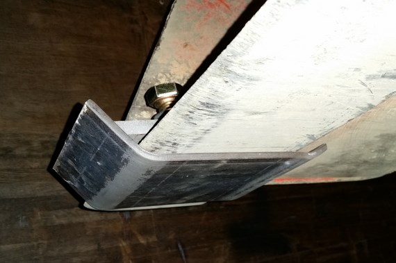

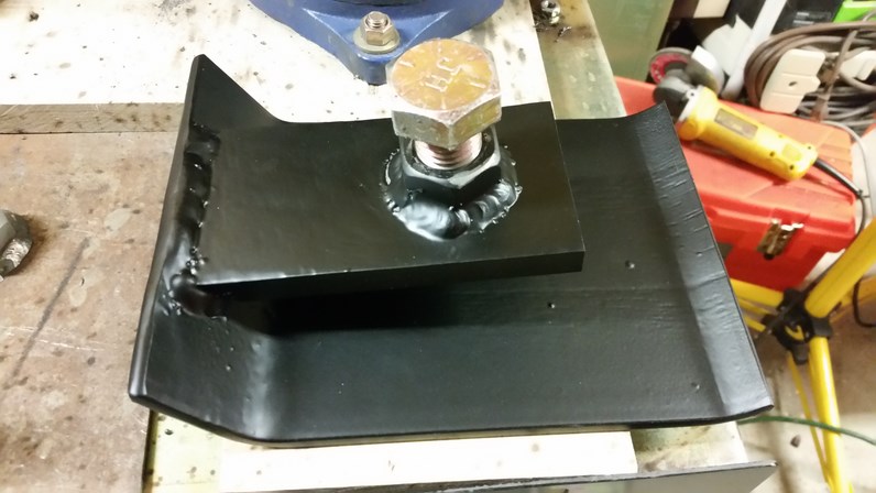

If you're using a bucket, "skids" make a big difference on gravel preventing the bucket from digging in. Could be made to work with a snowblower as well.
