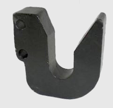

Any pictures? Didn't see any when I went there on my phone. At $15-20 it's barely worth my time to make my own extensions.

i'll try.

Made it easier to see. Looks like the holes aren't as far from the hook as on the ones people make.
