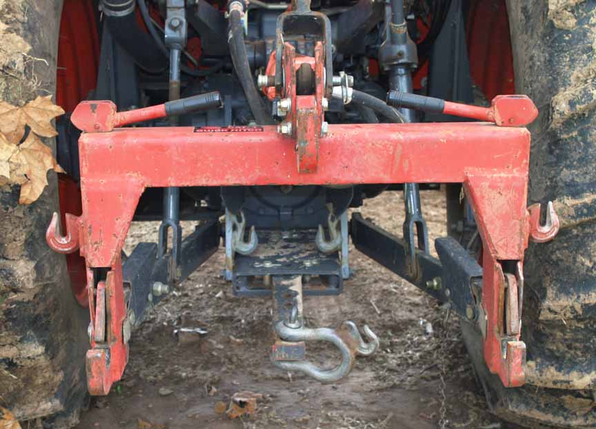

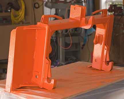

I have a Speeco hitch from Tractor supply. Love it. I also have a JD Imatch that has been modified so it also fits on the FEL Bobtatch hitch. Love it.
It takes a little effort to modify old implements to fit the quick hitch, but for me the effort has been worth while.
I welded a chain hook on each side of the Speeco, near the top. If I have to hook a very heavy drawbar implement to the drawbar (14,000 lb roller or 14' disk) I hook a chain on the far side chain hook, under the implement tongue and hang it on the other hitch chain hook. By lifting the hitch I can raise the implement and back the tongue right onto my drawbar.
Flesh, fingers, and vertebrae are valuable to me. In addition to speed, minimal frustration, and no pry bars, tools or hammer, the quick hitch is much safer to use than without.
If mine broke tomorrow I would buy another one tomorrow.
I personally don't care for the Pat's design. I leaves off a lot of the advantages of the Imatch or Speeco. IMO the JD hitch is higher quality than the Speeco.
/ Quick hitch #25

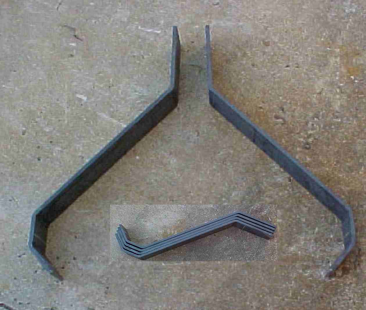

I forgot to add that a speeco hitch and a hydraulic top link work very well together.
I like to make my own attachments. With the flat bar shown it is very fast to weld up the hitch parts of an attachment.
photos attached.

The hitch in the second picture is that set up to mount on a fel. just wondering about the plates welded on the sides. I have a speeco also and like it very well. The only thing i can't hook to is my Bushhog brand cutter but i'm going to fix that very soon.

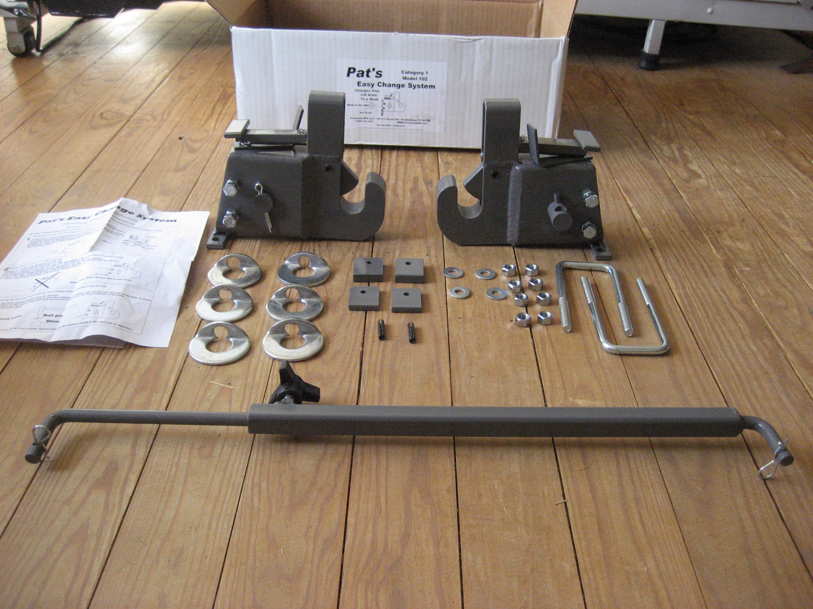

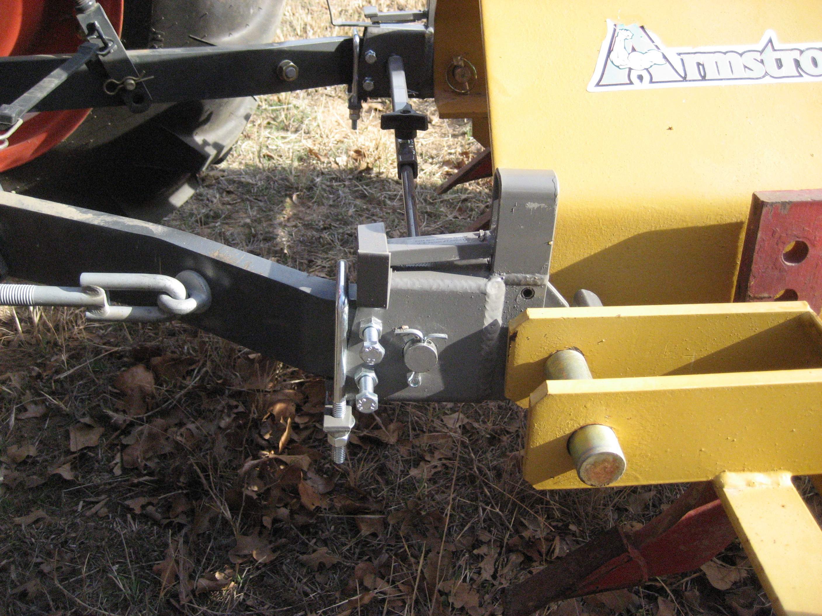

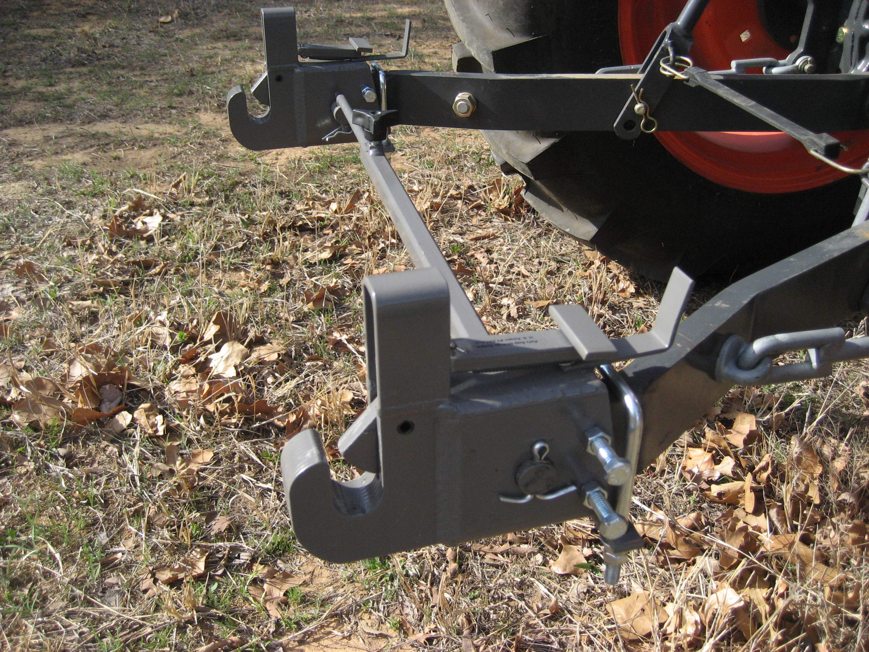

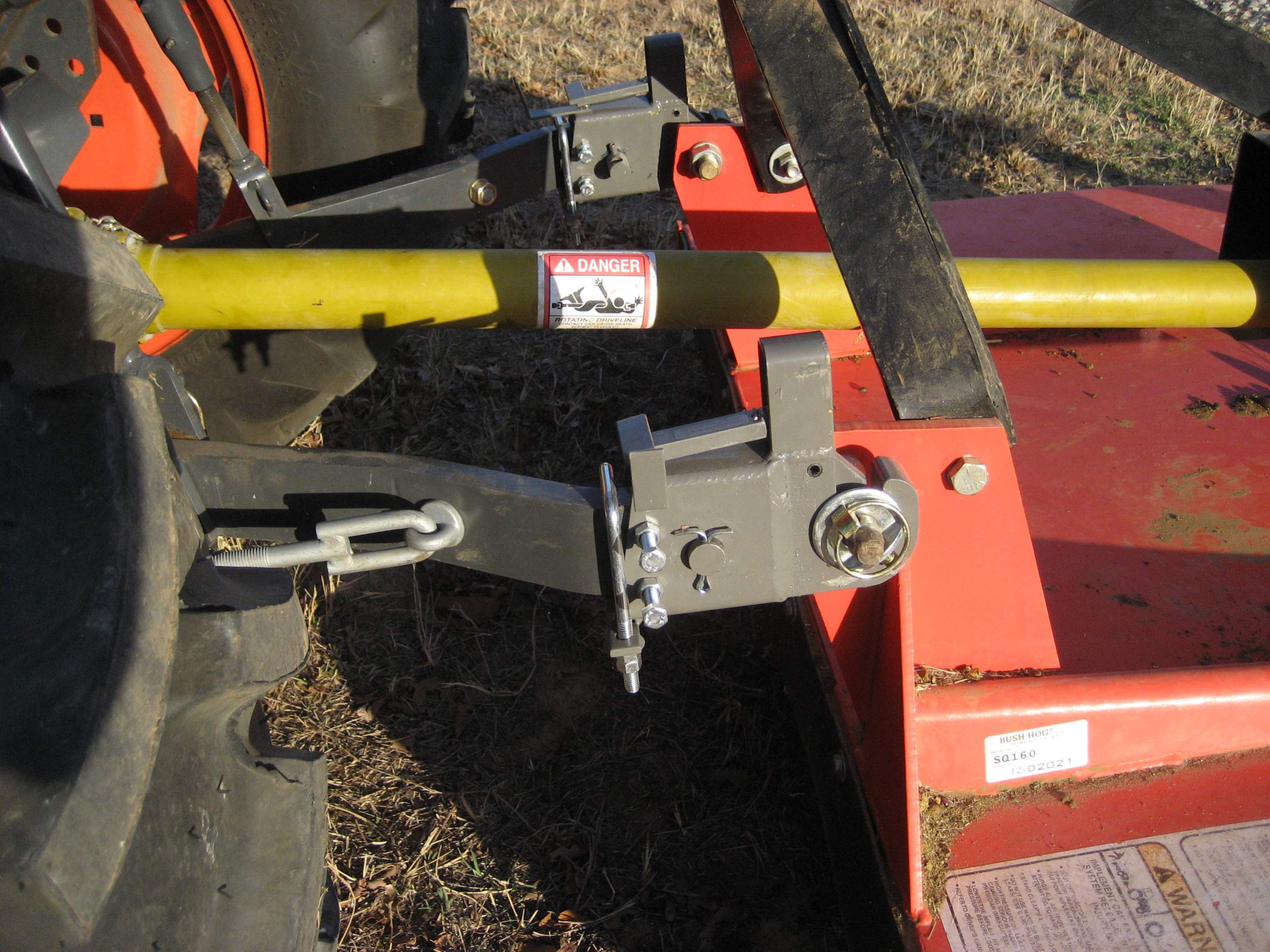

Hey y'all, Got my Pat's Easy Change on Tuesday. Didn't get to install it 'till this afternoon (Fri).
Took about 20 minutes to install (took my time to read the instructions carefully) and I was on my way. It's nice to be able to just back up, make contact with both pins, then lift and hook. No modifications to the attachments. I tell ya, I was taking up to 30 mins to hook up before.
One thing, it adds another 4" to the length of your arms. My Top Link extends fine. But for my Brush hog, I might get a longer PTO shaft. I measured only 7 1/2" overlap. My Operator's Maunal says a minimum of 6". I don't feel confortable with 7 1/2". I have to think about it more. It should be fine (i.e. I'm sure it complies with metal fatigue and sheer stress levels) but, I think I just want to make sure with a longer PTO shaft. Any comments?
Another thing is that the Stabilizer Bar helps alot to get the right width. But, with the Brush Hog you need to remove it after you're hooked. Cause, it will get in the way of the PTO shaft. The Stabilizer Bar uses a Spring type Cotter Pin to secure. There should be an easier way to secure it without those pins.
Anyway, here's some pictures and overall, I highly recommend it!! It sure is faster.
