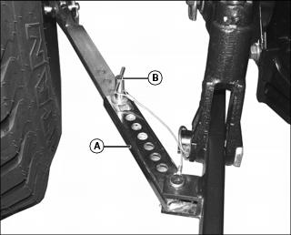

Also may be a dumb question but what do you guys use (for those without an Imatch or similar) to keep the bottom links from swaying towards the middle? This is what I fight the most. I back up to an implement my links are swayed to the middle and when I need to swing them out to hook up they get caught on the implement causing me to make several forward and backward movements with the tractor to get it right.
I pin my links open with the sway bars. Maybe you can make something that would go between the draft arms just while you back to the attachment?
That's one of the reasons I lower the draft (lower) links slightly below the implement pins. If one or both links drift in, it's easy to swing them outboard.
The other reason is one of the links is, invariably, at a slightly different height (most often to to the ground it's parked on).
Anyway, works for me...

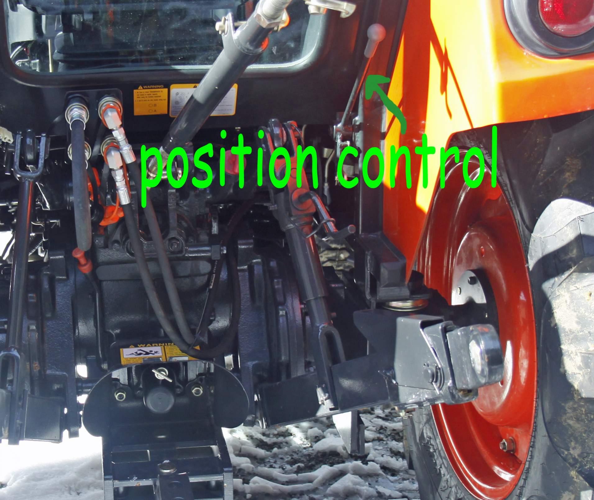

Now the new Kioti tractor has these adjustable 3 point hitch link arms. it also has a rear accessible control point to raise and lower the arms. I went and played with hooking up my wood splitter the other day, and man was it easy. i just drove till i was 1" from the pins, and stepped outside. After releasing the link pins, the lower section of the lift arm pulled out, and was able to lift or lower them about 2" either direction. that and the rear lift/lower control, it took only seconds to hook up the splitter. And i didnt have to push and shove the splitter to align the holes.

Rear accessible control point; The standard one is just between the seat and the right wheel fender (-: I can lean over to get to it.

well mine is a cab model, so by adding the rear control lever, i dont have to keep opening the cab door and adjusting the arms
That's right handy!
My 4400 is an open station, so reaching over the fender isn't a big deal...but I can see it would be a PITA with a cab tractor. Anyway, I don't swap out implements that often. Since the tractor mows most of the summer, the RFM stays on for weeks (up to a couple months) at a time. Not much brush cutting anymore, but I cut that field once a year so the cutter goes on for a day or two. Then, after the mowing season, the ballast box goes on for the winter. Maybe half a dozen to eight change-overs a year, typically.

So, how do those telescoping links lock in place, once the implement is hooked up?
after i hooked up the splitter, with top link in place also, i simply raised it up, then it slid back in place and locked
