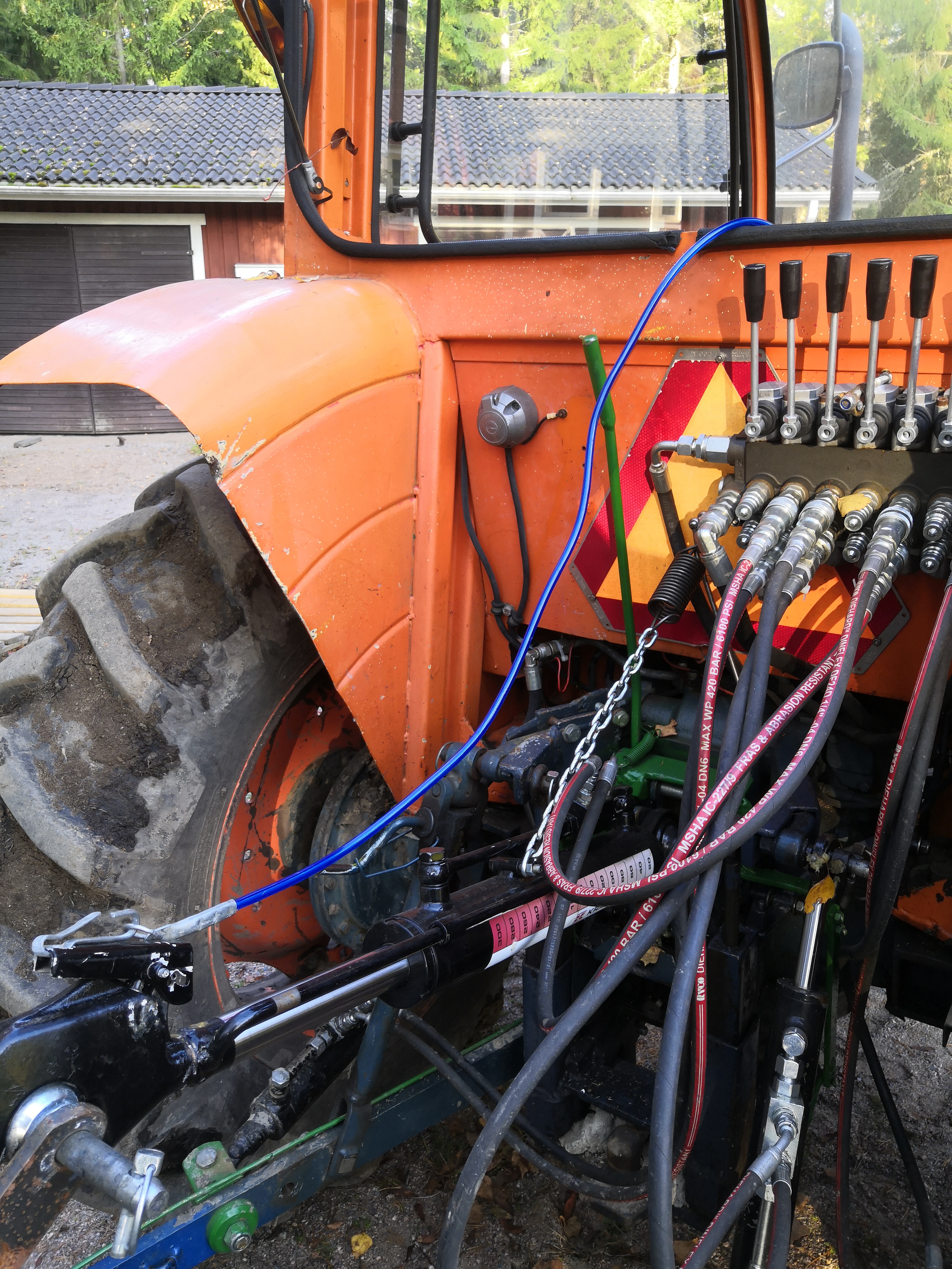

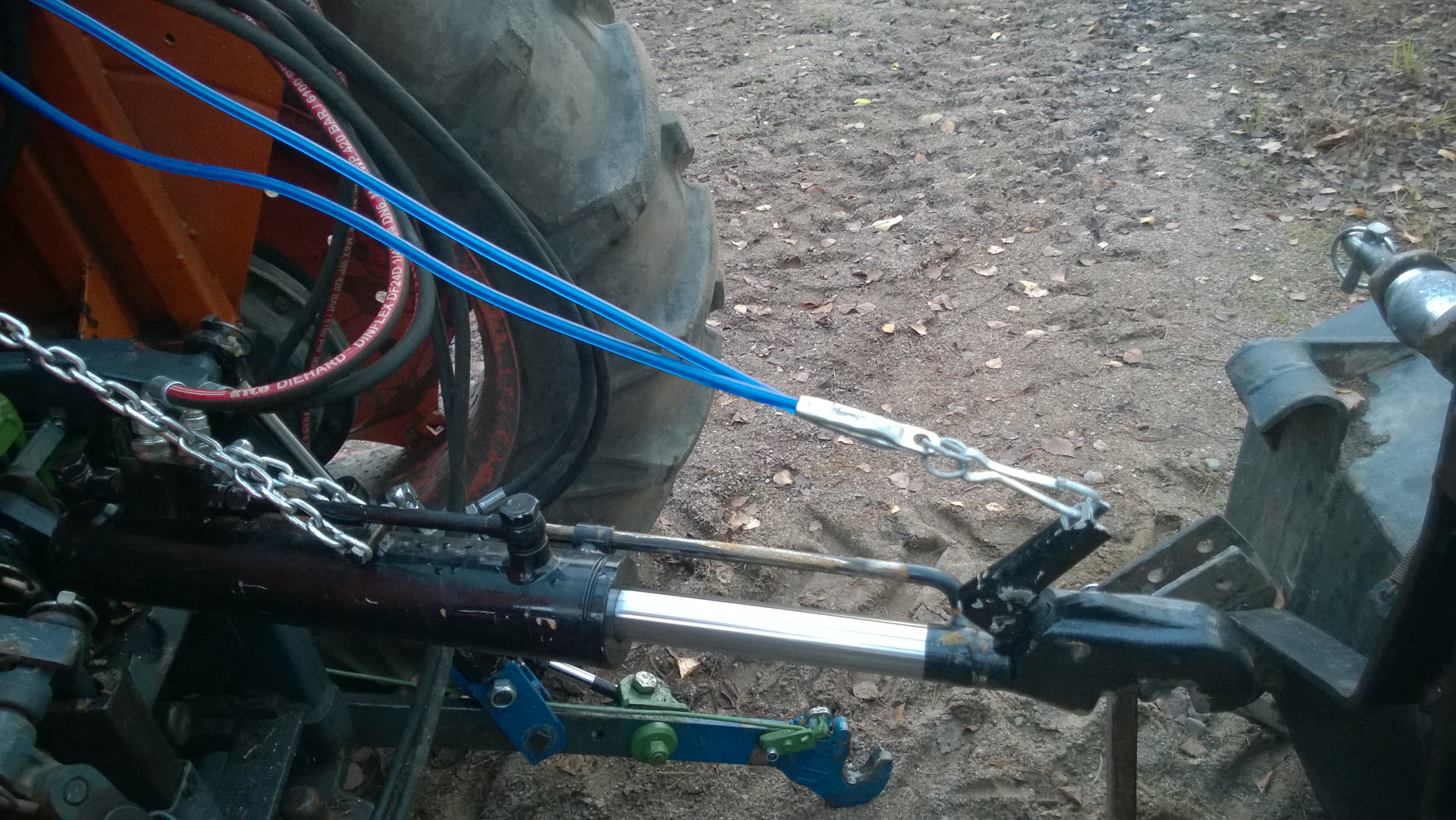

Euro hooks are flexible and can be used from the cabin.
In Europa they use these by ropes or go down to operate them.
Ropes are often broken at lower links.
Therefore I tried to to make more safe-
We need to go out of tractor only for PTO-shaft and hydraulic hoses
My Euro hooks:WP_20201018_037.jpg
Tractor weldable hooks and hook balls - YouTube
