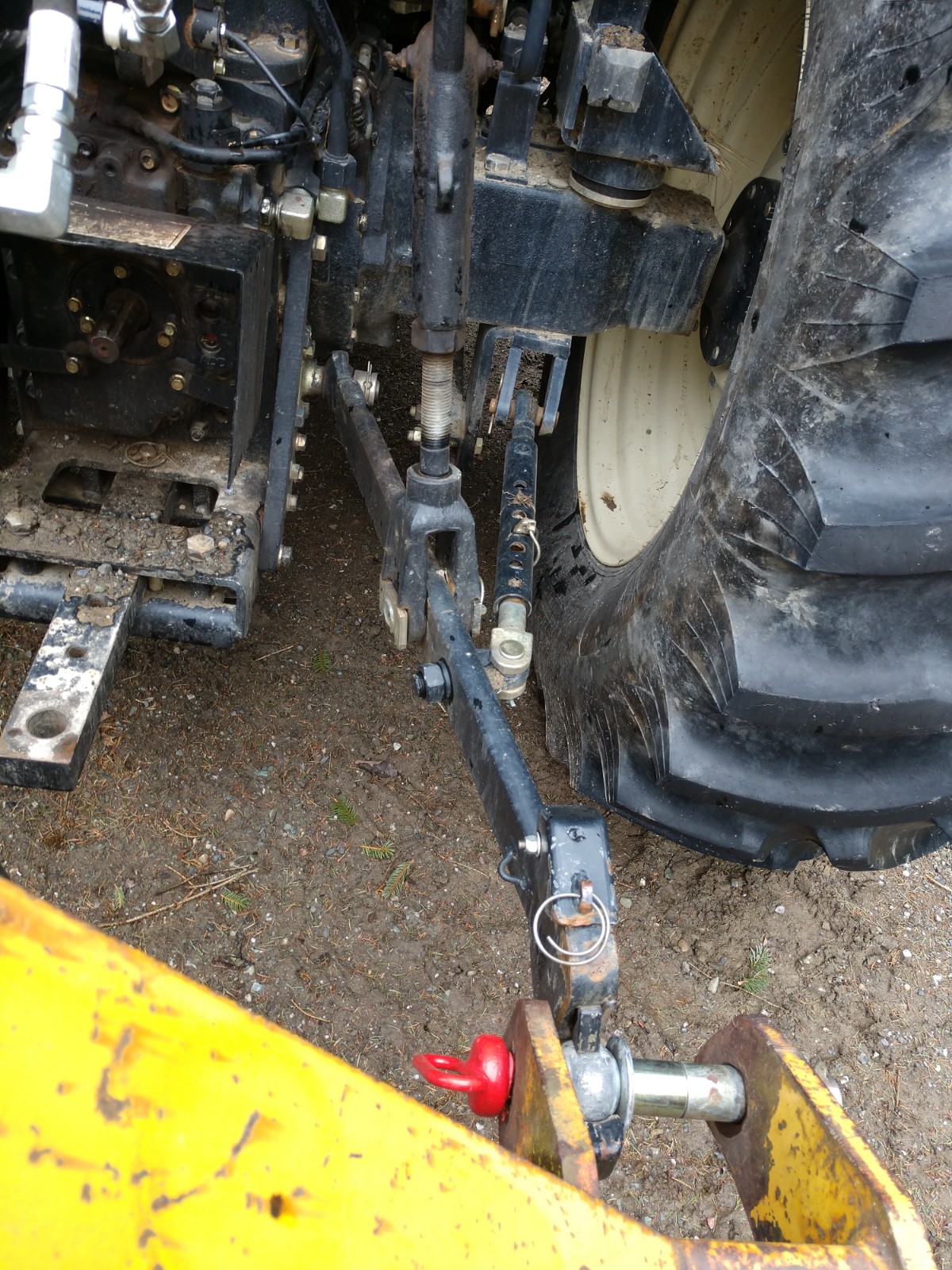

Remember as you have a PTO connection to make, you have to get off/out of tractor regardless.
One caution of Pat痴 or the QH type items, if you have already cut a PTO shaft, you may have to replace it as either style hitch will add distance between the tractor and implement (ask me how I know).
Actually, you can buy a PTO extender that cancels that 4" that quick hitches and Pat's add to the lift arms. You can get them for between $30 and $40 - way less than replacing a PTO shaft!
True while you can do so, they change the physics of that entire system and put greater leverage against the PTO stub and bearing.
So saving a few dollars may cost lots of dollars!

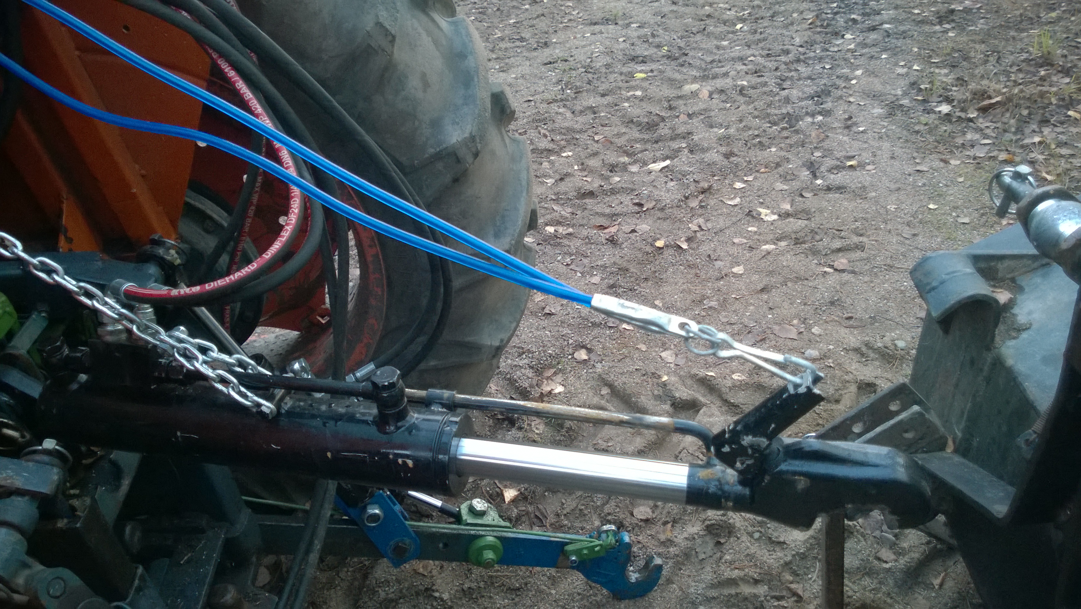

Euro hooks are flexible and can be used from the cabin.
In Europa they use these by ropes or go down to operate them.
Ropes are often broken at lower links.
Therefore I tried to to make more safe-
We need to go out of tractor only for PTO-shaft and hydraulic hoses
My Euro hooks:WP_20201018_037.jpg
