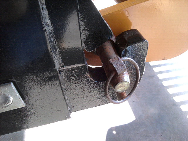

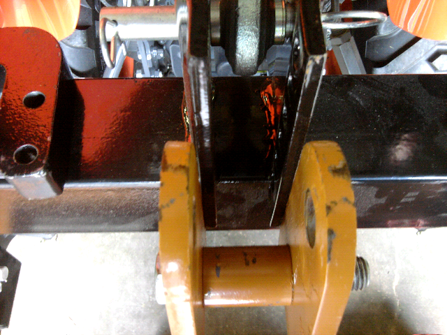

Well I got a quick hitch from harbor freight and was that a mistake. I read the owners manual online before I made the purchase. It said nothing about needing bushings for the lift arms which I am 99% sure I need (look at my pics and tell me for sure). From what I read a quick hitch goes from cat 1 to cat 3 on the lift arms and toplink. So I can make my own adaptors for the lift arms out of bushings from tsc. That part is not too bad. The toplink is where things get bad. I have a woods lr72 which is qh compatible. When you use a qh you use the bushing under the toplink pinhole, right? The hf qh toplink hook will not go all the way down into it even off of the qh. The next problems is I can only get one bolt to into the hook to come close to working. The bracket where the toplink hook goes is wide than the rake so it will not work. What do I need to do to get the toplink to work? Did they make the toplink hook wrong?

Yes you need bushings. Most of the HF models I've seen go to cat 2 but yours looks like it will take cat 3 bushings. Now on your top link does the hook go completely into the bushing? And also seem that the top hooks are not made to stick far enough out,

All QH require bushings. So that should be no big deal. Top hook is another story. Looks like the only way it would work is to weld a piece of metal to the back and drill holes for it to mount.
/ quick hitch problems
I got the top hook so it will fit the bushing. I guess I am going to have to make a adaptor for the tophook to set it back.

Where the hook bolts on is too wide to fit between the area where the toplink hooks. I am either going to make a adaptor or buy the adaptor to fit non qh compatible equipment.

I tried after grinding and it still would not work so I welded a piece to it. I was going to sandblast the hook but believe it or not the paint or powder coat is stuck to it pretty good. All I have to do is paint it. I want to get some pins instead of bolts so I can adjust it easily. I need to make a adapter or buy a adapter for non-qh compatible equipment. Some equipment I may be able to modify. Can someone post a pic of a bushing on their lift arm? I have heard of some people adding grab hooks to them. Are there any upgrades I should make to it before I paint the qh? Is there anything different about the i-match?
Here are the pics
Here is a crappy video of it in action (Click on it to play)

I like your fix. Good looking welds.

Good fix and as has already been said, "nice welds". This has been discussed before and there is a bit of agreement, "the lift pins need to be bushed up" and a bit of disagreement and that is what size to bush up to. Every cat one hitch I've messed with had Cat 2 size hooks. The bushings are simple, just get a lift arm bushing from cat 1 to cat 2 and put it on the lift pin, put your lynch pin in and leave it.
All of my equipment that I had originally outfitted with cat 1 pins are done that way, the newer stuff I simply put on cat 2 pins to start with. Some folks believe that a cat one QH uses cat 3 diameter hooks. I can't find anything that states that cat 3 is the correct size hook for a cat 1 hitch, If your does, well ok, none of my hitches do.
I think I may do to my top hook what you did to yours. I can hook to anything I have but some things would be a bit easier if the hook stuck out a bit farther. I'm gonna weld up the old holes tho' :)
