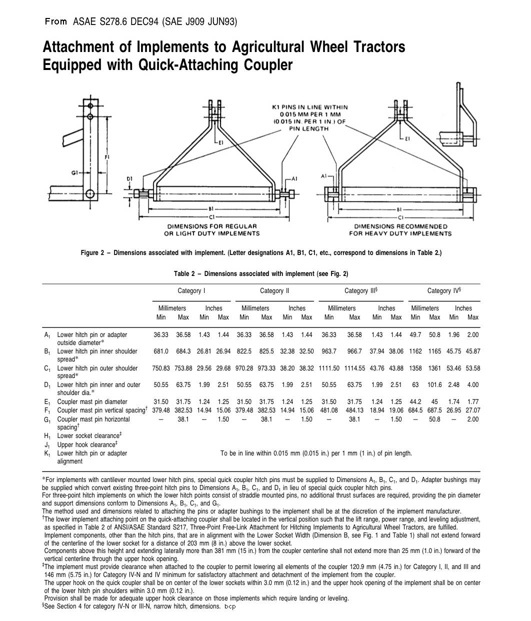

I think the standard was set up to allow use of convertible Cat I / Cat II implements. This is not a very common type of implement, but when the QH standard was developed, perhaps they thought that would be the normal approach in the future. Standards are meant to be as flexible as possible. If they had made it purely Cat I it would have limited use with non-specific implements.

A lot of people have had to modify the HF QH upper hook because the bolts interfere with upper link on implement, what is point of saving a few dollars for HF junk when you have to spend more money to get extended upper hook to fix interference problem.... As for sleeves and pins.... IT just part of the process.... Modify implement once to fit standard configuration of QH and be happy forever....
Also specification for CAT 1 QH includes this style sleeve on implement which HF probably does not include and IF your new QH does supply them you only get one set, and you need to order more for each implement...

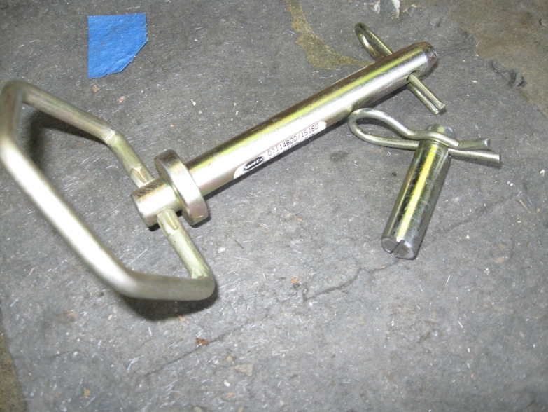

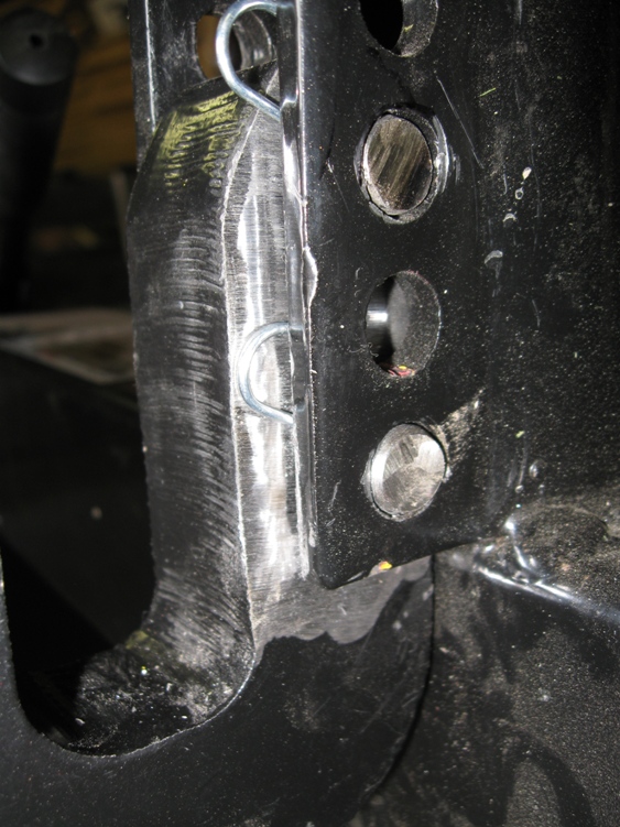

The upper hook clearance can be a problem with any hitch that has an adjustable (bolt on) upper hook. And some implements need the adjustable upper hook (my 3 point splitter was impractical to modify to standard QH dimenstions). My solution with my HF QH was to replace the bolts with flush pins, which I made from hitch pins. Other people have done similar modifications to avoid needing the extended hook.
   / Quick hitch, HF & RK #7
View attachment 649365 View attachment 649366

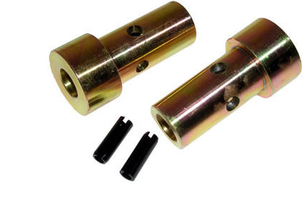

Years ago, the lower lift-arm hooks of the Harbor Freight QH were indeed sized to fit the 7/8" diameter Cat. 1 lift arm pins. My first HF QH is this way. Now, they are sized so they can accept the quick hitch bushing sets like these:
My other two, newer, HF QHs have the newer sizing.
