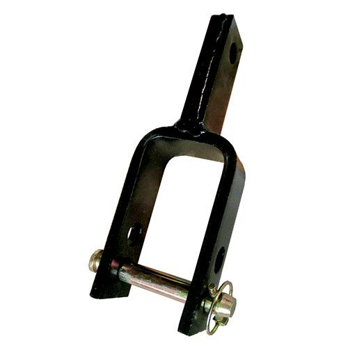

This is an internet photo of the type quick hitch adapter that came with the quick hitch.
This adapter is for quick hitch use on a mower that needs the top link connection to float. You will remove your top hook when using it.

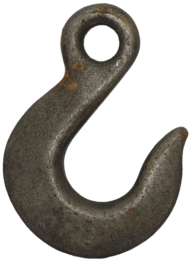

I have a cheap quick hitch and old equipment that isn't quite standard to any standard. The top hook that came with the piece didn't really work well and I tried the top link attachment but still had issues. I ended up taking a steel chain hook and attaching it to the top of the quick hitch with a bolt and then the hook part just flops over onto the implement and I can tighten the hook up if needed with the top link adjuster. Small tractor (Ford 2000) and light equipment and perhaps not as "quick" as a true quick hitch but it keeps me from fighting to make the mower and the tiller fit right.Chain-Slip-Hook.png
