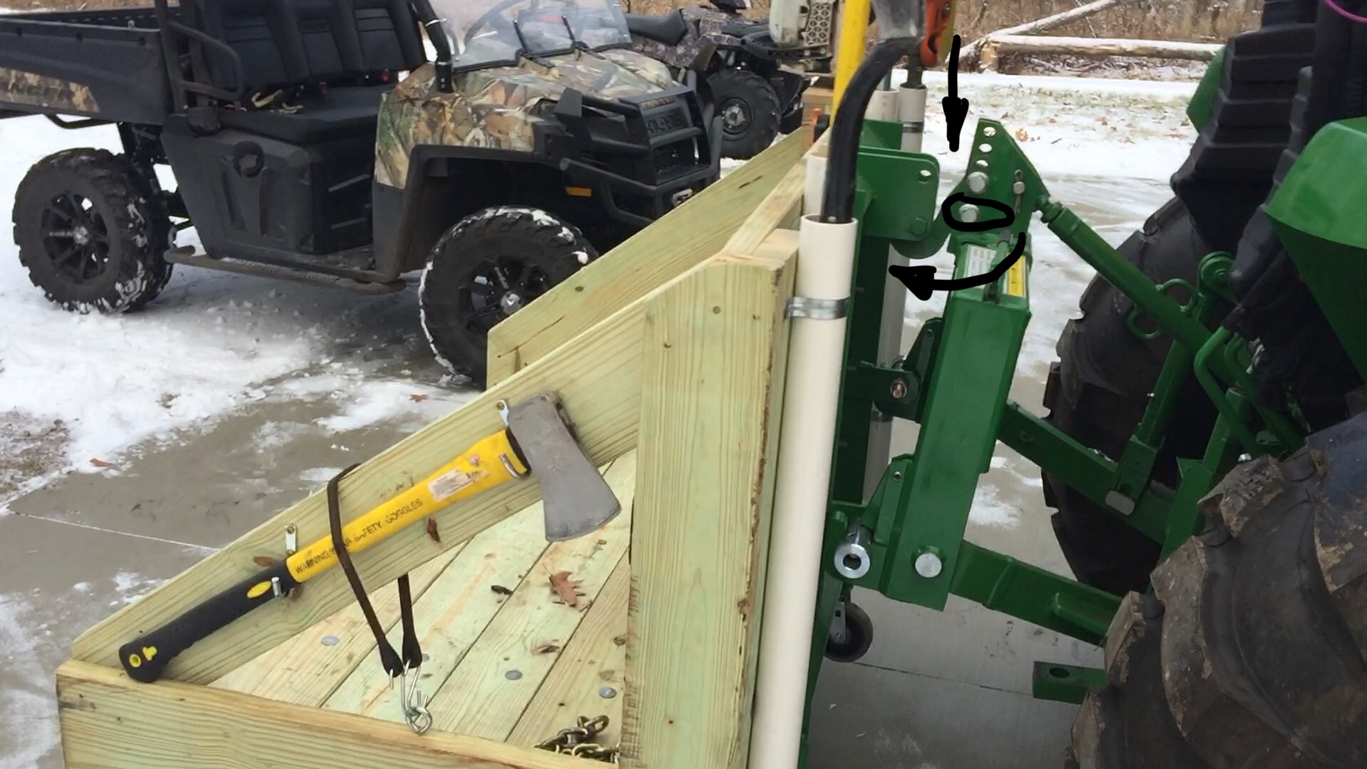

My $.02 about my quick hitch. I agree, the OP’s fit seems correct. I’ve been a quick hitch user for years, mostly with JD/Frontier equip. That all changed this year when I bought a Woods BB720x brush hog, which is advertised as quick hitch compatible. Struggled with that thing for awhile trying to get it to work. Finally modified it as shown in the attached pic. Essentially, there was not enough clearance on the Woods to allow the top hook to engage (in the area of the arrow pointing down). I cured it by slotting the bottom hole in the top hook and rotating the hook away from the frame in the direction of the arrow. For me, cured all my problems. My hitch now works with all my quick hitch implements.

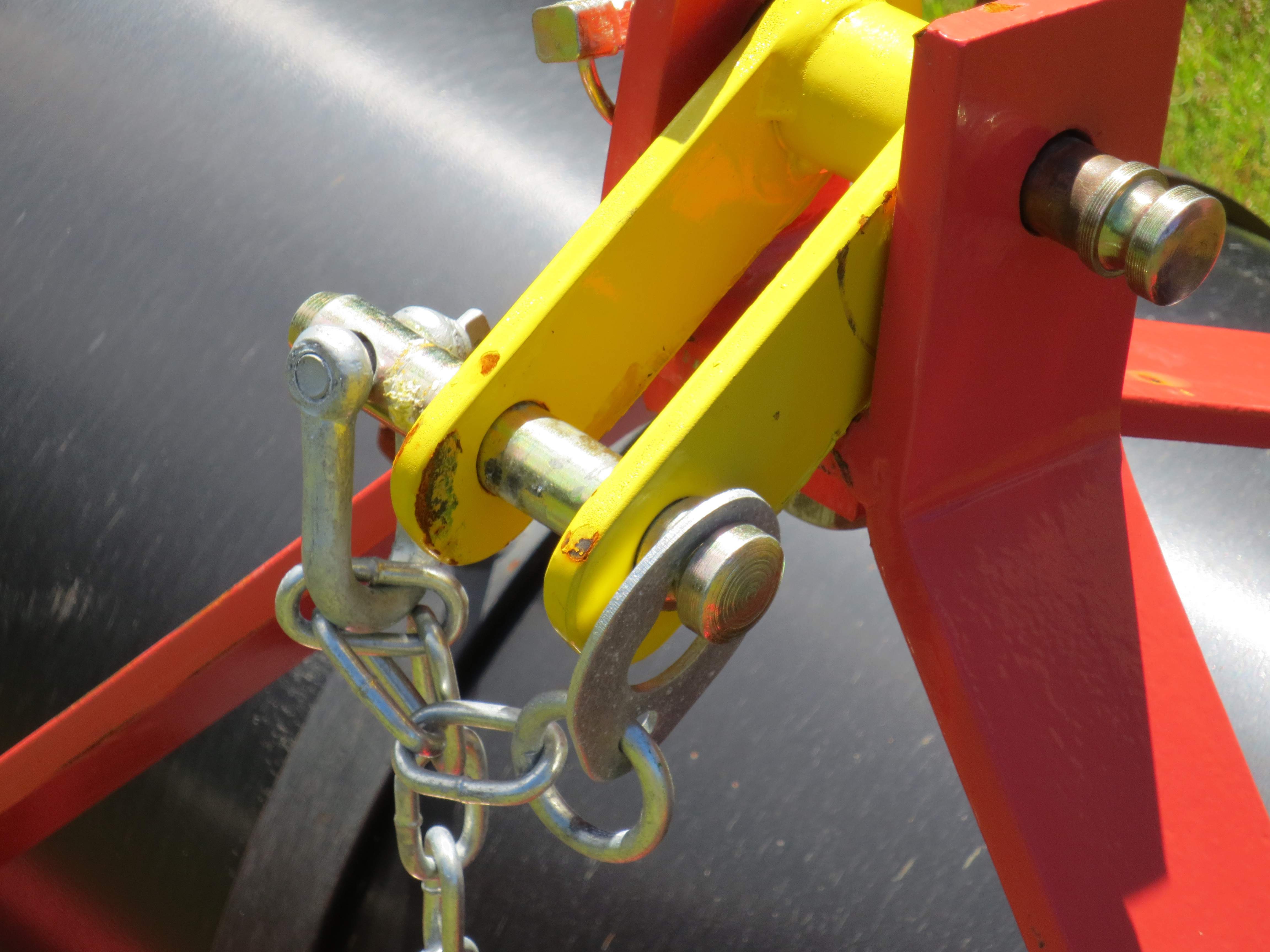

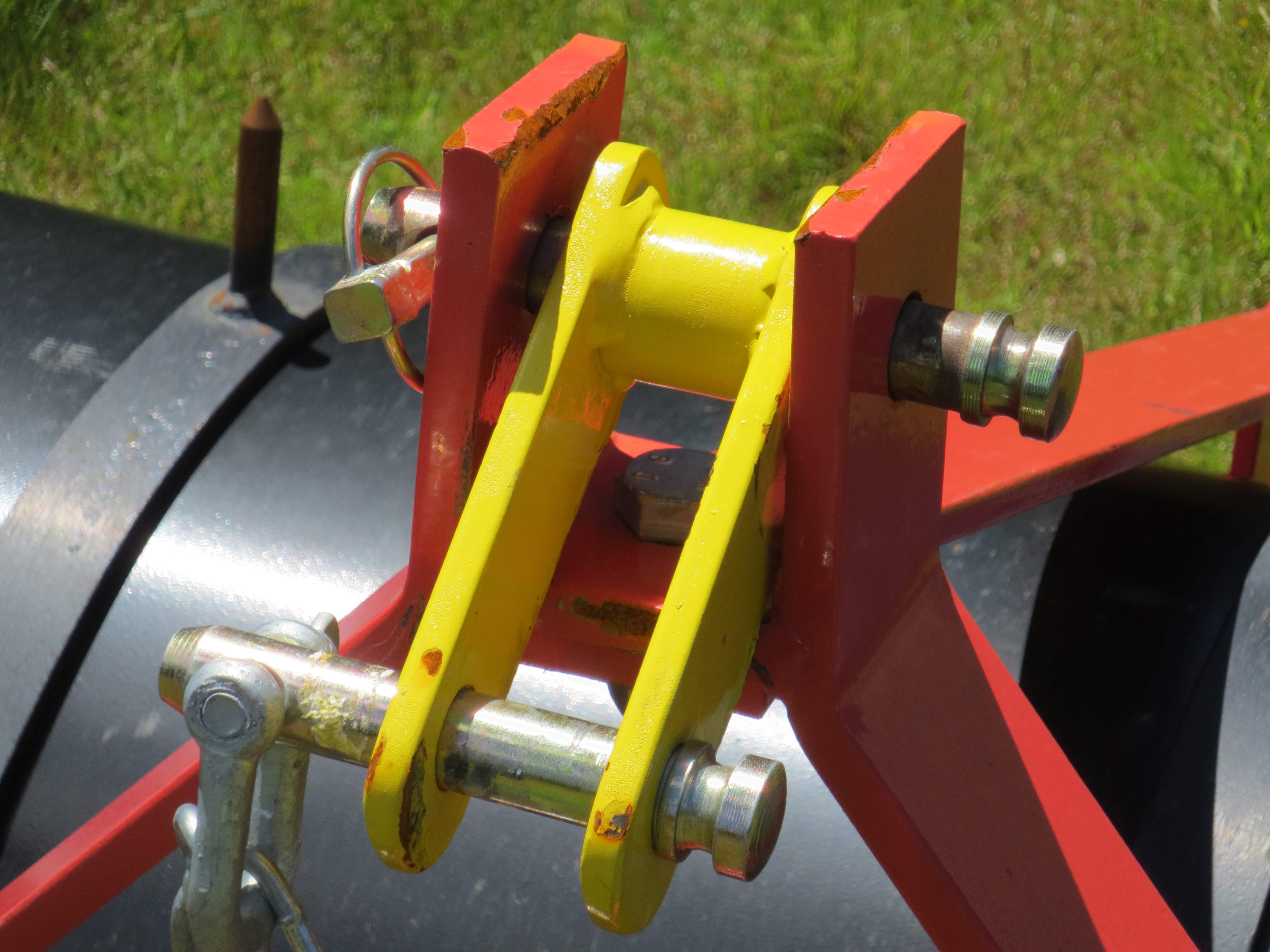

We're going to need a picture of your "top hitch adaptor" to know exactly what you're referring to. I have the JD iMatch QH on my tractor and the top hook isn't adjustable (it may be on newer models). I have a type of top hitch adaptor that I use on a few of my implements, though:

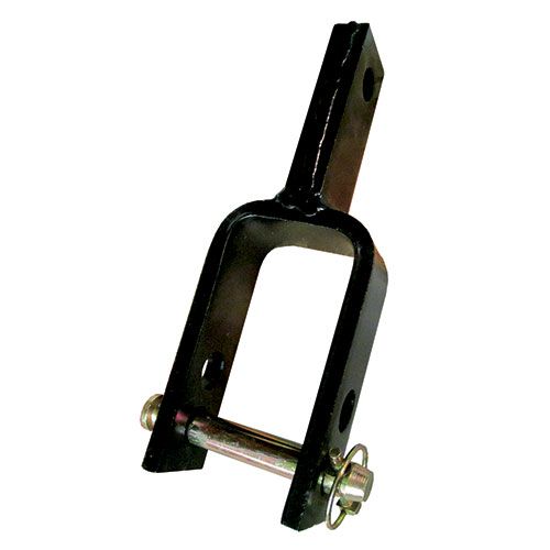

This is an internet photo of the type quick hitch adapter that came with the quick hitch.

The adapter allows you to use the QH on implements that might not have the correct top link height.
Ahh... so it's a variant of what I have.
It's used when the top hook of the QH won't fit into the top of the implement because the implement wasn't designed to be used with a QH.
You screw in/reduce the top angle of the 3PH so that the adaptor will fit into the QH hook. It can take a bit of fiddling to get it to sit in there. It's also why (in my example, above) I rigged a 'curb chain' that goes under the hook to ensure that it wouldn't pop out for any reason.
