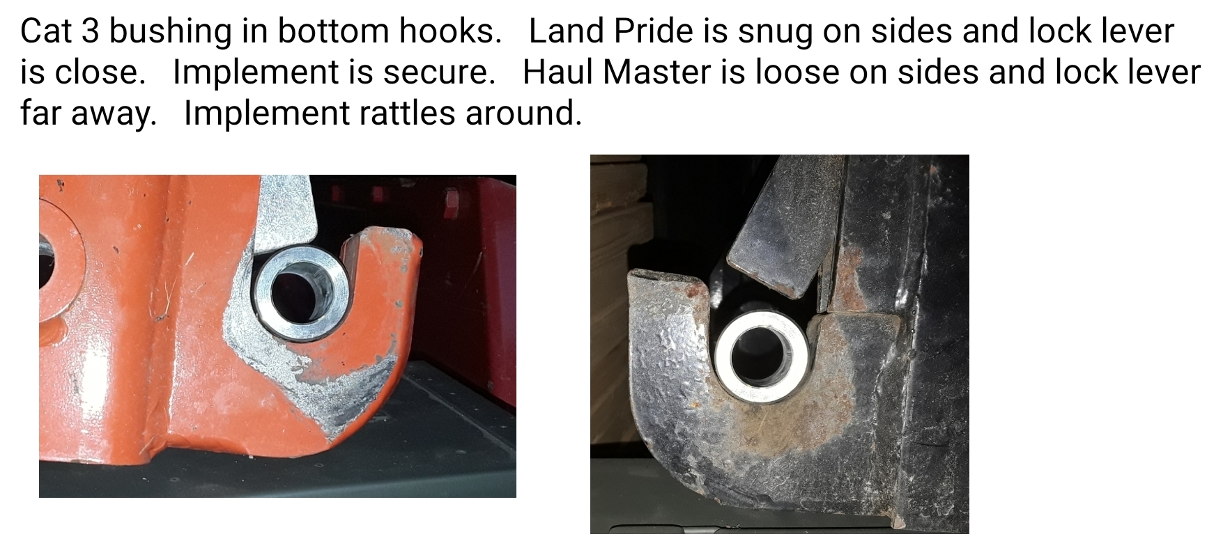

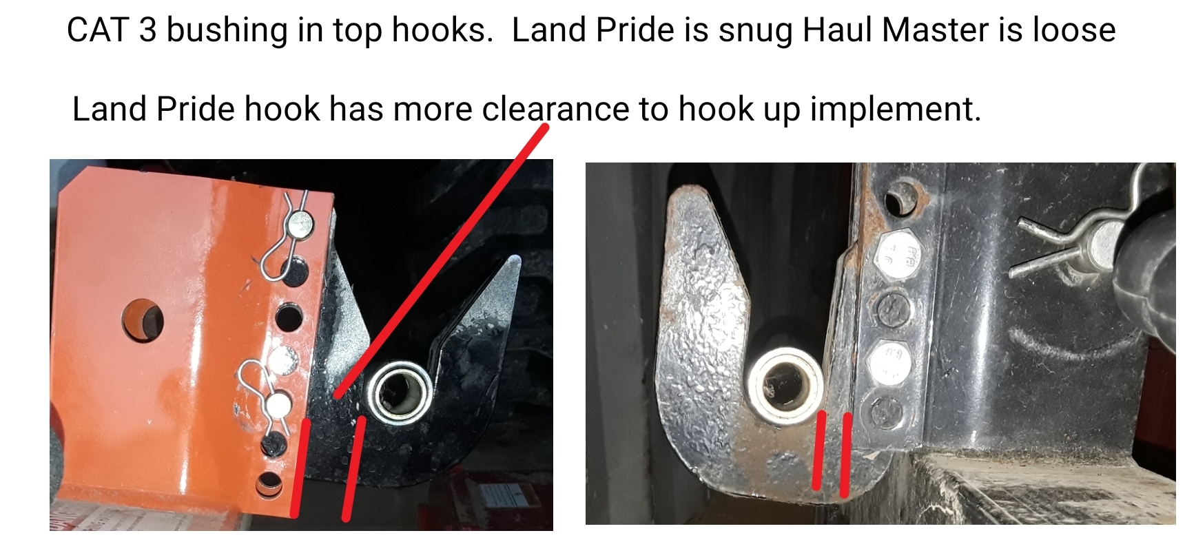

I bought a Haul Master quick hitch from Harbor Freight. It is probably the same Chinese hitch Rural king and others are selling. It is standard dimensions EXCEPT the top and bottom hook openings are slightly bigger openings. The locks on the bottom hooks also do not close near enough to the implement pins leaving a sizeable gap. A 3 pt rototiller will jump around in the hooks. The top hook also needs more clearance sticking out to fit some implements.
Since have switched to a Land Pride QH and it fits the implement pins much tighter and no jumping around. The implement bushings are Cat 3 size diameter on all Cat 1 quick hitchs if you want to check fit .

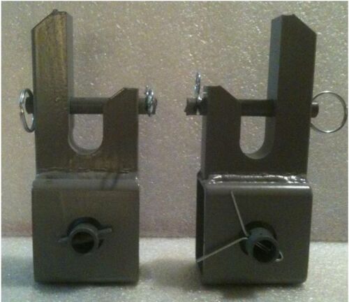

I had also bought the one from Harbor Freight.. The openings for pins are Cat 2 size... you need bushings to make Cat 1 pins fit... Returned it for that reason.
I have been using these which are similar to Pats... but do not extend the length of the bars like Pats does.. Been using them for years and like them but would like to go to
a regular quick hitch so I do not have to get off / on the tractor to put lock pins in and to attach the top link..
If you search e-Bay for "quick hitch" you will find them.
Hopefully someone bought the Rural King one and will provide measurements..

I think all standard Cat 1 quick hitches use Cat 3 size bushings. The standard is posted if you Google it. If using actual bushing and not the specialized adaptor you need a Cat 1 to 2 bushing slid into a Cat 2 to 3 bushing. The Haul Master hitch was a loose Cat 3 fit. The Land Pride QH15 fit the Cat 3 size snug.
I have seen the Rural King QH and it is identical in looks to the Chinese Haul Master and it will be Cat 3 pins. Hopefully the ones manufactured now fits tighter. Rural King also sells a Cat 2 quick hitch.
If you buy a Land Pride QH10 you don't need any pin adaptors for Cat 1 implement.
The Cat 1 quick hitches use Cat 3 size pins but keep Cat 1 dimensions.

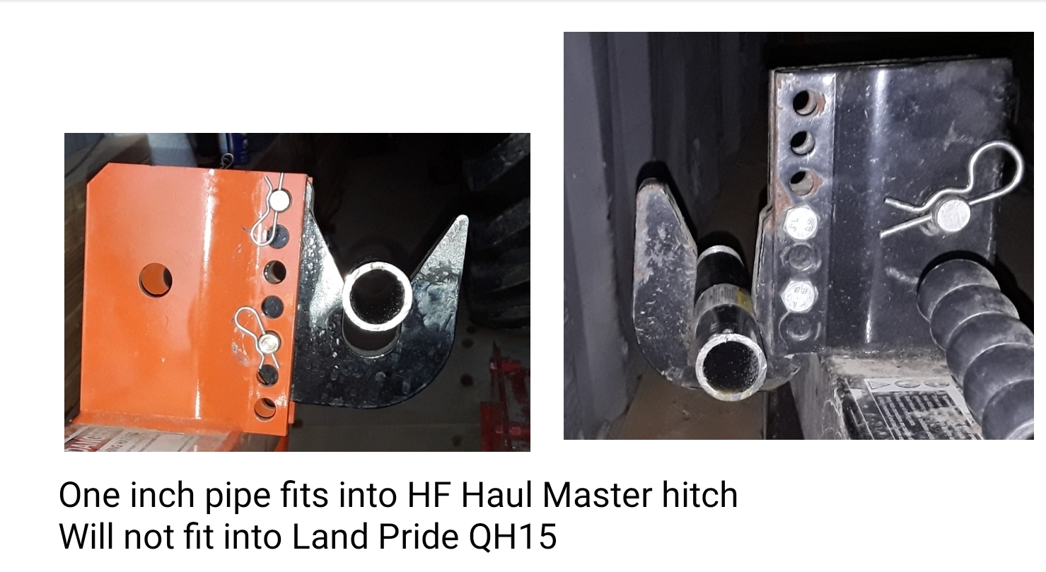

The funny thing about the video that recommended SPEECO cat 1 QH, actually violates the ISO standard for QH as all QH's from cat 1 to cat 3 use cat 3 pins by the standard...
As a side note, i Use a puce of 1 inch water pipe for sleeve on my small pin implements (7/8 pin) to bring them up to cat 3 specs... Yes I know not standard or probably not best material, but if works for low use implements...
