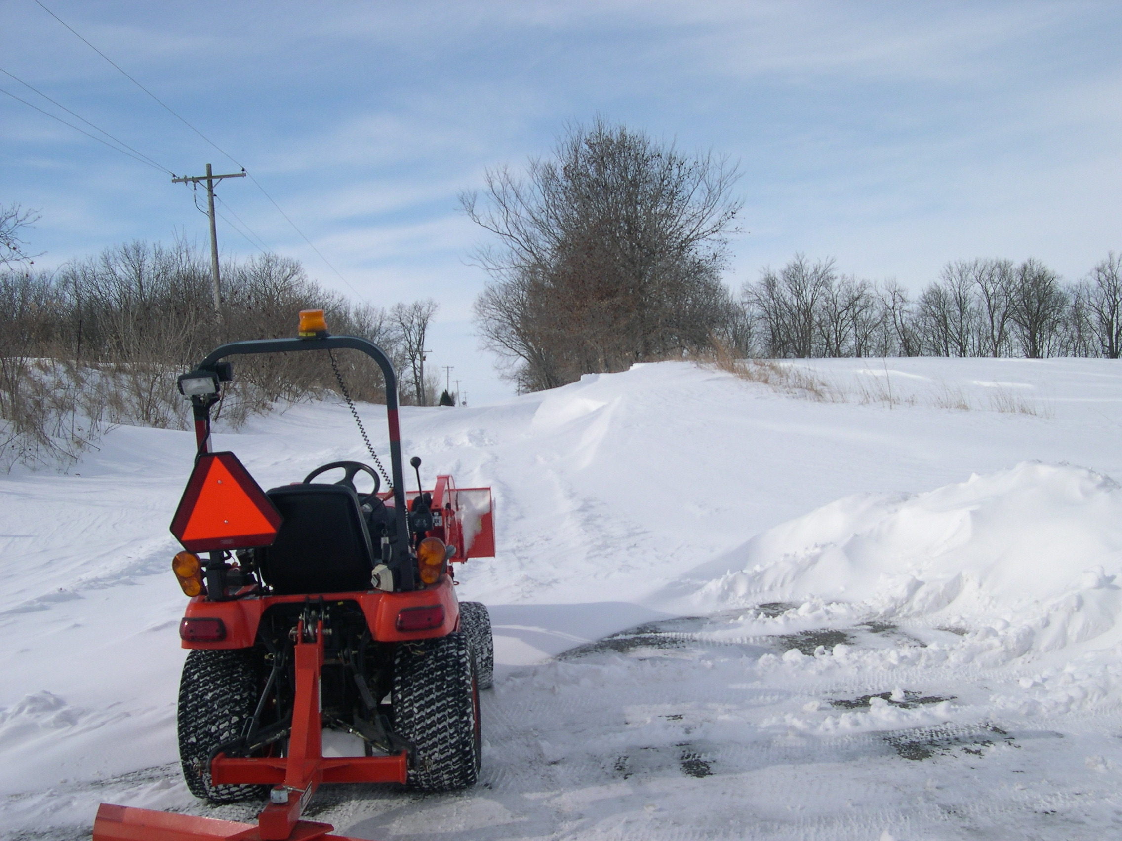

This pic from about 5 years ago was roughly a 20” snow, hard to say, lots of drifting. The drift up ahead of the tractor is about 6 feet deep. I did my driveway and the neighbors driveway using just the end loader, pic is my previous tractor. This is looking down the township road at about 1:00 pm. I didn’t know when or if they were going to clear the 1/4 mile to the county road. It took me several hours to clear it.
My point with the pic is the rear blade or any front blade is useless, there is no place to push the snow. A blower is the real tool to have if you get these kind of snows on a regular basis. We have lived here 24 years and it’s the only snow like this we have had.

Ya, I use my front blower every year to clear drifts. I blow them the direction wind is blowing so it doesn’t just blow right back over the road. With drifts, a tractor plow just doesn’t cut it. The plows attached to a large dump trucks can move them though.

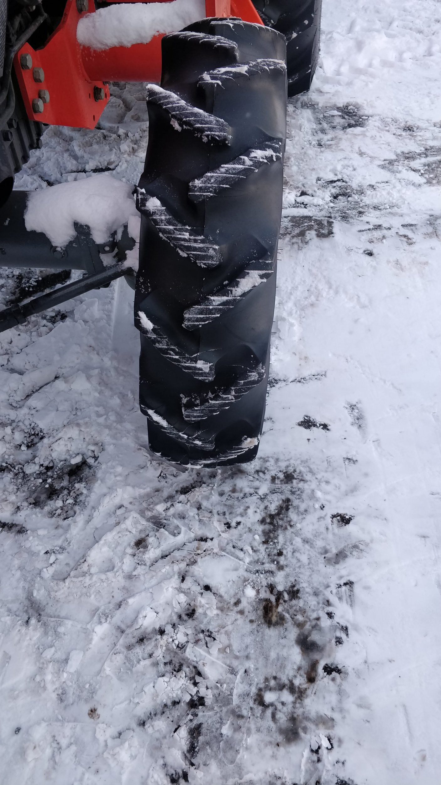

I will be the odd man out, I came from plowing with an atv, and 300 feet of gravel with hills. I put a set of edge tamers on the bucket, and i can push over a foot the entire length of one drive with pretty much 0 issue. I did groove my r4 tires and that helped a lot.

Have any pictures you can share of siped R1s
here you go. i made them about every 3/8" and about 3/8" deep (10mmx10mm for people happier with metric)
Did that help with lateral traction.
My issue is that when I'm pushing snow that the snow will push the front of the tractor left or right. Or when trying to make a tight corner that the fronts will slide to the side. Or when I'm going in across a slope I need to steer up the slope to go straight and the front will still slide down the hill. I've got no problem in the back because I use studded chains in the winter. I don't want to put chains on the front for fear of damage to the front axle, couldn't live without the 4WD in the winter now that I have a tractor that has it.
I put a couple of shallow grooves in my fronts running parallel to the sides of the tire trying to mimic some tread patterns I've seen, but this did not help much, if at all. Lugs on my tire do not appear as deep as yours from the photo.
I get a lot of ice and slippery conditions on hilly areas here and I have yet to find a solution to prevent the lateral slipping. It's something I've lived with for a long time, been here 26 years and have almost always had some type of tractor for moving snow. I've pretty much learned to deal with it and have only started to look for a solution since reading threads about grooving and sipping tires here on TBN.
There was another thread about Carlisle Vera Turfs that I followed but the person that tried them said they were still seeing the lateral slipping with them so not something I'm going to replace new tires to try at the cost to find out I'm no better off. Besides, I really like my R1s on my hills, I've seen all kinds of tires spin on damp ground going up the steepest parts of my property and only the AGs give me the traction I need.

This pic from about 5 years ago was roughly a 20” snow, hard to say, lots of drifting. ...
That's what it looks like around my house from about the second week of January through mid March every time it snows. Lot's of wind here. A snowblower is slow but anything less than the trucks the town uses isn't going to plow it. I have to pull the deepest parts of the drifts down with the bucket before I can blow the snow away. A lot better, some might even call it fun, now that I have something more suitable to the task. I would have gone bigger but wouldn't have anywhere to store something bigger.
