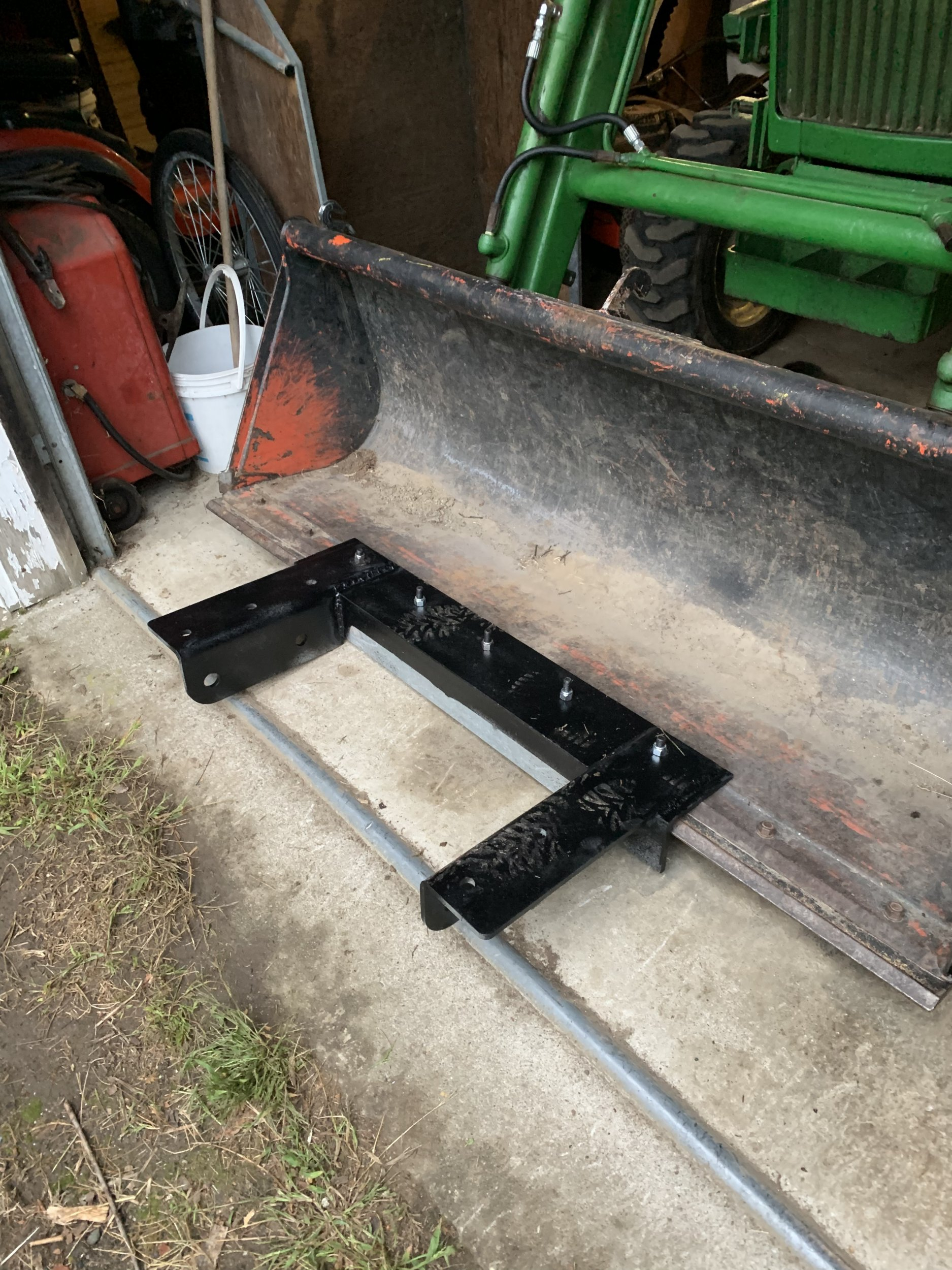

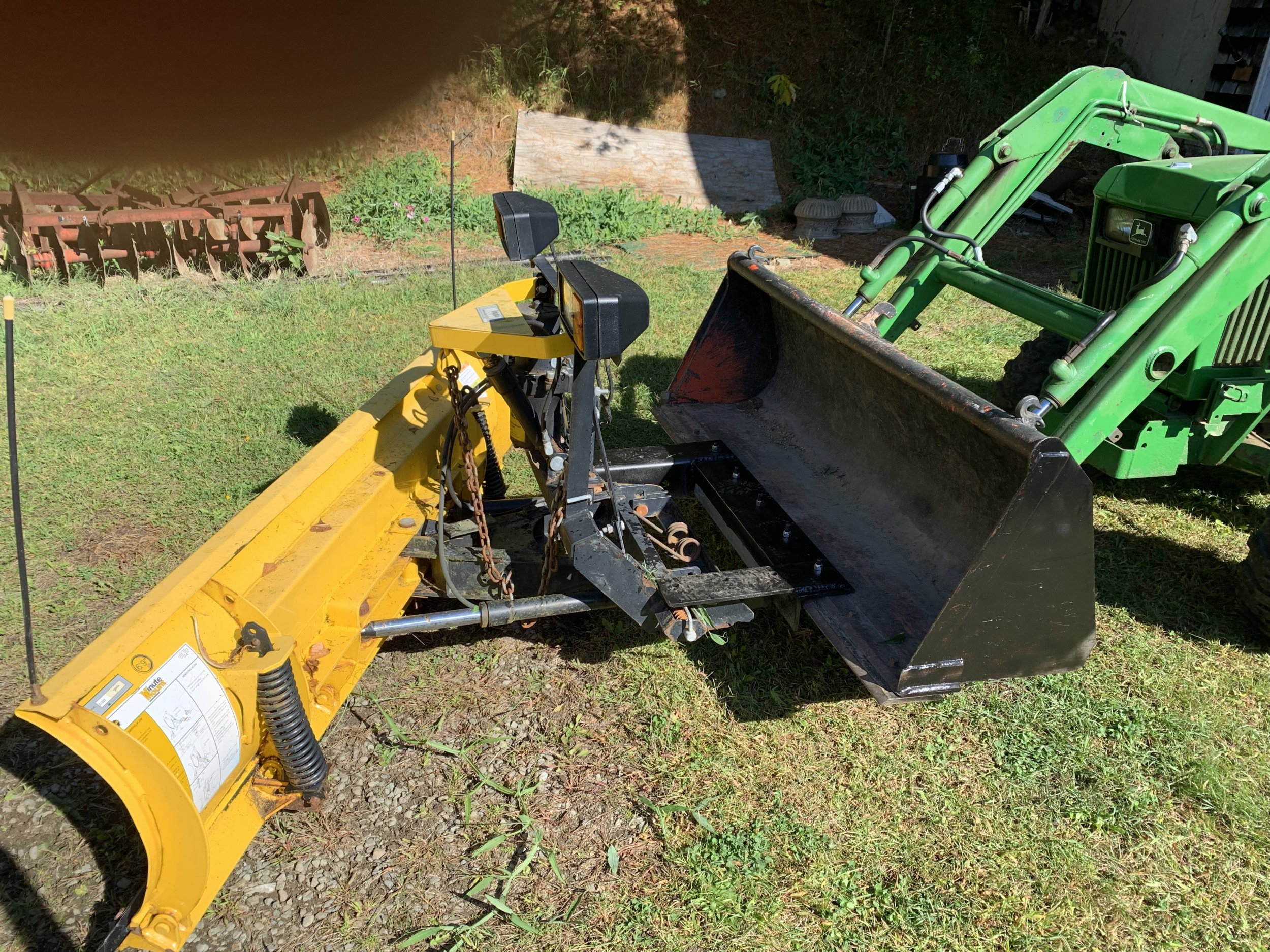

I made a bolt on plow frame for my bucket and a small truck plow. The plow pivots via the electric hydraulic pump.
