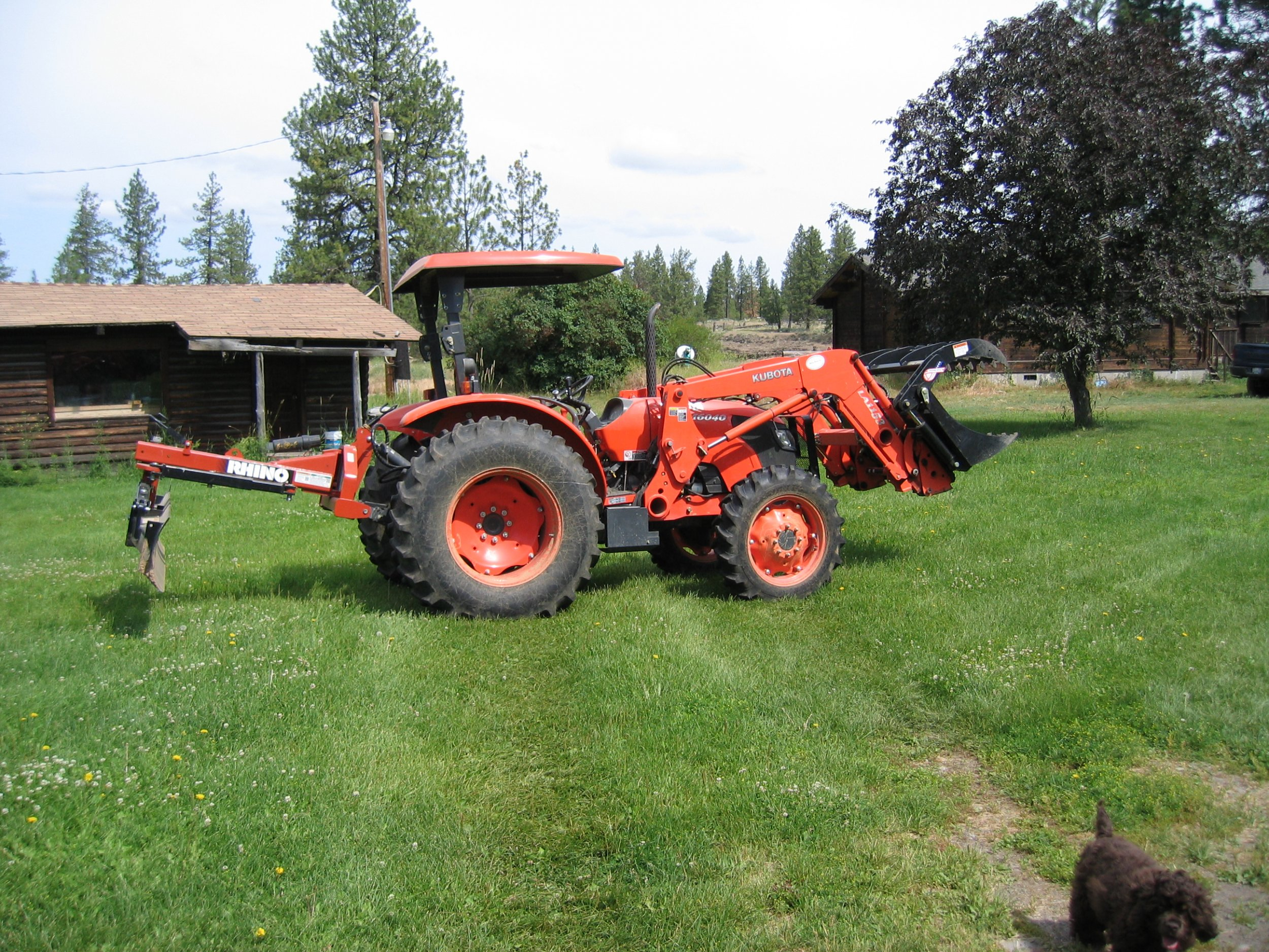

I have a heavy duty Rhino rear blade on my Kubota M6040. The tractor weighs 10,100# the way it's set up. The rear blade weighs - 1050#. I've never found that the bucket on my FEL is very efficient. It fills up - then you have to find somewhere to dump it. The rear blade curls the snow to the side and off the driveway.
If I have to plow the driveway and the driveway is still soft - reverse the rear blade 180 degrees and go like smoke and oakum. It will leave the gravel right where it is.
My driveway - a mile long, gravel, straight as an arrow. It goes right down a section line.
