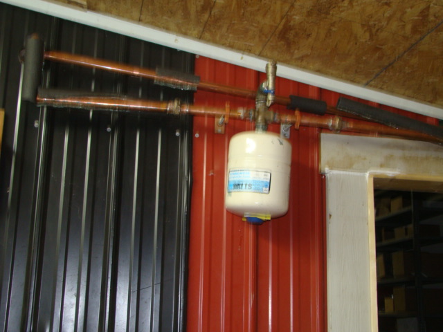

Install your expansion tank somewhere. It might be best on the top of the tank or on tee 1. You could put a second tee on the line running from your auto-fill to tee 1 and screw it on there. It also can be remote mounted but tied in at that point. That would put it on the suction side of the manifold pump which would tend to make the bubbles smaller in the manifold and make the pump deal with less air.

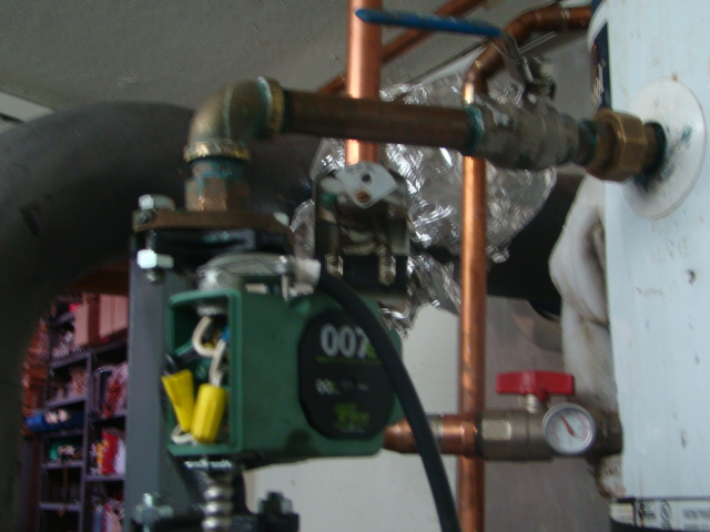

Oh I wasn't planning on using that burner control I was just wondering if it would work. But the circulator and burner terminals are set up for line voltage. It does have a relay that switches to 24v but that is for the thermostat side of the control. When I was thinking about trying to use this control I was thinking about using an aqua stat rather than a thermostat to operate the control. Then I found this other high limit aqua stat I had on a shelf and decided to use it instead. I run into this a lot when I am doing projects using pieces and parts that I have on hand.
I have the aqua stat on the HX about dialed in. It cuts on the HX pump to the tank at 160 and off at 140. I've been watching it for a couple days now through many cycles and it seems pretty consistant. I may have to bump it up to around 180/160 once I get the wire run for the other pump and aqua stat for the loops on the other side but we'll see how it goes once I get this other tee installed so I can get the air out. It's been running a couple days now and I can tell that it has gotten rid of a lot of the air by itself. The pump sounds happier but I can still hear water rattling around the manifold supply lines at times. Oh and that 3/4 line I added between the supply and return at the manifold seems to be working nicely as I can feel it mixing the hot water with the colder return water by feeling the return pipe. Thanks for taking time to help me work this out. I took some pics yesterday when I was out in the shop but I have been too lazy to go back out there to get my camera so I can post them this morning. Hopefully I'll get over that half a chocolate pie I ate for breakfast this morning so I can get going soon because I still have two and a half pies to go before they are all gone. :dance1:

Here are some new pics I took yesterday hopefully you can tell whats going on.

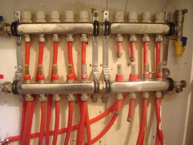

From the pix I can't see how the manifold pump connects to the manifold. It is pumping down and I'm assuming it feeds the bottom row with the flow meters. Are the white caps on the upper section all unscrewed as far as possible?
Is the system actually delivering heat to all the loops?

Yes they are fully open and yes when the pump is running I can feel hot water in each loop going into the floor.
Yesterday I finally got everything wired up and both aqua stats are now operating both pumps. I'm going to have to mess with it for awhile to find the sweet spot for both pumps. I also have to do some tweeking on the stove itself and figure out some draft control system and I may also put some kind of insulated shield around part of the stove to try and keep some of the radiated heat inside where it's needed. I would like to keep some of the heat that it puts out to help heat the back part of the shop where there are no loops but don't need all that it putting out.

Oh, and I forgot to mention that it seems that the little red disk are finally moving from the top of the glass in the flow meters. The disk are not showing much flow all seem to be showing around .2 gpm but I can see water in the glass tubes now and it's at a level about 1.0 gpm. I can open and close the restrictors on the upper manifold and watch the disk and the water level rise and lower as I open and close them.
I bought a couple new flow meters from pex universe and they are not like the ones that came with the manifolds. I went to replace one of the old ones but they didn't want to screw down into the manifold. They started but seemed really tight so I stopped and put the old one back on. I'm going to check with them tomorrow and find out if I got the right ones.
   / Questions about radiant heat system #98
mx,
You really don't need the flow meters. They are fun to look at and do give you an initial indication of what's going on, but the real adjusting should be done with temperature on the return lines just before they enter the return manifold. Grip each one with a couple of fingers and thumb. Remember that temp and go to the next one. With all of the adjusters open, find the warmest ones and turn them down a bit until, after some time, they all feel about even.
If you are not feeling much warmth on these lines, you should get a higher head pump.
