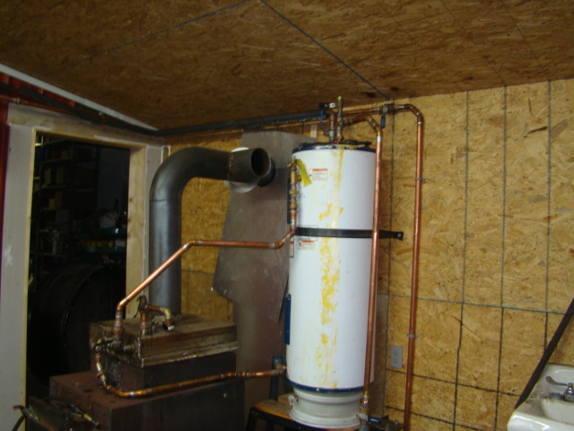

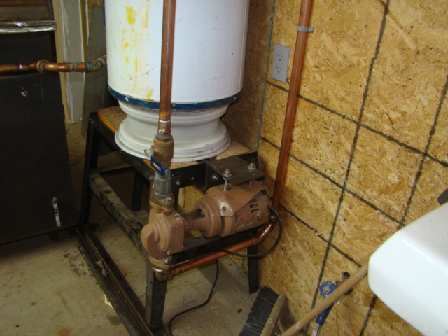

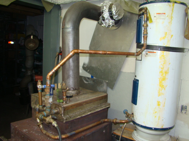

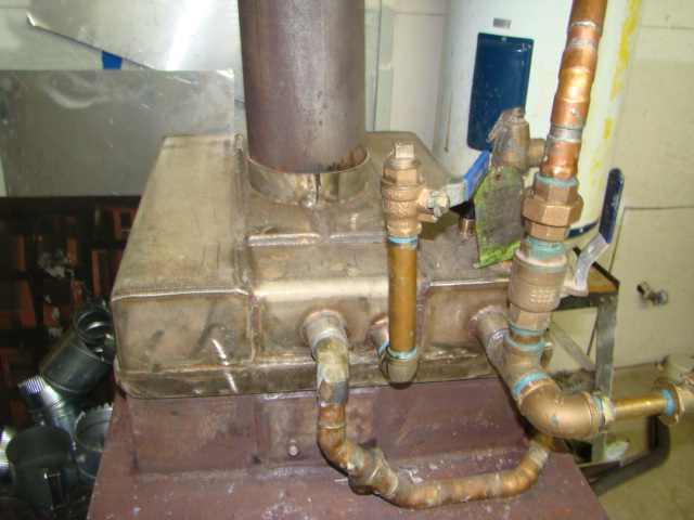

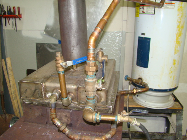

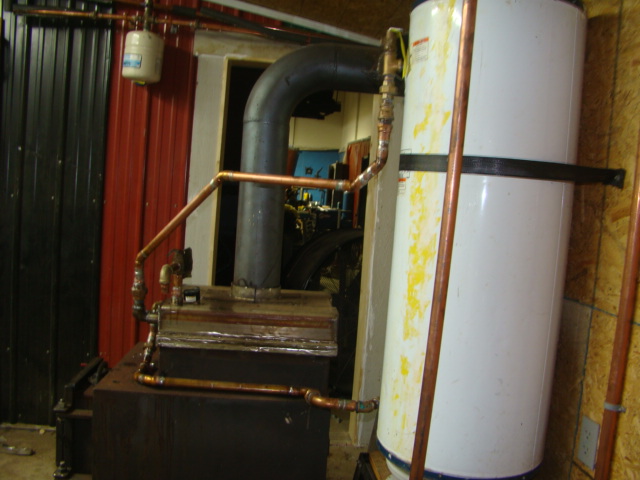

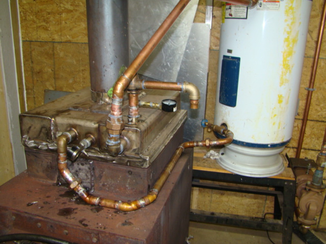

I've been playing around with different ways to heat my shop for several years now and have almost got it to where it is doing ok but would like to do a few things that would make it better.

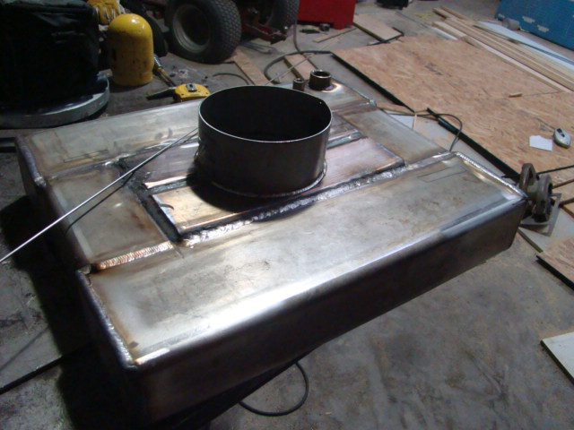

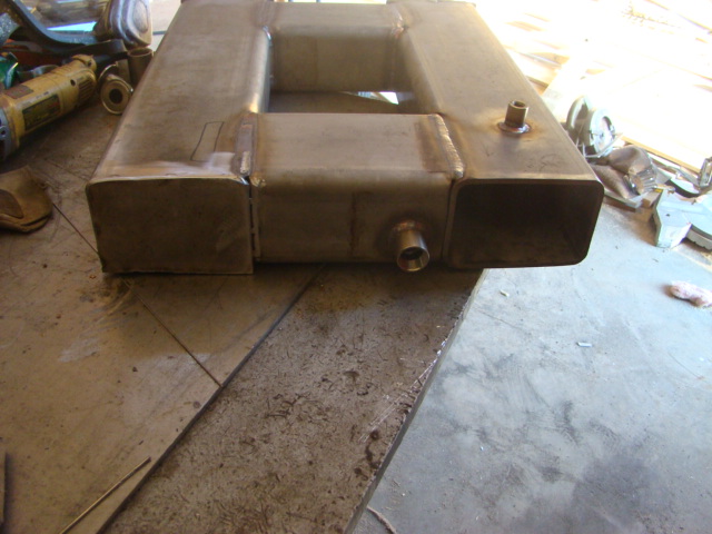

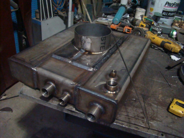

What I have is a wood stove with a ss tank attached to the top of the stove with the exhaust going out through the center of the tank. The water goes in one end and travels around the sections and out the other end. As the water heats up and leaves the SS tank it rises up a section of 1" copper pipe to a 35 gal water heater. This heated water dumps into the top side port where the pop off valve was and then back to the stove through the old bottom drain port of the hot water heater.
Normally when I start the stove up cold I cut off my circulation pump that I have stationed at my manifold which is connected to this storage tank by roughly 80' of 1" copper pipe. I let the natural rise and fall of the heated and colder water circulate from the stove to the water tank until it heats up the tank to around 120 to 130 degrees. By this time there is hot water already going out of the top hot water port and into the supply line headed to the manifold.
I have a small pressure tank that is plumbed in the supply line about 15' from this hot water outlet port and once I feel hot water leaving the pressure tank I then turn on my pump. Normally when I turn on the pump the water temp leaving the stove has gotten to between 140 and 150 degrees. Once the pump is turned on the water stabilizes in the storage tank to around 120 degrees and stays there as long as I keep the fire going. I keep the fire going all through the day by adding a few pieces of wood every hour or so and at night when I go in I bank it full and cut the draft down low so it don't burn out to quickly. I will normally have a few coals in the bottom in the morning and I can still feel heat on the sides of the stove but the water has cooled down to where I started the day before.
I got through last season like this and even on the coldest days and nights the shop was fairly comfy. I have a couple more tanks I have come across this summer and I want to add one, maybe both to the system for more storage.My question is what would be better.....to run this extra tank in series with the pipping or run it parallel to the tank like it is at the stove? The supply run to the point where I will tie to the pipping to the second tank is about 9 feet off the floor and the bottom of the second tank will be about a foot higher that that.
My thinking is if I 'T' off the hot line to the hot side port on the tank and then 'T' off the cold pipe returning to the stove it would act more as a mixing valve so to speak than a storage tank. I was thinking of trying it this way to see what would happen but thought about asking about it before I ran all that pipe.

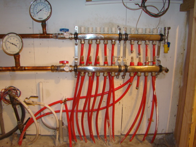

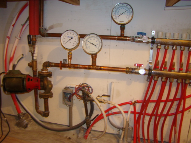

The biggest problem I have is that even dumping 110 degree water in the slab the return is always to cold when it gets back to the stove and this causes problems with creosote build up. I have to rod out the stove pipe every couple days to keep the keep it drawing.
As it is now I'm dumping roughly 100 degree water into the manifold, that is connected to roughly 2000 ft of 1/2" pex and by the time it leaves the return manifold it is cold or around 50 degrees. After a couple days of keeping a good fire all day The center sections of the shop floor will warm up 65 degrees in places and cool off as it gets to the outside walls where they stay on average around 50 to 55 degrees.

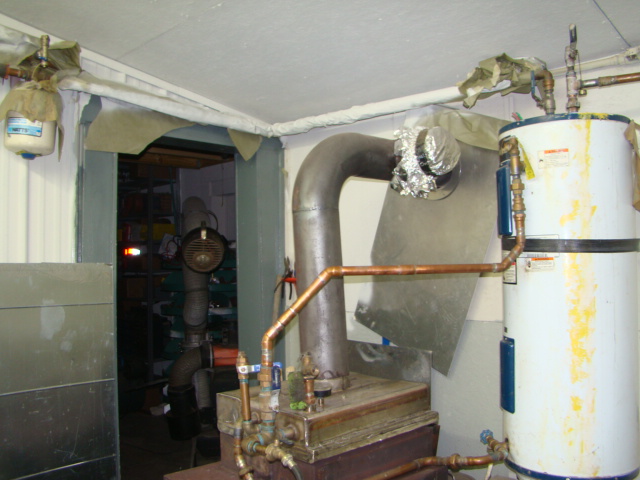

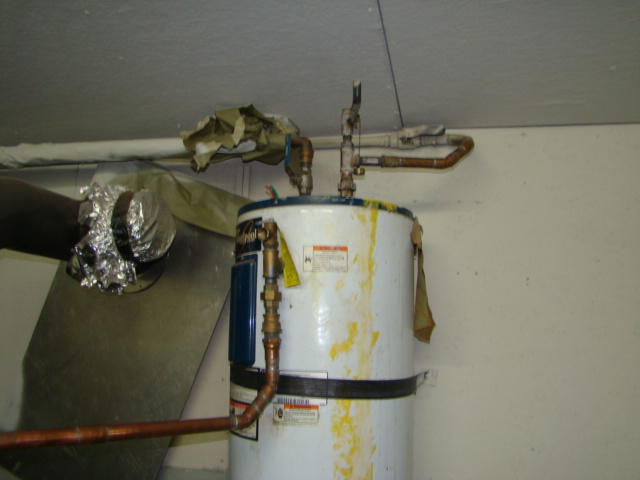

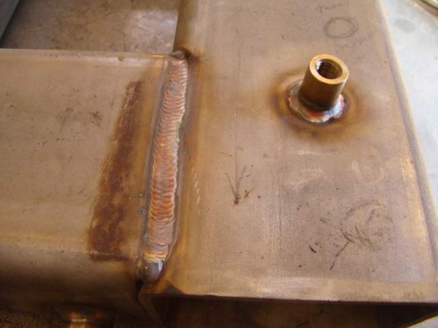

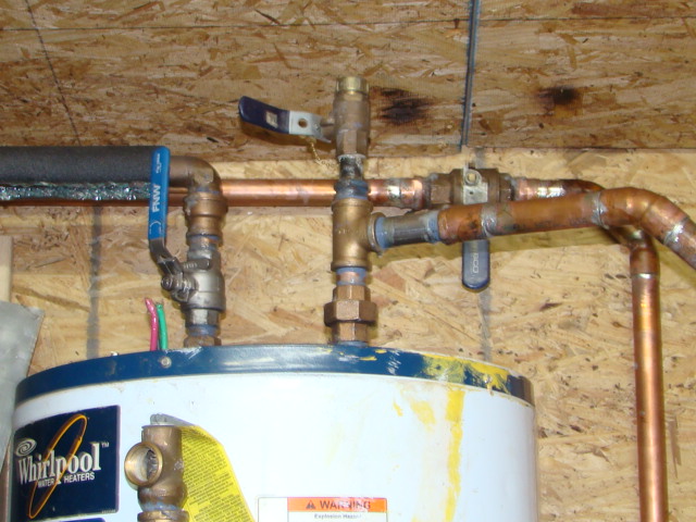

I found a few pics that I took while I was putting this together and maybe they will make things a little clearer. DSC03829.JPGDSC03833.JPGDSC03832.JPGDSC03831.JPGDSC03835.JPG

/ Questions about radiant heat system #8

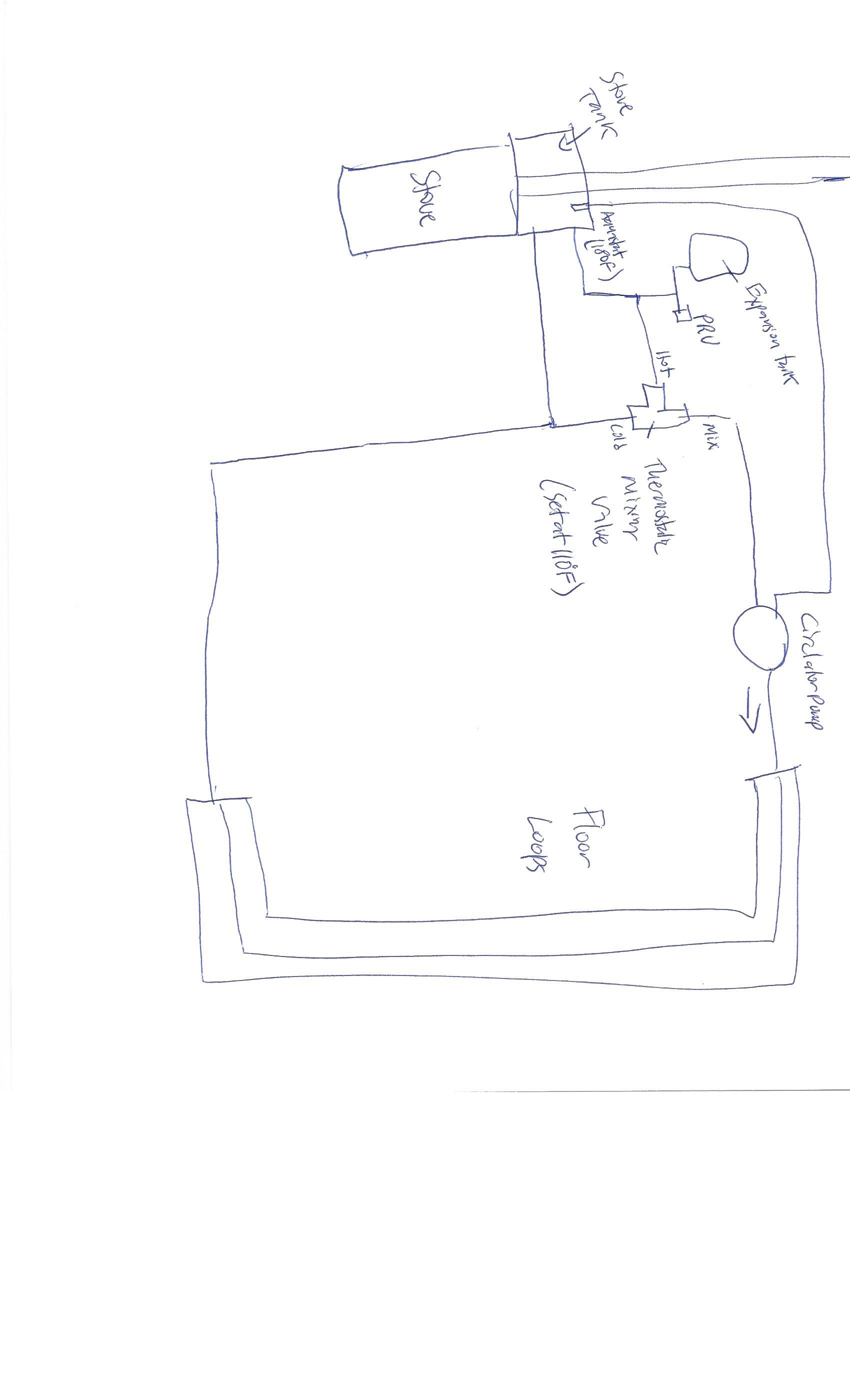

I'm trying to be helpful here, and I read through all of your posts again, but I just don't see how having more water in the system helps. It looks like you've got a very good system and a simple change would make it work really well.
For the tank on the stove, you want it to quickly heat up and then hold its temperature. You want as little water as possible without causing big swings in temperature (boiling when the circulator turns off, rapid drops when the circulator comes on).
For the floor loop, you want just enough water to fill the tubing, any more and it just means waiting for the heat to take effect.
If you want to store heat, my recommendation is to heat the slab as much as possible and store the heat there. If you heat the slab to the point that it's uncomfortable to walk on, and the shop is still cold the next morning, then we can talk about other ways of storing heat.
You already have a circulator pump. I would add a thermostatic mixing valve Google and aGoogle. This will cost about $200 for the parts but will give you a really good system.
The aquastat connects to the stove tank, and the electric leads go to the circulator pump. Put the mixing valve so the valve output goes on the intake side of the circulator. The hot input to the valve goes to the output of the stove tank. The cold input to the valve connects to a tee, which connects the return to the stove tank and the return from the floor loops. I would start off with the aquastat at 160F and the mixing valve at 110F and then adjust.
When you start off, everything is cold, the aquastat is off so the circulator is off. The stove tank water won't circulate. As your fire warms, the stove tank water starts to warm. When it hits the set point of the aquastat, the circulator turns on, and the circulator starts water through the mixing valve. The thermostat in the mixing valve adjusts the portion coming from the stove and the portion coming from the return loop to keep the water at 110F. Whatever water is pulled out of the stove tank is replaced by water coming out of the loop return.
Once it starts running, look at how it runs and make adjustments. If the circulator stops and starts a lot, it means you're pulling more heat than the stove can provide. You want to get to the point where the circulator is cycling occasionally, that's the point where you're pulling the maximum heat your fire can support. Adjust the temperature on the mixing valve until either the circulator starts kicking off, or the floor gets uncomfortably hot.
If you get to the point where the floor is uncomfortably hot in spots but you still want more heat, a bigger circulator will pull more water and more heat.
If you get to the point where the water coming back from the slab isn't cold, then your limiting factor is the ability of the slab to absorb and radiate heat. This is where you can start talking about storing heat. Although I think your best way to store heat is to warm the building, so what I would look into is additional radiator capacity.
You also want to adjust the aquastat to the point where you don't get creosote buildup. That's probably trial and error.

Thanks I do understand what you are saying now. I have known all along that I would sooner or later have to add some controls other than just let the pump run all the time. I was just thinking that if during the day I could heat up three tanks of 160+ water the put a mixing valve between the last one and the manifold and send 90 to 100 degree water to the slab then by the time I get through the day with a hot burn and bank it for the night I would have at least warm water in the morning.
I think I may replace that 30 gal tank at the stove with that 50 gal tank I have and install my mixing valve into the system and see how it works. One question though, which end of the system would you add the mixing valve. Adding it to either end will require sending hot supply water to the manifold or sending the tempered return water through the long pipe runs between the two parts of the system.
Oh, and the mixing valve I want to use is a Leonard part no. 20470 {from a red tag attached the the valve} There is also a tag on the valve the says TM1513892 if that helps.

I know it may sound strange but my heater can make water that is too hot to dump directly into the slab. I don't know for sure what the ideal temp is that can be added to a floor but I have heard and read that you probably shouldn't dump water in a slab much hotter than 110/120 degrees max. With a wood stove it's hard to maintain a clean burn and keep water temps that low. I wanted a simple system with as few moving parts as possible and at this point I'm getting close I just need to fine tune a few things to where I can maintain a fire hot enough to burn clean but also do it as safe as possible.
You're asking the storage tank to do the job that a thermostatic mixing valve will do better -- it will keep your stove hotter and your floor loops more stable. And you already have the valve -- I googled the part number you listed, I couldn't find that one but the TM series stands for "thermostatic mixer" which is exactly what you want. It may not be quite right -- the flow rating or the temperature setting may not be suitable -- but it's the right kind of part. You can get the proper one for around a $100 anyway.
The story with floor temperature is that you want your water to be as hot as possible without creating uncomfortable spots. A floor doesn't have to be much above body temperature to be uncomfortable to stand on. The hotter the water the more heat you can put into your space and the better the system is overall, so you want it as hot as you can stand. This will be set by the mixing valve, and you will set it by trial and error. (Which is another reason to use a mixing valve).
Here is a (very) crude drawing that shows the way I think it should be plumbed:
The only part you don't already have is the aquastat, which is going to cost around $100. I recall that in an earlier post you said you've got 2000 feet of tubing in the floor so you've already put a fair bit into this project between the tubing, the stove and your other parts. Just a little bit more and you'll have a really good system.
