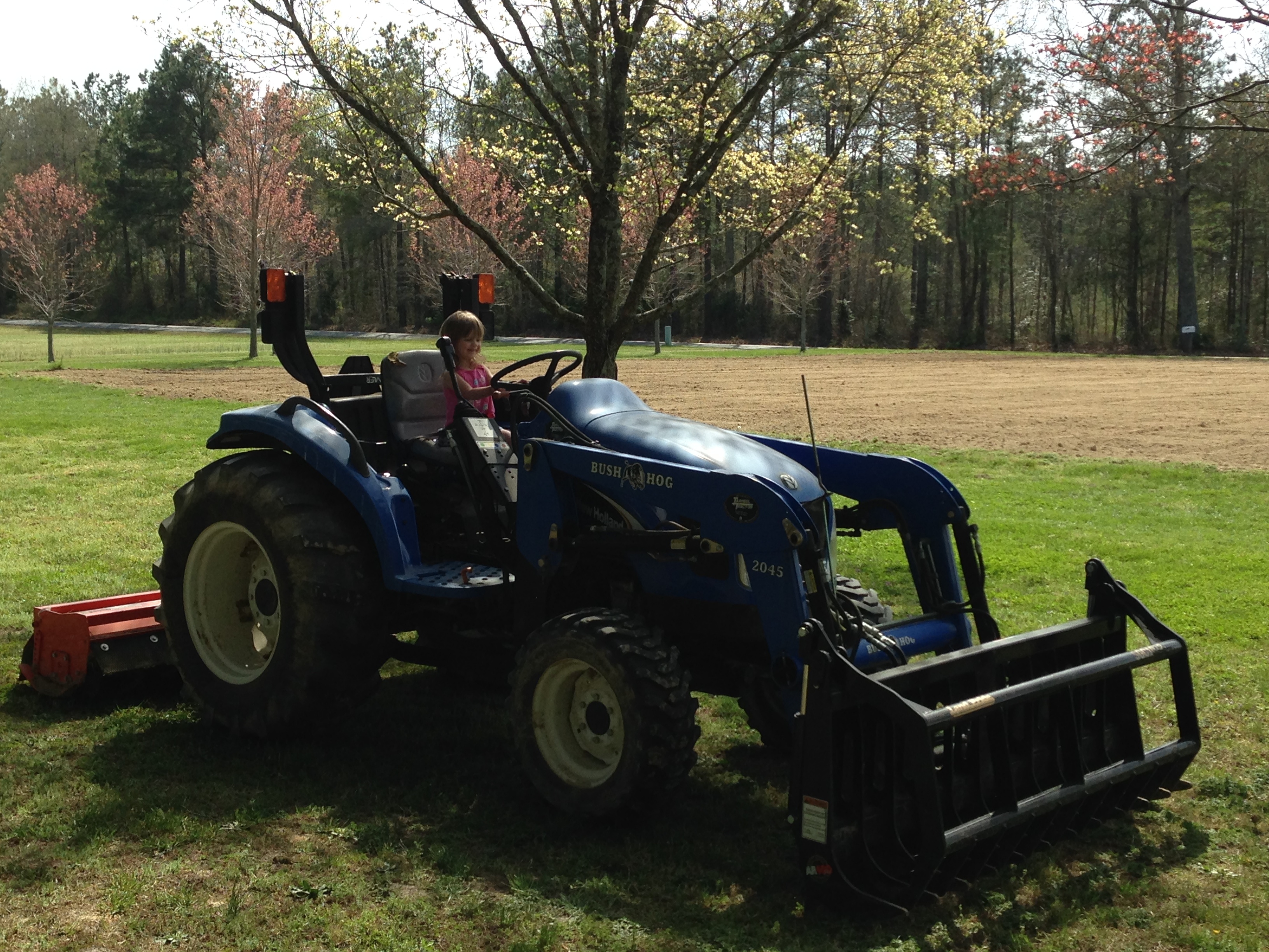

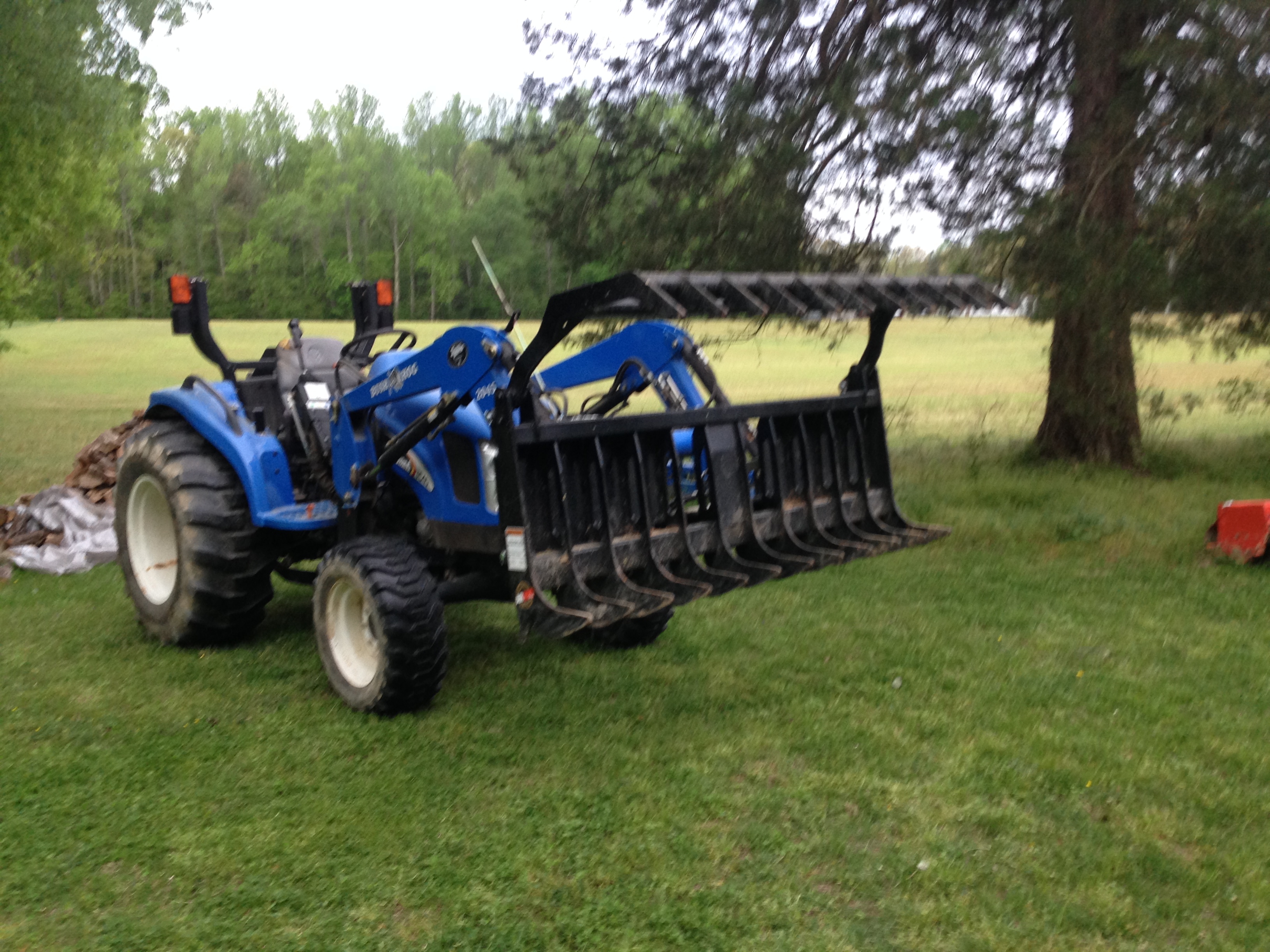

I currently have a New Holland TC40 that I bought new in 2006. Used it on 6 acres for years. Only worked 3 acres of it. It has been an outstanding tractor. You can find a good used one for around 17K. If you can afford to buy used, I would be looking at 30 to 40 HP tractors by Deere, Kubota, Massey, New Holland from the early 2000's with low hours. JMO. Good luck.
