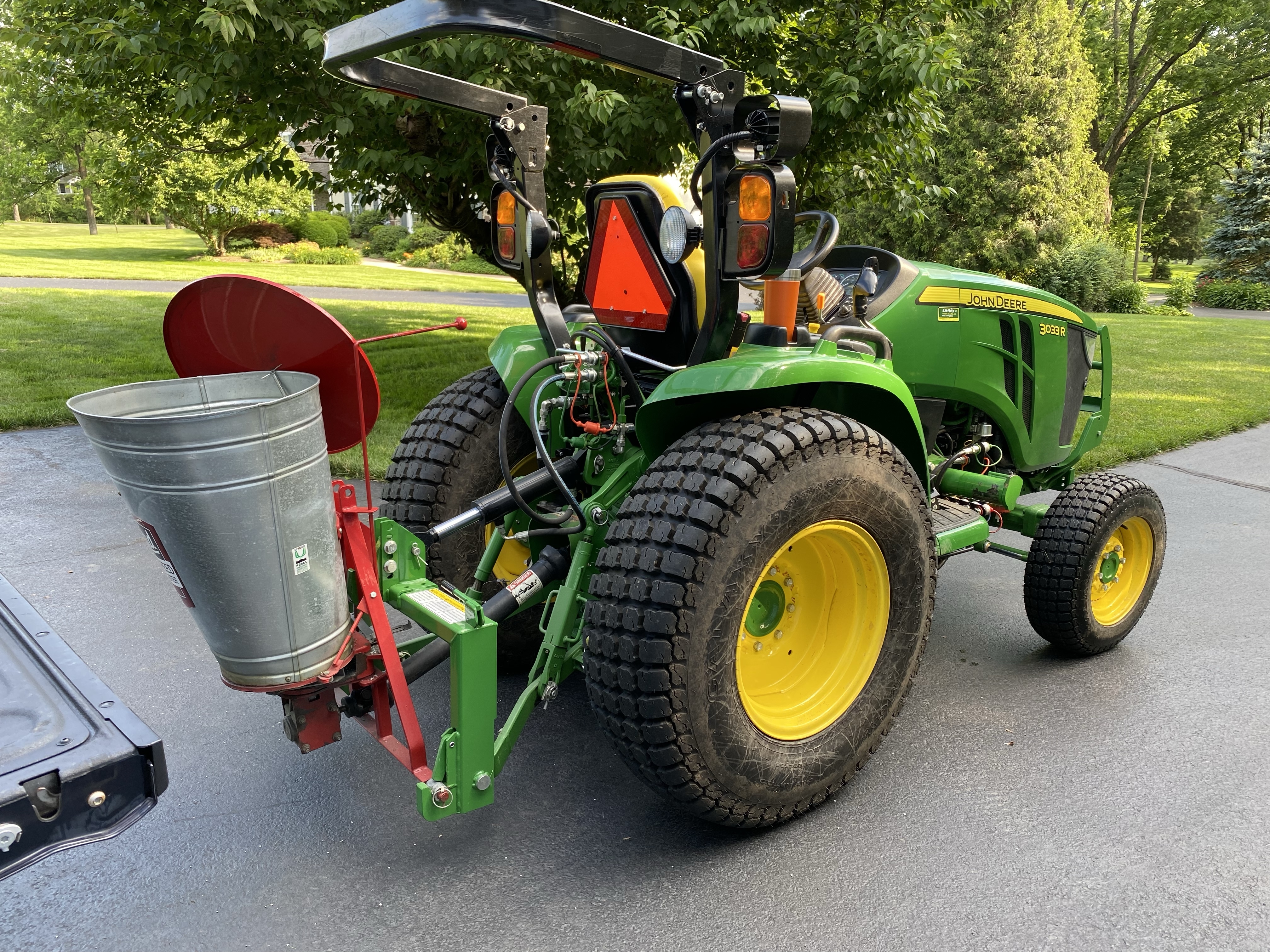

Love my rototiller (photo) but I bought it used and I wouldn't pay what a new one costs. My 4 ft disc isn't as useful but it could substitute.
Spike harrow! (photo)This is what works best for me ripping out blackberry rhizomes, after mowing.

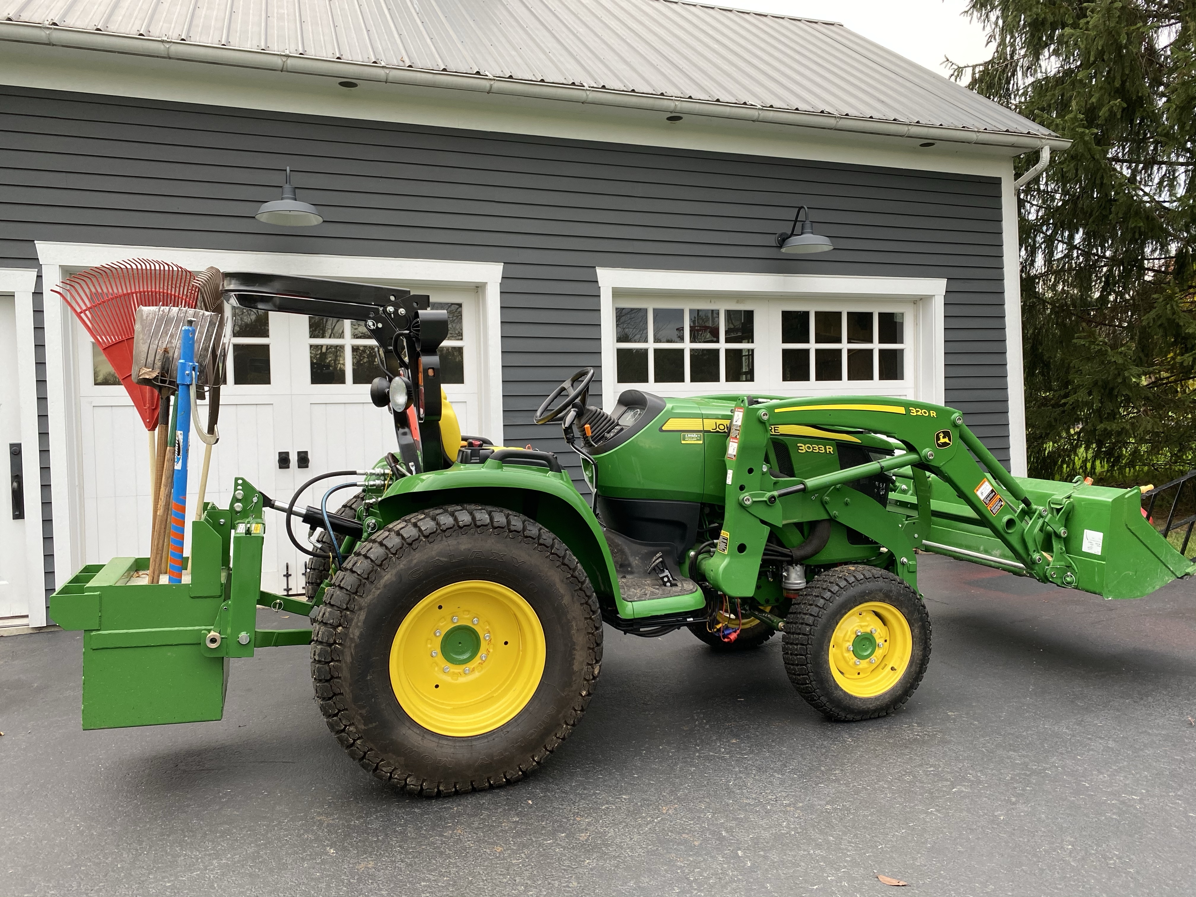

Really nice list! Only thing I'd add would be a ballast box, as that's pretty much always attached to my machine. It's also configured as my tool carrier, which would probably be very useful to the OP, if they're gardening with it:

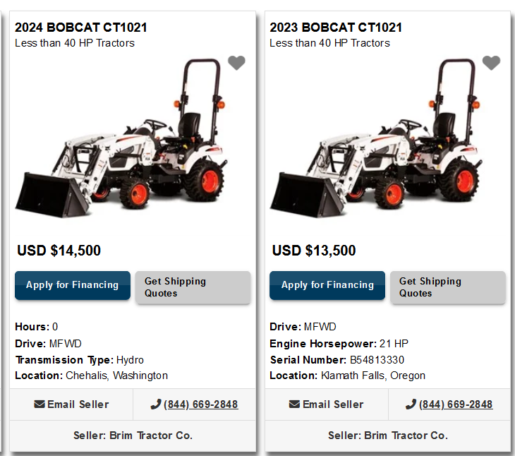

But am I the only one having trouble figuring out how Bobcat is hitting that price point? I've not shopped new tractors this size, so maybe my barometer is just way off.
One thing to note, if "moving wood", we need to know what that means. This machine has only 600 lb. lift at the loader. That'd be fine for moving some split firewood or mulch, and could probably even do dirt or partials of crushed stone in that small bucket. But you're not going to be chaining onto and lifting logs with that lift capacity. I'd also skip the pallet forks purchase if buying a machine that size, as even empty forks are going to use up more than half the capacity of that loader, before you try to lift anything with them.
It's probably a good machine for the right person, I'm not saying it's not, just be aware that you won't be lifting 1000 lb. logs with it.

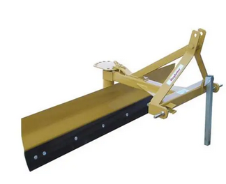

5' rear blade for road maintenance and snow removal $500 View attachment 1510650
I'm not sure how much snow the OP gets, but a tractor this small and light might struggle to move snow with a rear blade, unless they plan to load up the tires or add ballast in some other way. Your challenge in pushing snow with these smaller machines is always traction, not horsepower.
Back when I had my Deere 855 MFWD, which was a little bigger and heavier than the Bobcat, I found I could push 6" of snow with a front blade, but really not much more unless it was powder-dry. If I'd loaded all my tires with ballast, then it'd have done better, but I really didn't want to run ballast the rest of the year in that machine. Whenever we'd get bigger snows, I would have to hook up my 3-point snowblower, and that could easily do up to 2 feet on that machine.
Rear blades are a nice cheap solution, but you're either driving backwards, or trying to drive over and then pull snow up against your rear wheels. Also, you're forced to remove any rear ballast box, when using a rear blade, which hurts your traction a lot. It can work as the least-costly solution, but it's not ideal, so just keep that in mind.

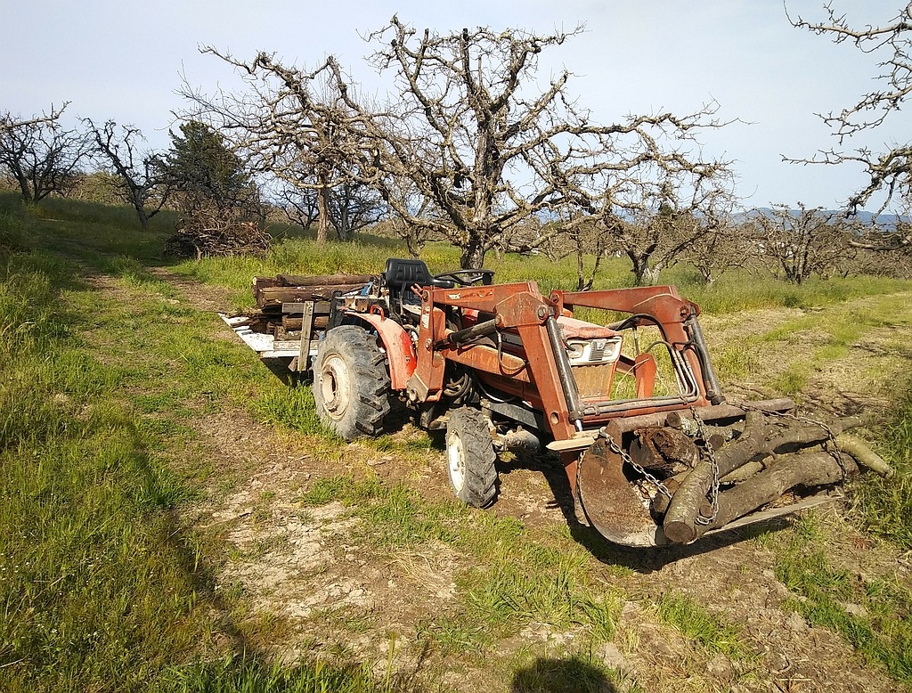

We moved onto the property in 1982. It's 80 acres and classified as open range land. 25 miles due SW of Spokane.
Started with a brand new Ford 1700. 26 engine Hp. Worked just fine from 1982 until 2009. Then I got a new Kubota M6040. I had completed all the smaller projects in those 27 years. I wanted to move on to bigger projects.
