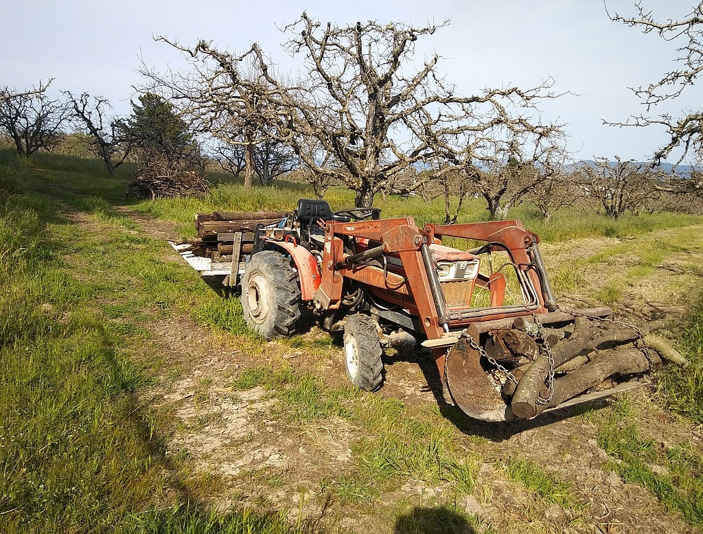

Like this?
Front load is chained so it won't fall out.
Rear is a platform the size of a single bed (the source for its steel perimeter) mounted on a pallet, carried on 3-point pallet forks.
And note the rear wheel weights, they are sufficient for most loads in the front bucket.
Yeah exactly this, maybe to a smaller degree. I try to use my evenings and weekends focused on clean up in the winter season to stay on top of it.
So, the back load is serving as a balance point to what you have on the front?
The ballast weights bolted to the rear wheels are sufficient counter balance for that 200?? lb front load. I wouldn't need anything on the back.
I should note that the 65 lb Quick Hitch that is always on the back is some counterbalance for this small tractor. I hang a couple hundred lbs of weight on it, if I need both counterbalance and improved traction for digging into a dirt pile etc.
Yes. Hanging weight behind the rear axle, on the 3-point, treats the very strong rear axle as a fulcrum. This serves to remove some of the total load in your loader bucket from the more delicate front axle.
