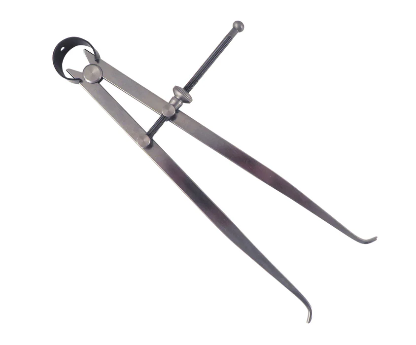

You can usually measure cylinder bore pretty easily at rod end, as the cylinder bore casing extends past the gland a bit. Old-school internal diameter calipers and a ruler or tape measure are the way:
If that doesn't work, measure OD by wrapping a seamstress tape around the cylinder, dividing by pi = 3.14159, and then subtracting 2x wall thickness.

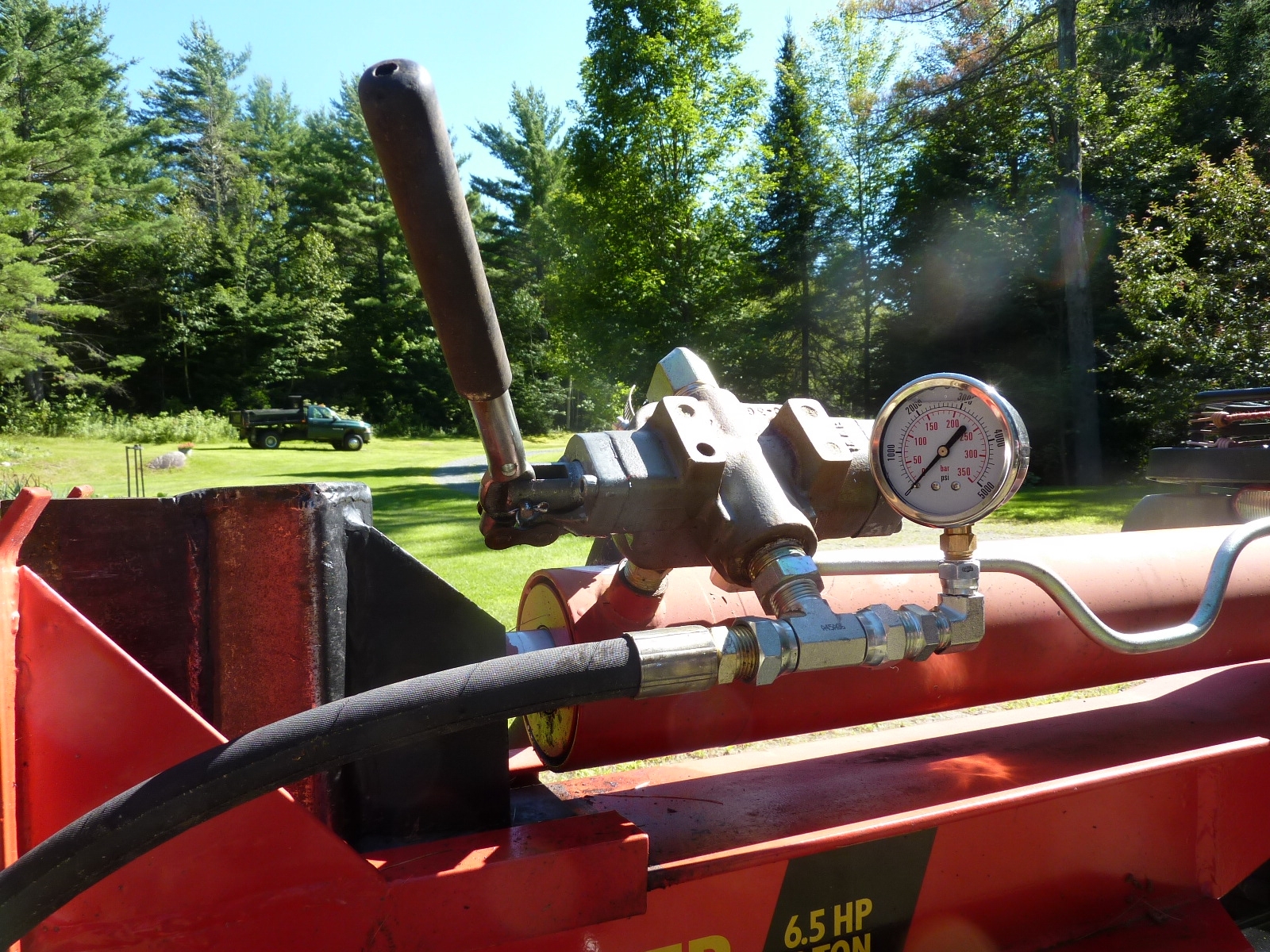

I have a 22 ton Huskee which is a rebranded Speeco. When I first got it 12 years ago I put a pressure gauge on it out of curiosity. It has a 4" cylinder and the max pressure is indeed 3500 psi. That yields 22 ton as advertised. I interesting thing is that for probably 80% of the wood I split the pressure doesn't go above 1500 psi - so less than 10 ton.

Interesting... Never thought of putting gauge before relief valve, always thought it should be after..... New way of thinking every day..... And Yes I realize the pressure in system can not go above relief valve setting if its function properly....
And yes I split a lot of hard dry oak on a 30 year old DUERR splitter and very really does pump drop into high pressure low volume mode....

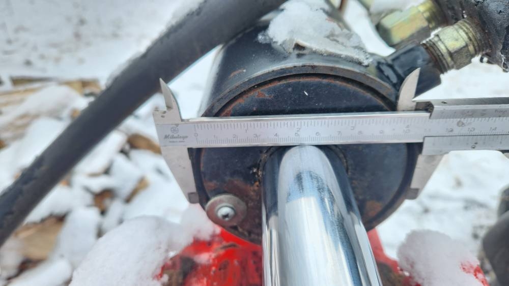

Today I took my caliper with me. Set it at 4.5". In my opinion, that's not a 4.5" cylinder

I'm thinking that it is a 4.5" cylinder as it looks like the calipers match the ID of casing. It sure isn't a 4" cylinder. If the OP is having a problem building enough push, maybe there is a problem with the relief valve, cyl seals, valve body, etc??
