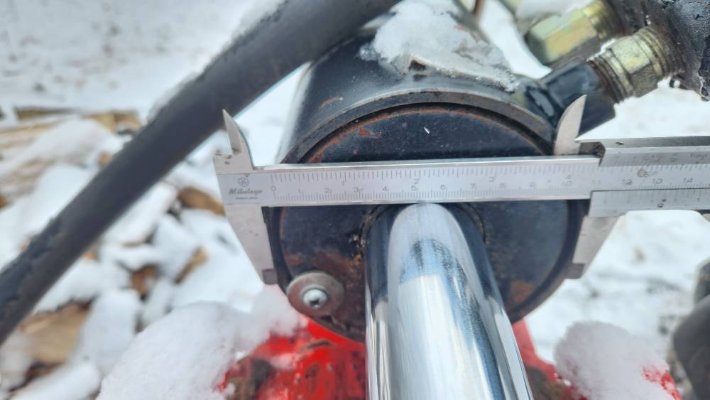

So is it accurate to say the key variables affecting splitter speed are high GPM working a small diameter (yet adequate strength) cylinder?
Everything else - engine size, pump size, plumbing size, fluid reservoir, valves, heat dissipation, welds and fitment either enhance or restrict that objective - but high GPM is key.
Ergonomics and build quality are important, though the objective is to boil down to what is most critical for a meaningful comparison between Splitter A and Splitter B...beyond color scheme and tire size!

Yes. Ergonomics need to be decent as well, but a big pump on a 4" cylinder is going to be the key factors in keeping any impatient user happy.
Engine needs to be large enough to turn the pump, there's a direct relationship between GPM and input horsepower, and lines and ports need to be large enough to not restrict flow / build unreasonable back pressure over the operating temperature range. That's all easy, as manufacturers like Wuxi Butcher (who make the pumps for most consumer-grade splitters) have tables of recommend line sizing and input horsepower, for a given pump and conditions.

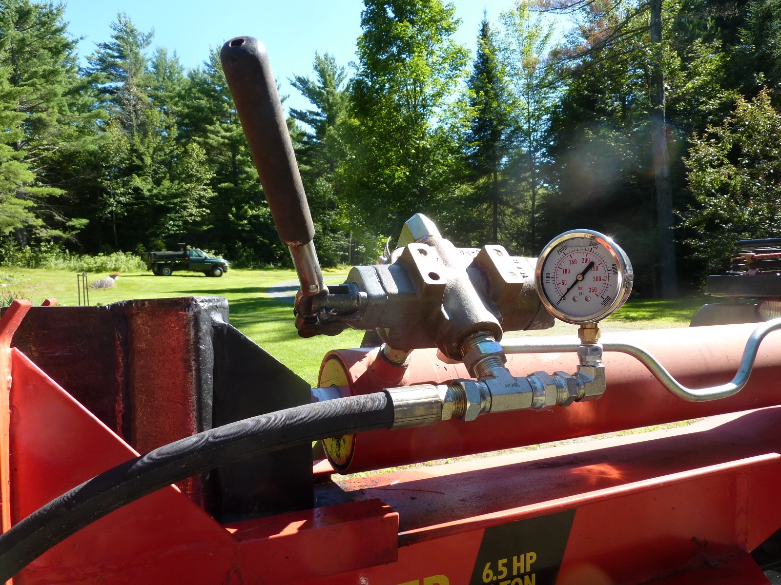

Would it be worth plumbing in a little cooler? Mine gets pretty warm but not to hot to the touch.
   / Question to the firewood gurus #28
That was my plan, when I upgraded the pump from 16 GPM to 19 GPM. But it was winter, and I had wood to split, so I figured I'd give it a try and see how hot it ran.
The gauge on my tank shows the fluid never really creeping up above 180F, which means I might see over 200F on a warmer day, but then again... I don't do long splitting sessions on hot days. So, between that and the challenges of mounting a cooler where it will never get damaged while towing or with wood flying, I've just not bothered with it yet.

Yes GPM to cylinder size matter. But when your 5in cyl with 4 way cycles 2sec slower than with a 4in and 2way wedge it's doing nearly 2x the work.. the work being split wood. Theres actually a calculator for splitter cycle time online I used years ago to figure out the specs for the one I built.
Before I mount a cooler I would also do what you did and see how it ran. And before I mounted a cooler I would try to add capacity. Adding capacity isnt really that hard if you dont care if the splitter looks factory. Granted it is a bit difficult to add capacity to splitter with a hydraulic tank that's also an axle...not not impossible with a welder.
