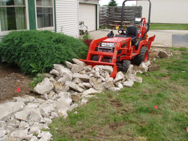

If you still haven't made the deal on the BX23, get the dealer to weld some chain hooks on the end plates of the loader bucket. You can move some serious stuff that way. Welding on the end plates will keep the chain from flexing the unsupported bucket material (which might lead to a fatigue crack).
Attached pix is a bigger 'bota (a 7610), but gives you the idea.
Dave
