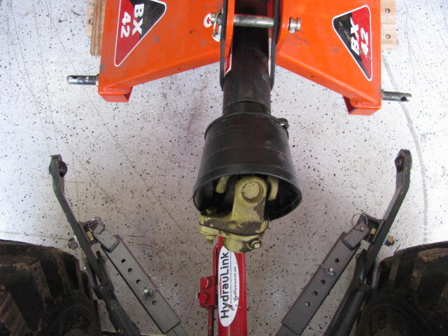

That appears it could be a real bear to get into it to connect the PTO shaft. Looks like a more viable solution than the silly little things sold elsewhere. But I can also see where the implements might need altered to line up to a non-adjustable frame like that.

That appears it could be a real bear to get into it to connect the PTO shaft. Looks like a more viable solution than the silly little things sold elsewhere. But I can also see where the implements might be a pain to line up to a non-adjustable frame like that.
I don't notice it being hard to hook the PTO but I'm on a pretty good sized tractor too. The secret to an easy hook-up is a good unhook. My attachments are normally parked on a good flat place and blocked. So hook ups are very easy.
If you also have top&tilt it's possible to hook up when at almost any angle or tilt. Not pimping top&tilt, just making points about how to get the most out of a Quick Hitch.

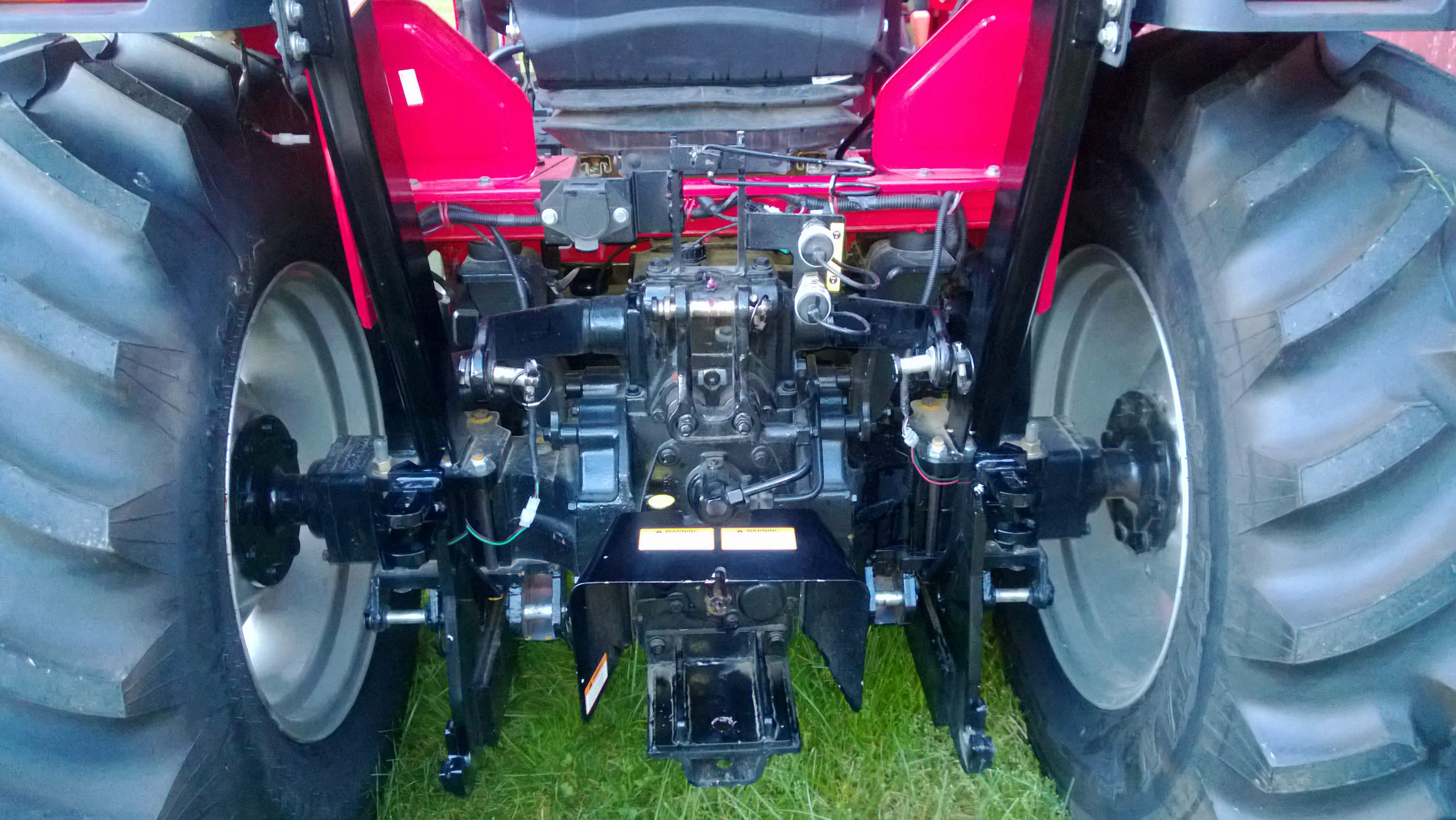

I use quick hitches on all of my tractors because they are simple and easy to use by myself. You can opt for auto hitch to automatically hook up the pto if you get all of the right implements to start with. Deere has this compatibility available with their MX rotary cutters, 6xx series tillers and a few other tools.
The standard I Match is what I use without the pto add ons, makes it about 1 minute to drop most implements and pickup another from the seat. Sometimes it is a little more trouble but not often. I would only recommend using a quick hitch if you are willing to setup the implements correctly at the beginning. When I bought mine I took the better part of one day and made all the modifications needed to make everything fit. That was over 4 years ago, I have been smiling ever since.
