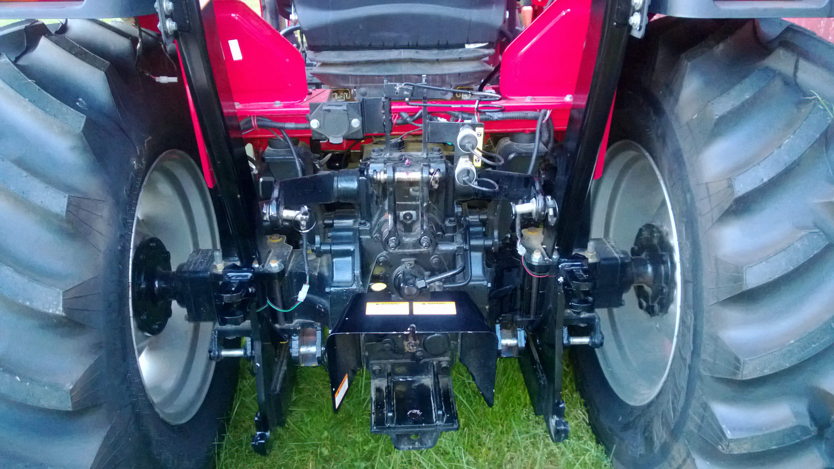

I will be different.
I recommend pin-adjustable rigid stabilizers. I bought mine from Stabilworks.
You pin the lower links open to the width of your draw pins, back up, un-pin one side, and push the lower link eyes over the draw pins.
Requires no additional paraphernalia on your implements, and you preserve leveling function of the eyes.
PTO shaft extensions not required. Proprietary lynch pins not required.
Reinforces lower links on rare occasions when you may wish to PUSH with the tractor in reverse.
You do have to get down off the tractor......
I am 66 and have the same wear-and-tear body issues.
Kubota tractor stabilizers Kubota [url]www.stabilworks.com - YouTube[/url]

Those are the types of stabilizers my tractor shipped with. Mine are installed on the outsides of the arms and extended to limit the side to side travel whereas yours would be shortened to limit the travel. It appears from the image the connections on the tractor are spaced much wider on mine. Only image handy doesn't have the 3pt stuff in place.
I'll snap one with them on first chance I get.
I do agree they're much faster than having to crank on a turnbuckle to a width to get past the pins, then having to crank on them again once on the pins to adjust/limit travel. As far as that goes quickhitch may help with turnbuckles some due to the proper width for the implement only needing dialed in once per hook-up.
