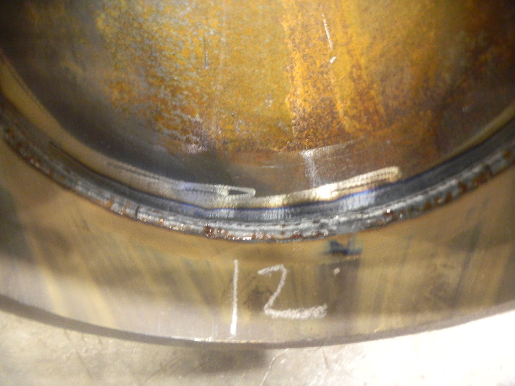

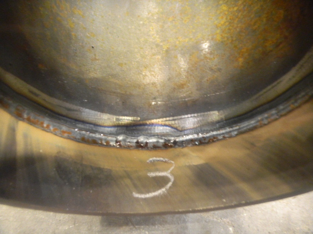

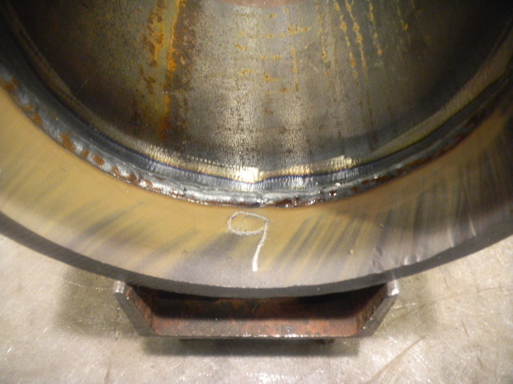

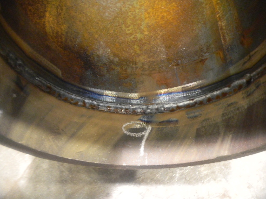

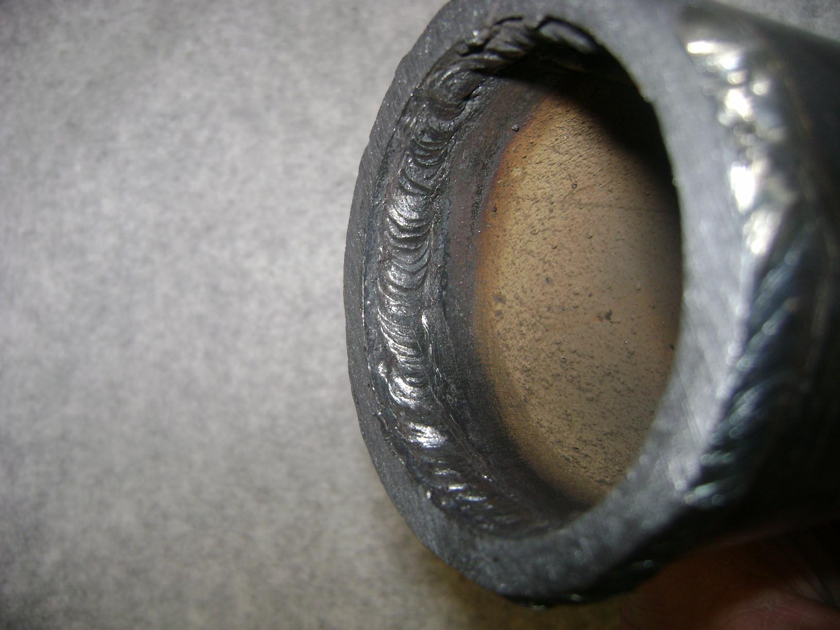

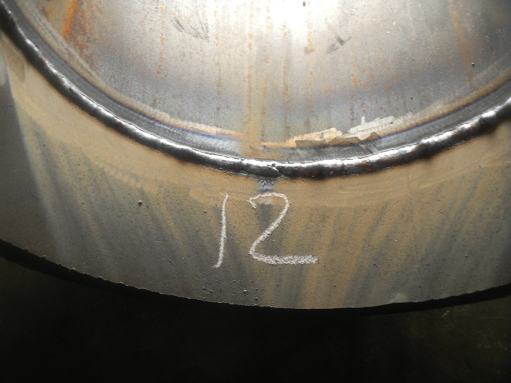

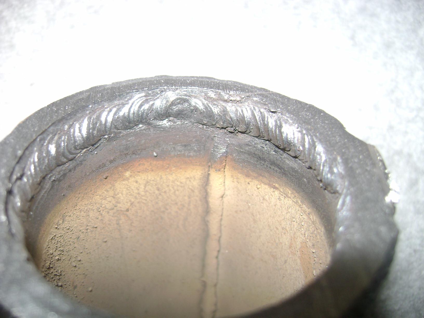

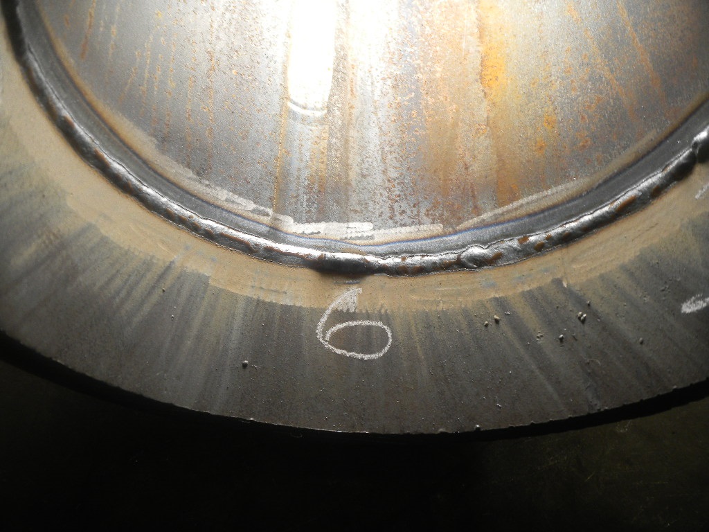

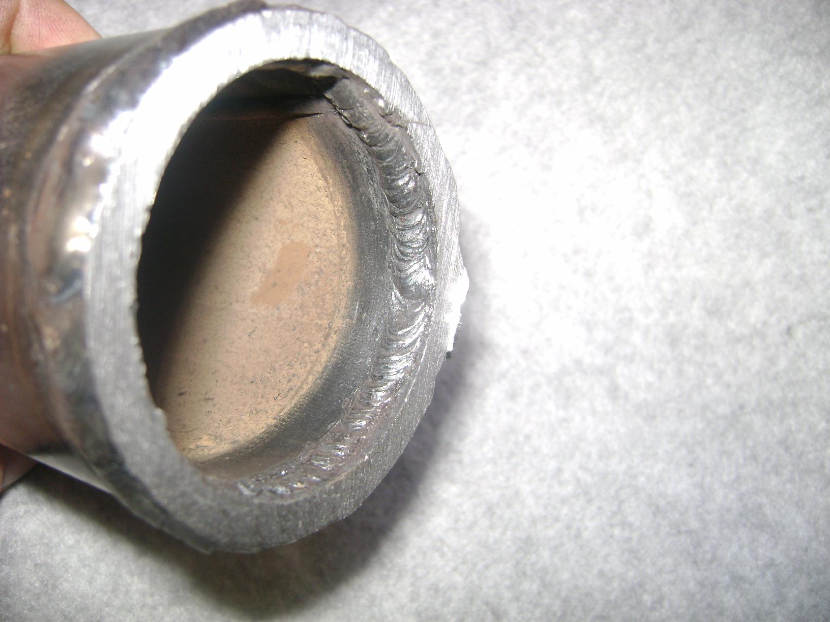

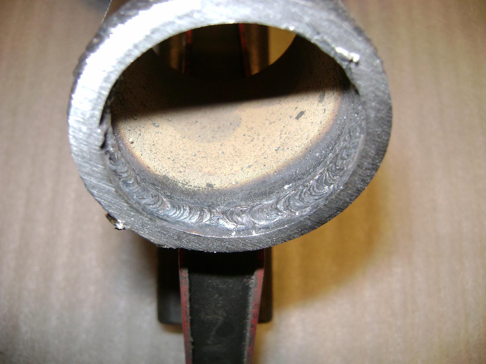

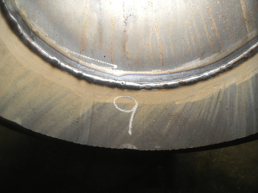

Tig welding open root. 6G position. 6-inch sch. 80 pipe. 37 1/2 degree bevel, knife edge. 1/8-inch gap. 1/8-inch filler. 125-AMPS, walking the cup. Miller Dynasty 300.
Never had much of an opportunity to Tig weld pipe. Union thing!
Do you pipe welders think this Tig root would pass visual?
Thank you for the help!;)

Hard to tell much by the photos other than the excessive penetration (lumps and cold wire looks to be about 1/8" high and 3/32 would be all that is allowable) in a couple of spots. Looks to be some IF at 12 (likely tie in at a tack.
I guess it would depend on the inspector and how smooth he wants it to look. Other than the couple of drop thru (EP) and the low bead at 12 which is hard to tell if it is IF (inadequate fusion of the root) or just a low spot it looks pretty good. A low spot like that when every thing else is heavy root would show up really light on an xray and might be rejected without visual conformation which you may not get on the test. I was always a little lenient on welders with regard to root reinforcement as long as most of it looked good but I have seen inspectors that were real hard axxes and wanted everything perfect ie, top bottom and sides identical.
Fitup seems to be OK per your description so you may have been running a bit on the hot side which caused the EP and drop thru.

The secret to perfect beads is smooth and consistent feeding of the filler rod which takes a lot of practice. You need to keep the end of the rod in the puddle especially on the bottom and use the rod to hold the puddle up by feeding it from the inside. In order to do this, the gap must always exceed the diameter of the wire. I always gapped 6" so that I had a loose 1/8 gap after tacking and never put more than 3 tacks on the pipe if I was allowed. Start on the side without a tack and weld it first (no tacks to worry about tie in issues). Feather edge all your tacks on both ends. Some welders will feather edge each stop before starting to weld again as this makes for a smoother start up with less likelihood of a drop thru because of staying in the tack too long to preheat.
RUN the bottom half on both sides before the gap closes. You may have to go to 3/32 wire for some of the bead if it closes up on you to where the 1/8" can no longer be inserted. You kinda have to start with the wire on the inside so the bottom of the wire is flush with the inside of the pipe and transition as you go up to where the bottom of the rod is flush with the outside of the bevel. Don't know if I am explaining that right. Learn to feed the wire from the inside on the SS because on the alloys listed below, you can only weld them by feeding from the inside.
Different alloys demand different techniques with SS being the most flowable and most forgiving of a mistake. Inconel, Alloy 20, Hastelloy, Titanium and Zirconium are least forgiving and each has a different technique to use for welding but all of these is a one shot deal, get it right the first time or cut it out and start over.

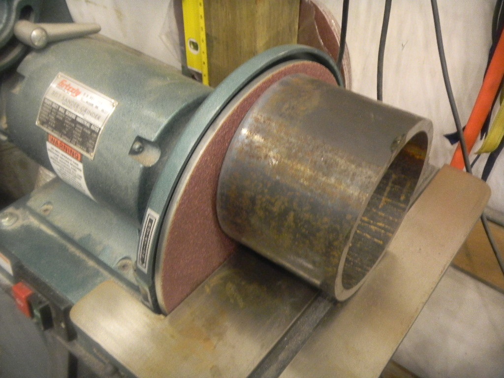

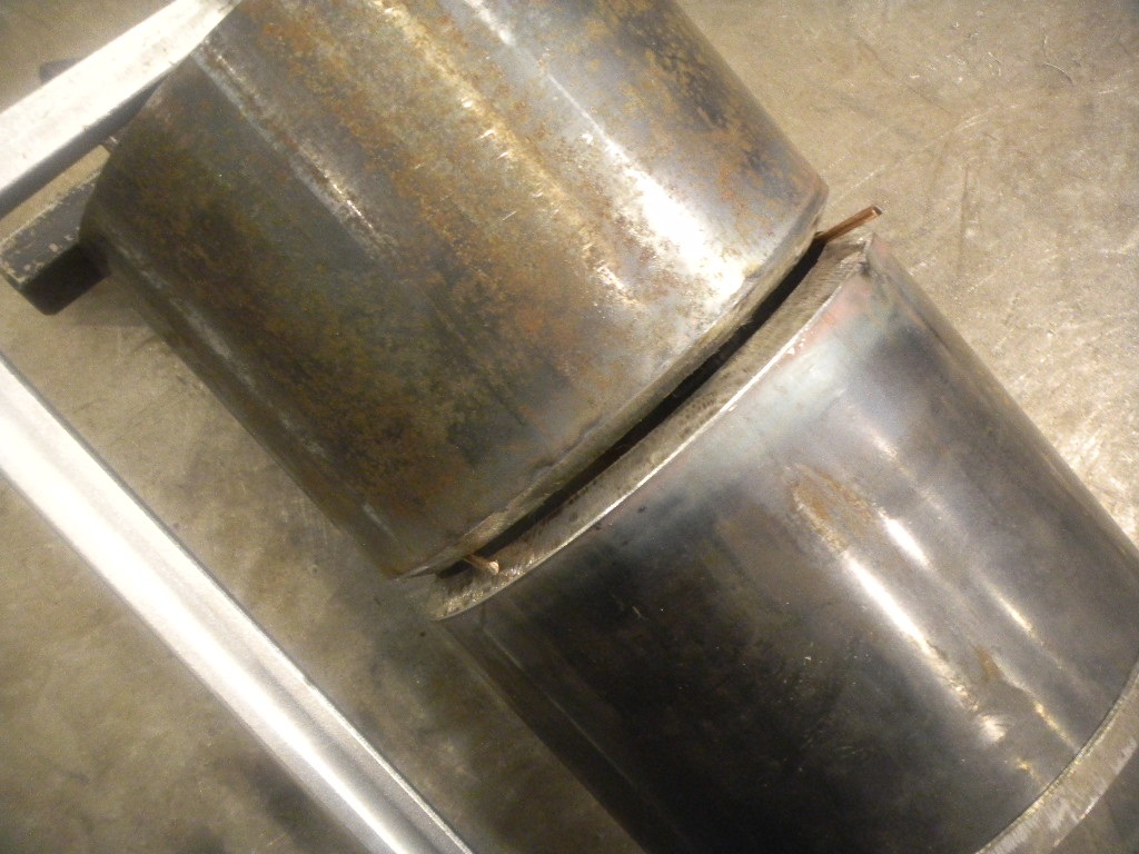

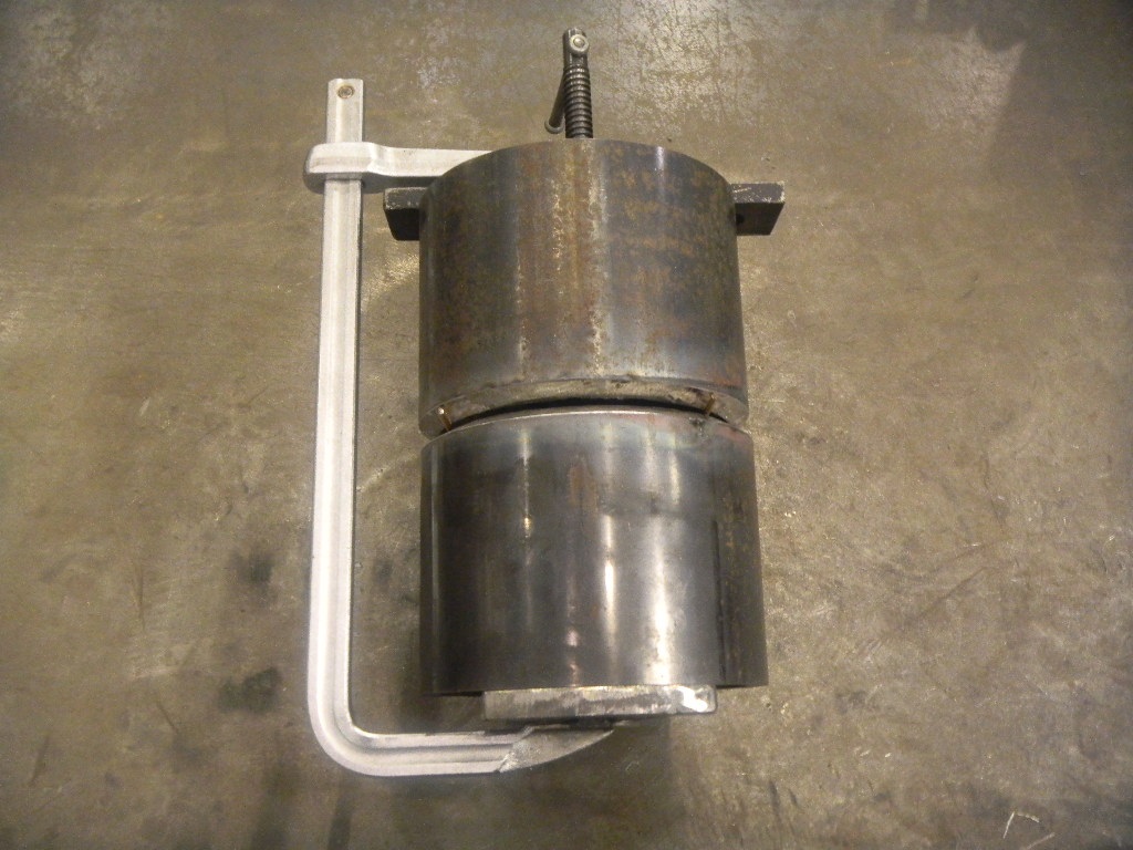

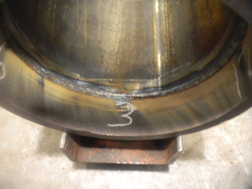

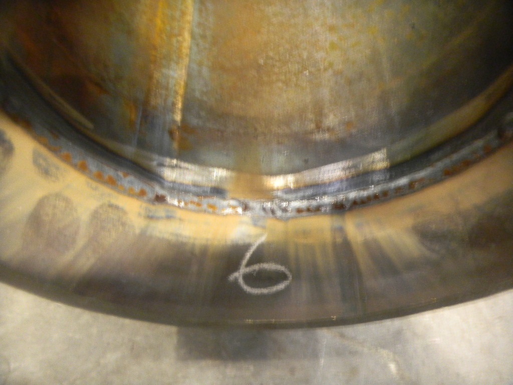

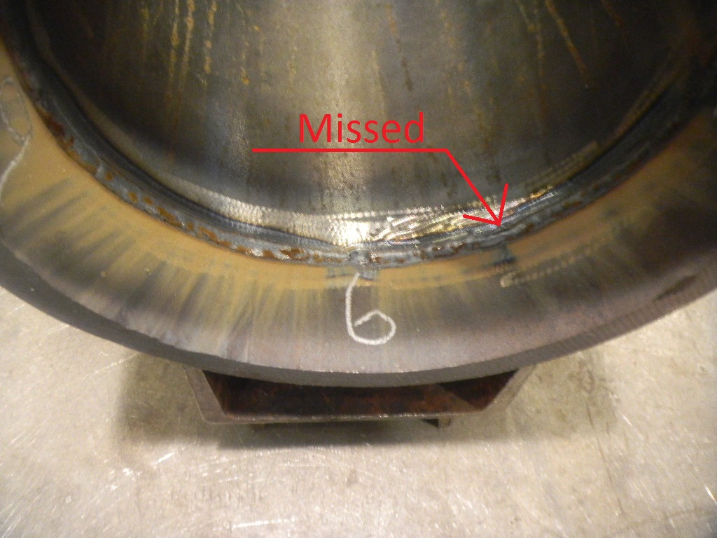

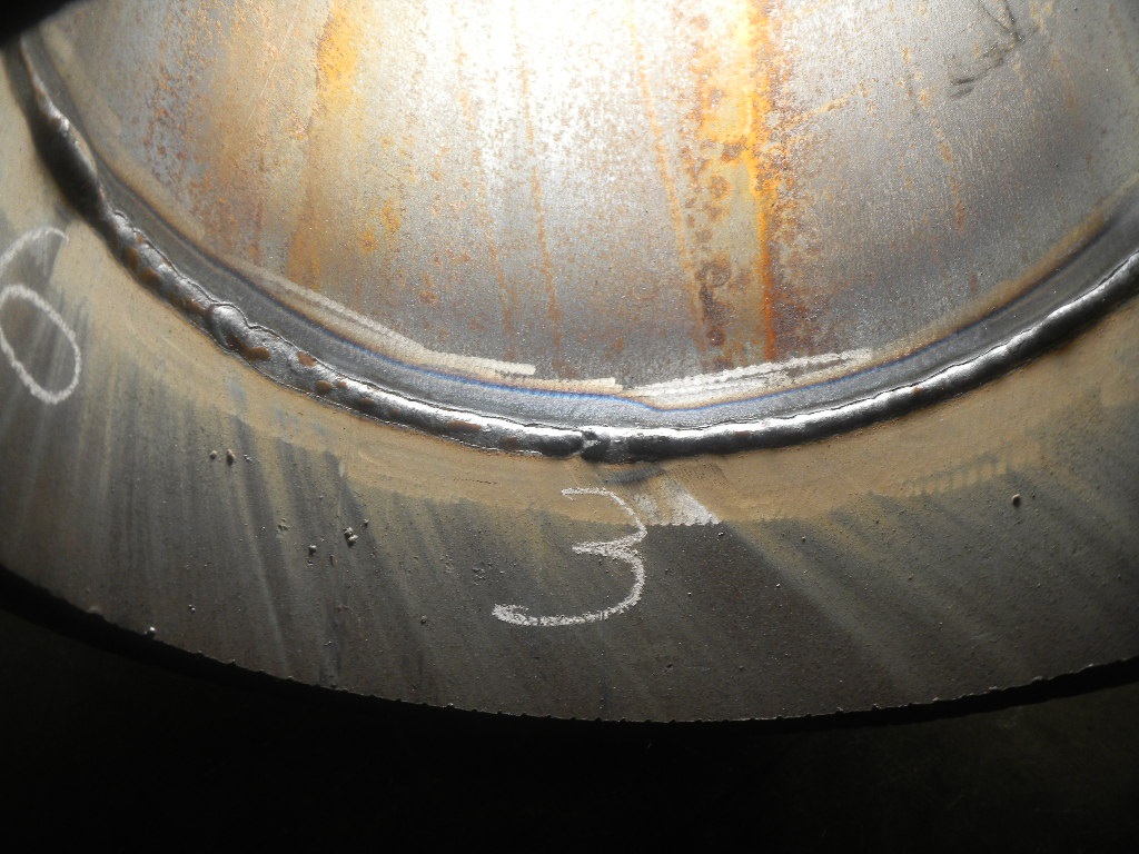

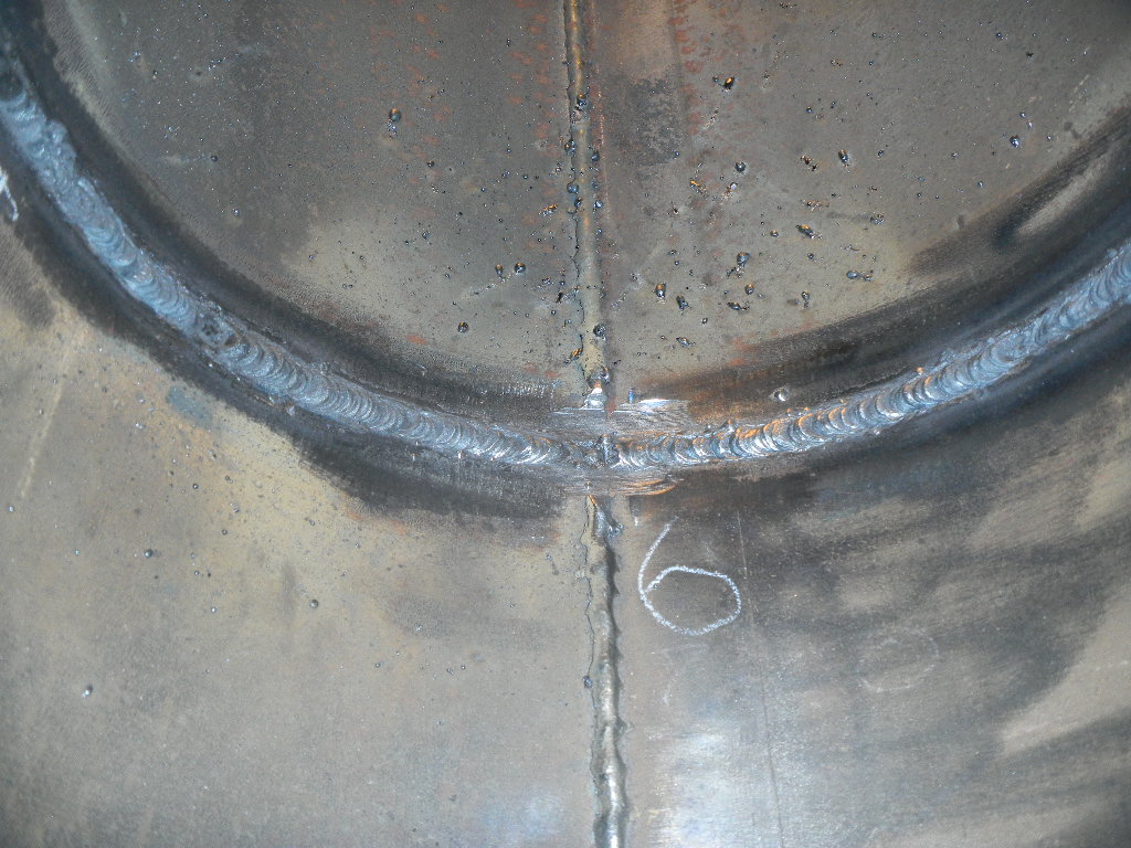

Did another joint this morning. I knew Gary would give great advice:thumbsup:. I dropped down from 125-AMPS, to 120-AMPS. Really seemed to help.:cool:
As you can see in the picture of #6 I had lack of fusion, from 6 to 3. From 6 to 3, and from 3 to 12 you have to weld left handed. My eye sight isn't what is use to be:mad:, so I missed this section. It's going to take some time to get consistent with width, and reinforcement!

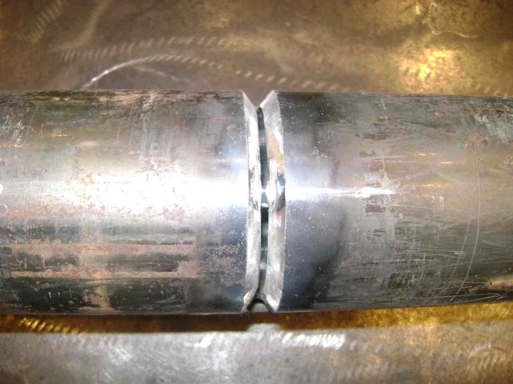

I'm starting to think open root with 6010, is a lot easier!:laughing:

I like a little bit of a land on mine, I mean like just run a flap disk over the edge as it's winding down. Make it a **** of a lot easier to run a little heat (I usually max out at around 125 amps though).
Keep at it. I also figured out how to weld the whole thing out right handed (besides bell hole or half bell).

Standard test for most of my company,Except for the 6010 fill, we used 7018 fill and cap. Using 7018 fill was easier to burn thru a thin TIG root/hot pass if not put in heavy. I assume you were filling with 6010 downhill rather than uphill because if running uphill with 6010, it would take longer than running uphill with 7018.
It really helps when TIG welding if you are ambidextrous so you can get the off hand side by switching hands.

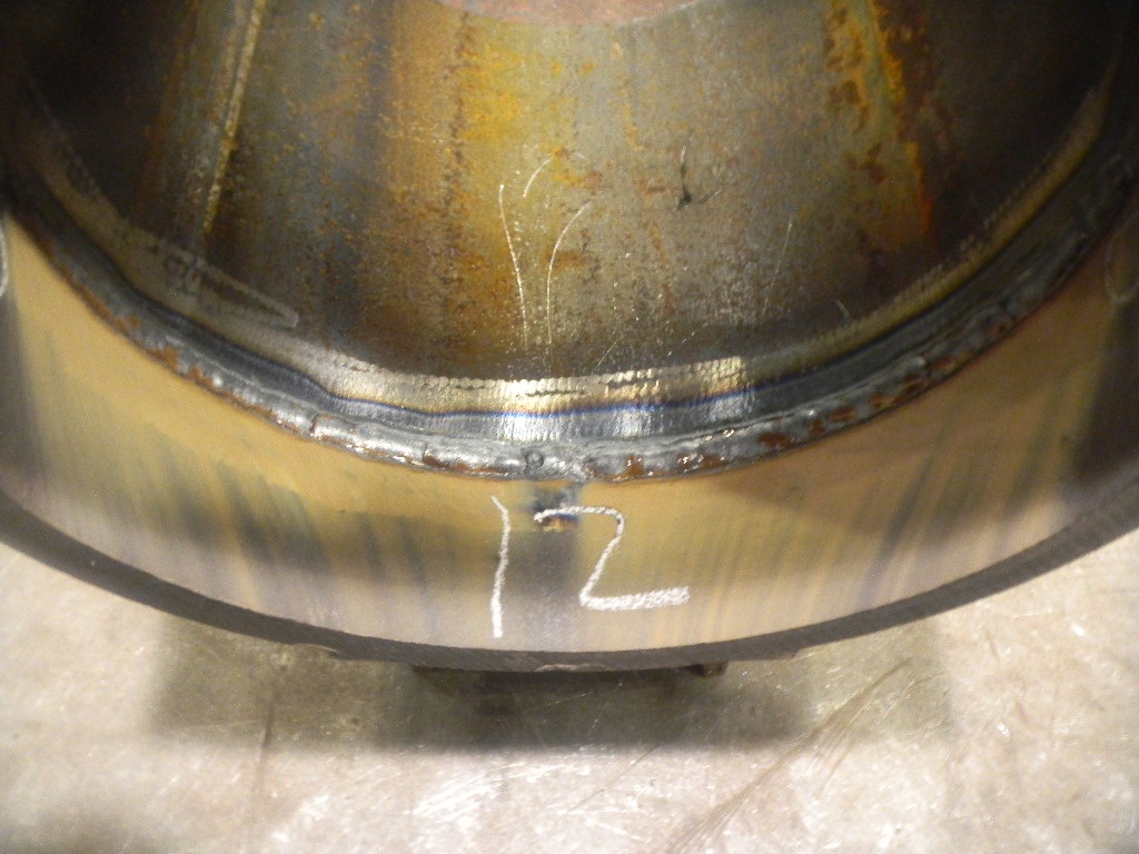

With my former employer (KBR Inc.) we pretty much got away from 6010 root passes 30 years ago. We found that a TIG root and hot pass followed by 7018 fill and cap was faster, cleaner and more apt to pass 100% xray than any other process. 30 years ago, most clients wouldn't let you use MIG in the field and it is still pretty much true today due to the lack of fusion that the process is prone to do unless a very skilled operator is used. MIG is ok in a shop where most welds can be rolled out on positioners, but in the field it is a crap shoot. It is used a lot for structural steel welding where a bit of porosity and NF is not an issue and since most of the structural welding is flat or vertical it works great.
As to your new test, it looks like you are still not feather edging your tacks or stops enough. Feather edge really good each side of a tack and also each time you stop, feather edge the stop so you get a good tie in without a low spot in the bead. Then you can just start your arc on the heavy part of the tack, lay your rod right in the slope of the feathering and when the key hole appears, just keep feeding the rod uniformly and away you go.
I think you are doing an excellent job if you haven't done this in a long time. Just keep practicing. Don't forget to crank up the heat about 15 or more amps for the hot pass. You want to run as hot as you can, put in as much filler as you can on the hot pass without getting cold lap but not so hot as to suck out the bead on the bottom or burn thru on the sides and top.

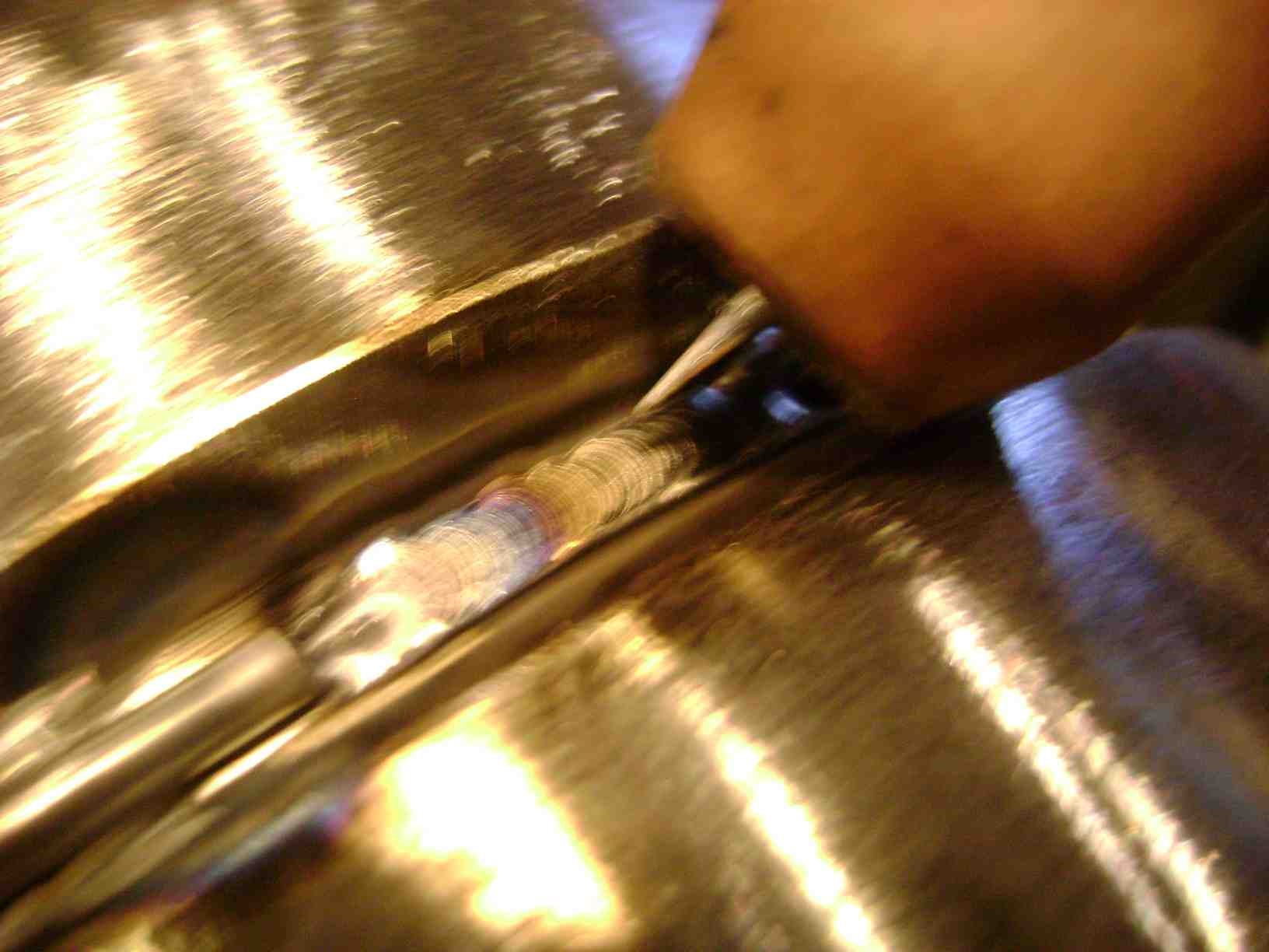

Gary coming from the structural world. I never did much down hill welding. I always go up hill, even with 6010.
I take a die grinder and feather / ramp my tacks.
I know several welders who work in the local Trident Nuclear Submarine base. All their pipe welding is done with Tig. When I took the Tig welding class in the 1970s. The teacher was a pipe welder in the local Navy shipyard. He would not allow me to walk the cup. The Navy forbids touching the cup to the base metal. The owner of the company I worked for was a pipe welder. He wrote a letter to the teacher to let me walk the cup. The teacher refused. The owner donated about $100,000.00 a year to the college. He threatened to stop donating! Guess what? I was allowed to walk the cup from then on!:laughing:

Slowly getting better. Still have trouble welding left handed, from 6 to 3.:rolleyes:
I had a pretty good tie in to the bottom tack, (last picture). This was in the #6 position.
