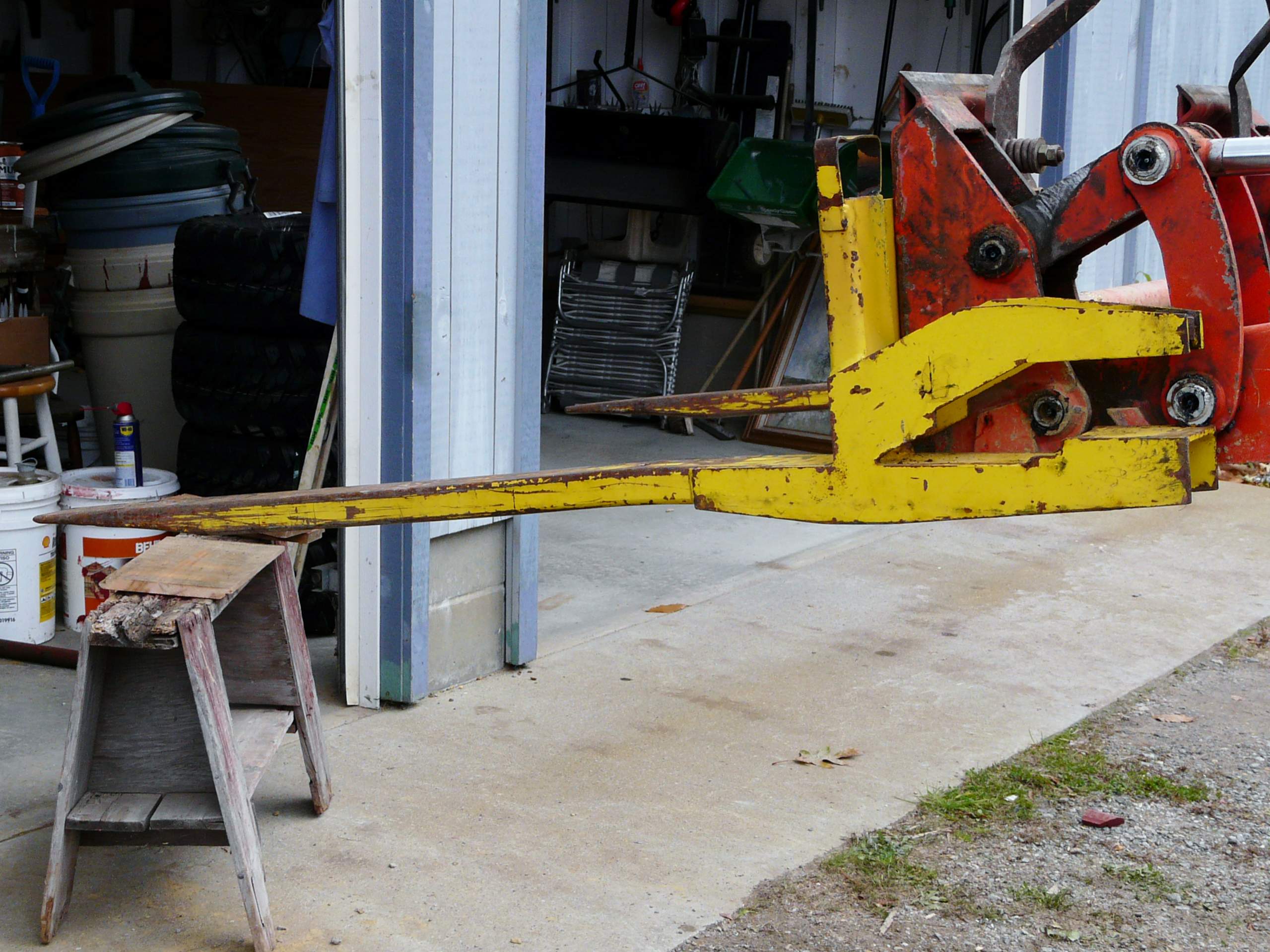

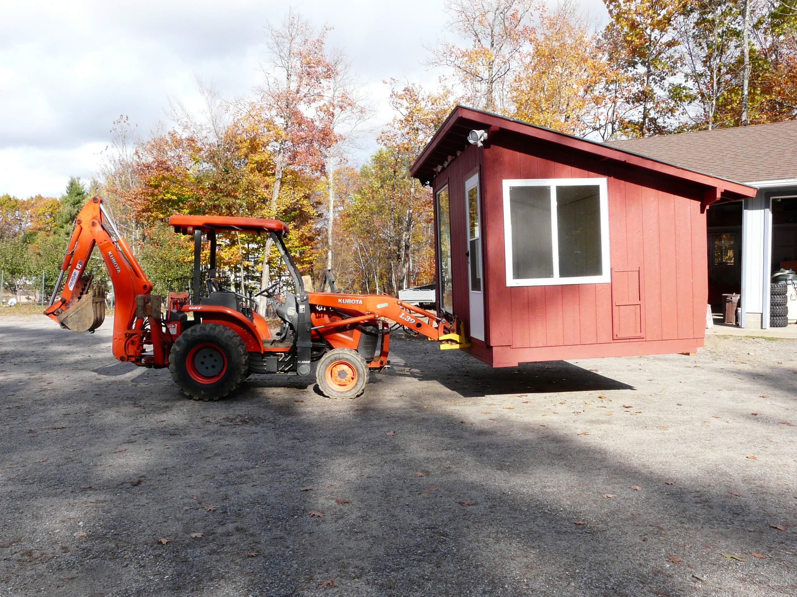

FYI
My forks made from 3x 1-1/2 Tubing for my L39 Bent a bit in this application. Time to straighten them with my excavator.
