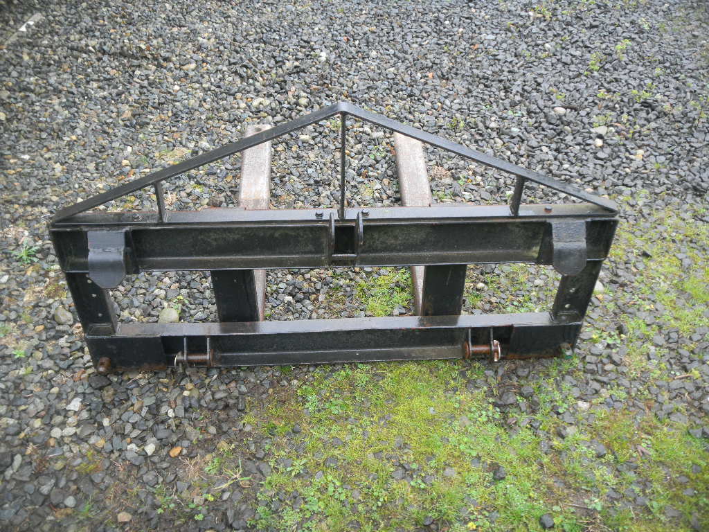

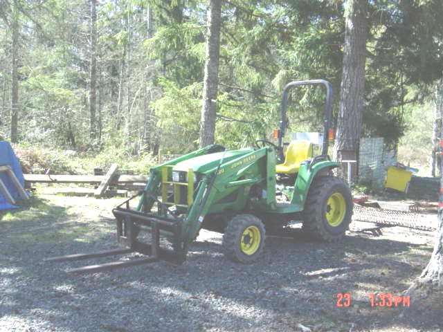

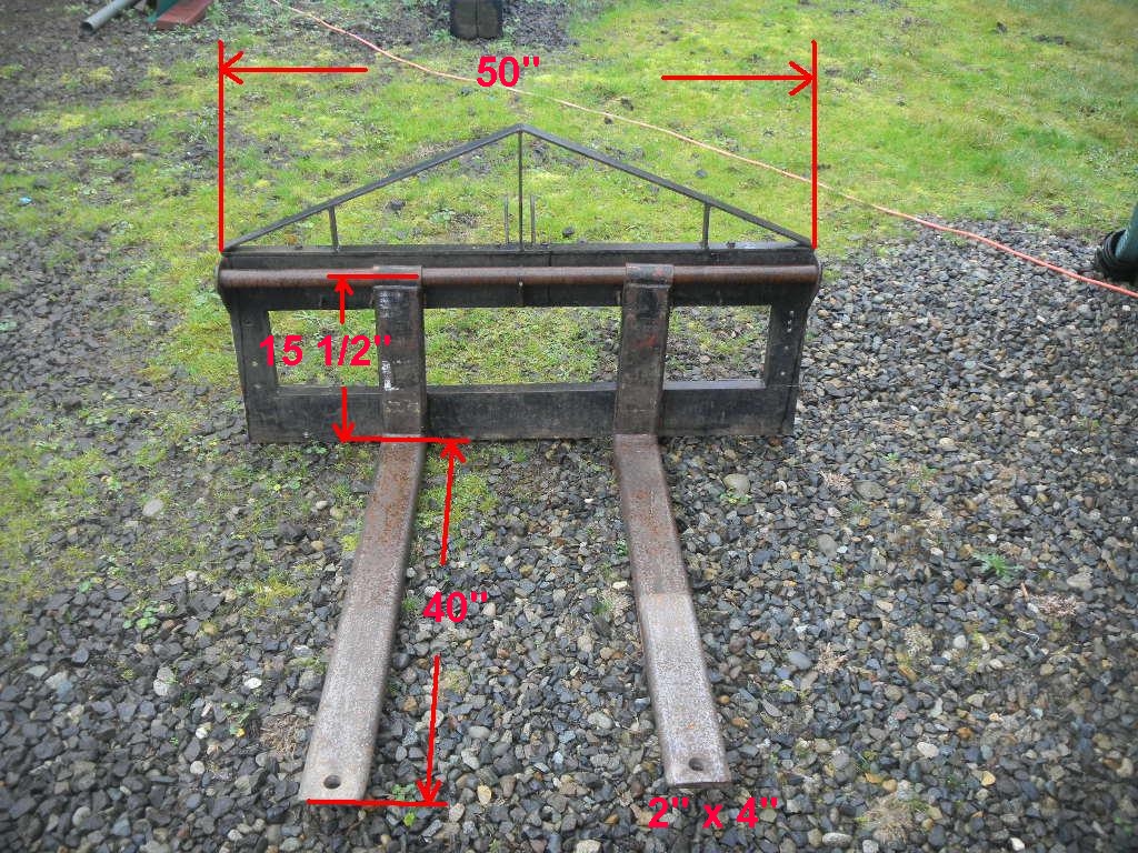

Here's a set I built about 15-years ago. Used 2" x 4" rectangular tubing. They will fit on the FEL, or the 3-PH. I've used shackles and chokers in the holes at the tips, and stalled the FEL. About 1,400- pounds of lift.
Pretty handy attachment to have.;)

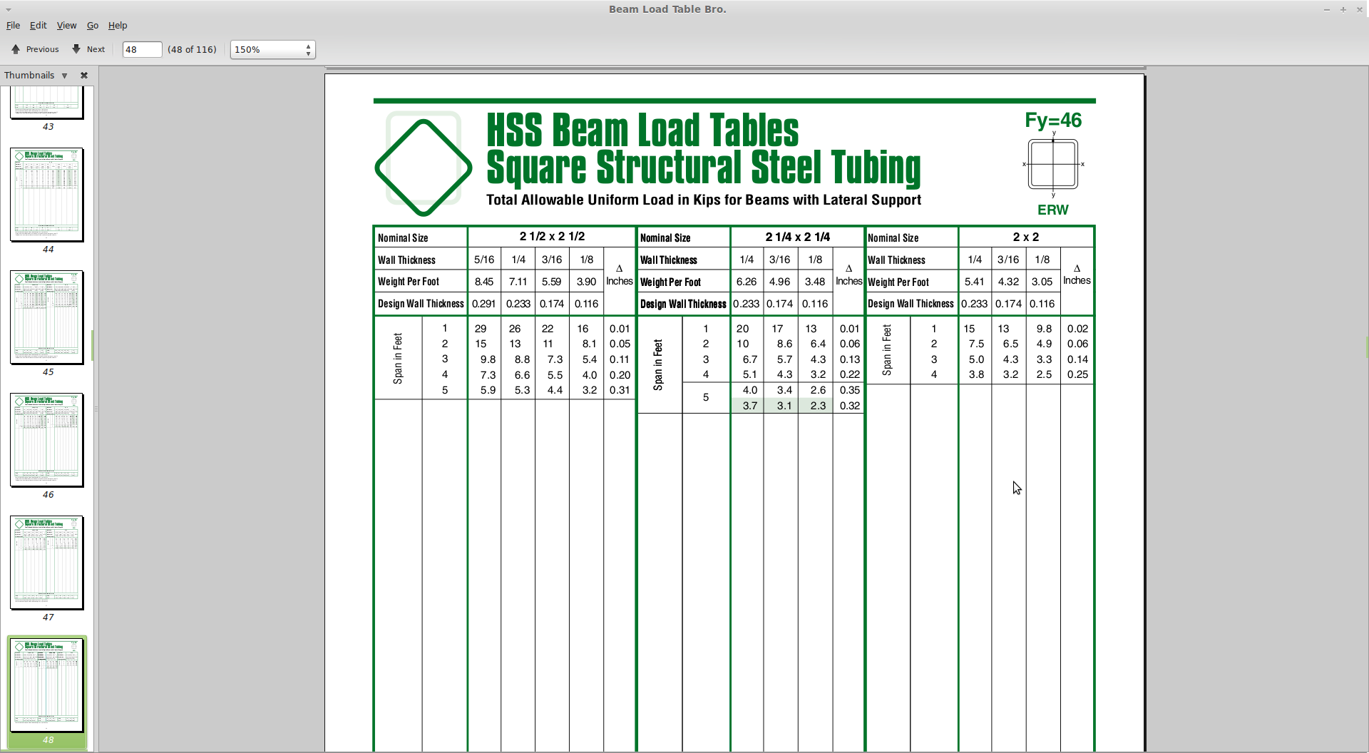

May be these charts will help you determine what size box tube will work for you.
