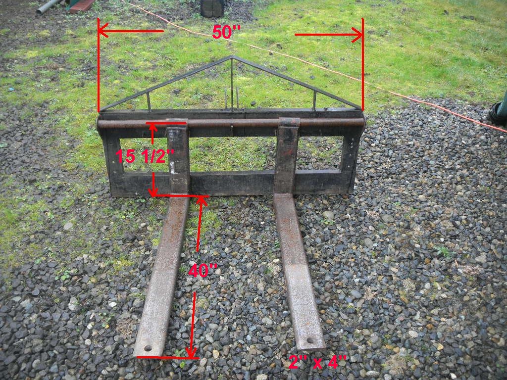

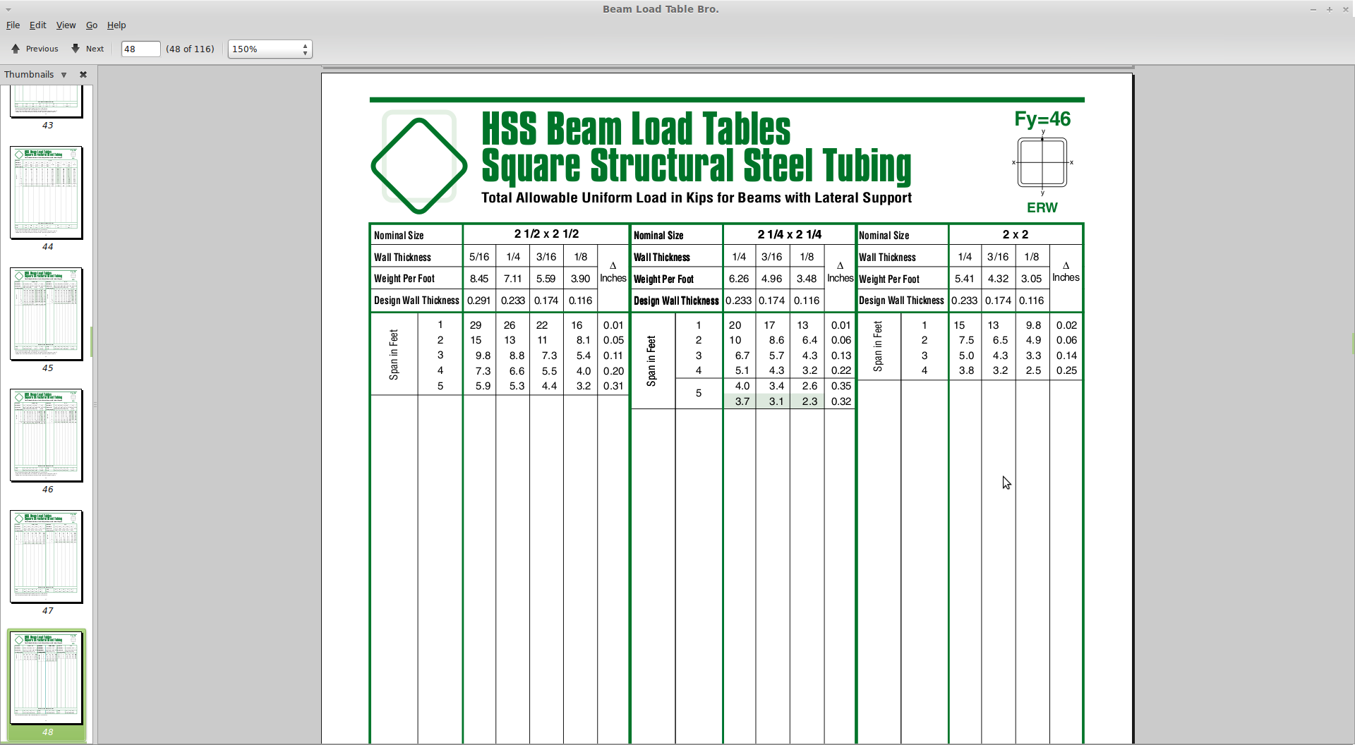

Heres some engineering for ya. You've already moved on but the engineer will still flog you with numbers. :laughing:
I'm going to assume:
1) max you can lift with a B7800 on a 3-point forksith a B7800 is about 1000 lbs
2) using point loads for simplicity; at the tip, and at 28"
If you want to consider all the 1,000lbs on one tine, you can pretty much double the deflections. "Deflection" is the inches it bent due to the load (flex).
2 x 2 x 1/4" steel (I=.91) 48 inches long, cantilevered load:
1,000 lbs equally on 2 tines (500 lbs per tine)
500 lbs point load at end (48 inches) deflection is 0.70 inches at end.
500 lbs point load at 28 inches, deflection at 28" is .14, deflection at end (48") is .28
3 x 1.5 x 3/16" steel (I=.71) 48 inches long, cantilevered load:
500 lbs point load at end (48 inches) deflection is 0.90 inches at end.
500 lbs point load at 28 inches, deflection at 28" is .18, deflection at end (48") is .37
2 x 4 x 1/4" steel (I=1.68) 48 inches long, cantilevered load:
500 lbs point load at end (48 inches) deflection is 0.38 inches at end.
500 lbs point load at 28 inches, deflection at 28" is .07, deflection at end (48") is .15
This is not complete engineering, theres a lot more to be done. The load at which the tine (A-500 steel, 46,000 psi yield) will take a permanent bend (not spring back) is the next calculation - I am lazy at the moment but I can get it.
/ Question about steel strength??
#49

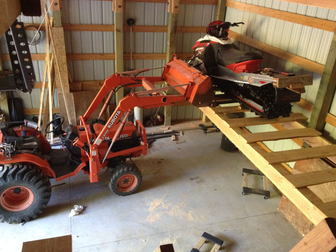

Rated lift capacity of the FEL (LA402 - 402kg) is 900 lbs. With my brush fork (68 lb) plus 520 lb snowmobile ( = 588 lbs) its right at the FEL's limit. This is only 2/3 of 900 lbs. Its also right at the tipping point of a tractor with no ballast (you sitting in the seat is required :D.) Removing the bucket will reduce the need for ballast.
Here's setting the snowmobile on a shelf. Lucky I did not build the shelf at the full height (66 in) of the LA402's specifications, had to build it at 50 inches cuz the loader could only lift the 588 lbs to 50+ inches.View attachment 417765
snip"
Ill use some real numbers.
Using the moment of inertia calculators isnt exact for tubing, cause it assumes squared corners (more material than rounded). So lets use actual numbers.
3 x 1.5 x 3/16 tubing I= 0.488
2x2x1/4 ..................I= 0.77
2x4x1/4...................I=1.54
I would also assume the max load on 1 fork, to represent a real world worst case scenario. Never know when you are gonna be lifting a log or something to the max, and 1 fork may slip off, putting all the load on the other.
So......here we go.
3x1.5 fork 48" long @ 1000# will deflect 2.6"
................28" fork..............................0.5"
2x2x1/4........48" long...........................1.65"
...................28"....................................0.33"
2x4x1/4.........48"..................................0.82"
.....................28".................................0.16"

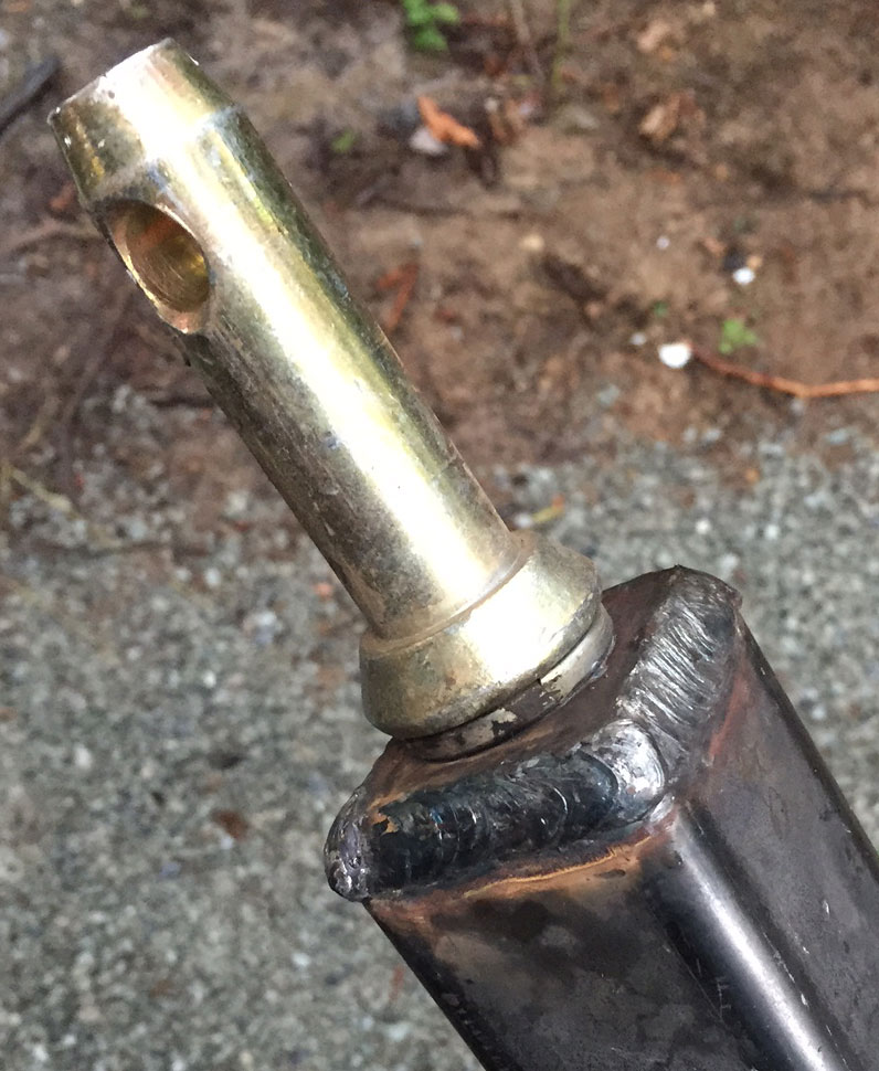

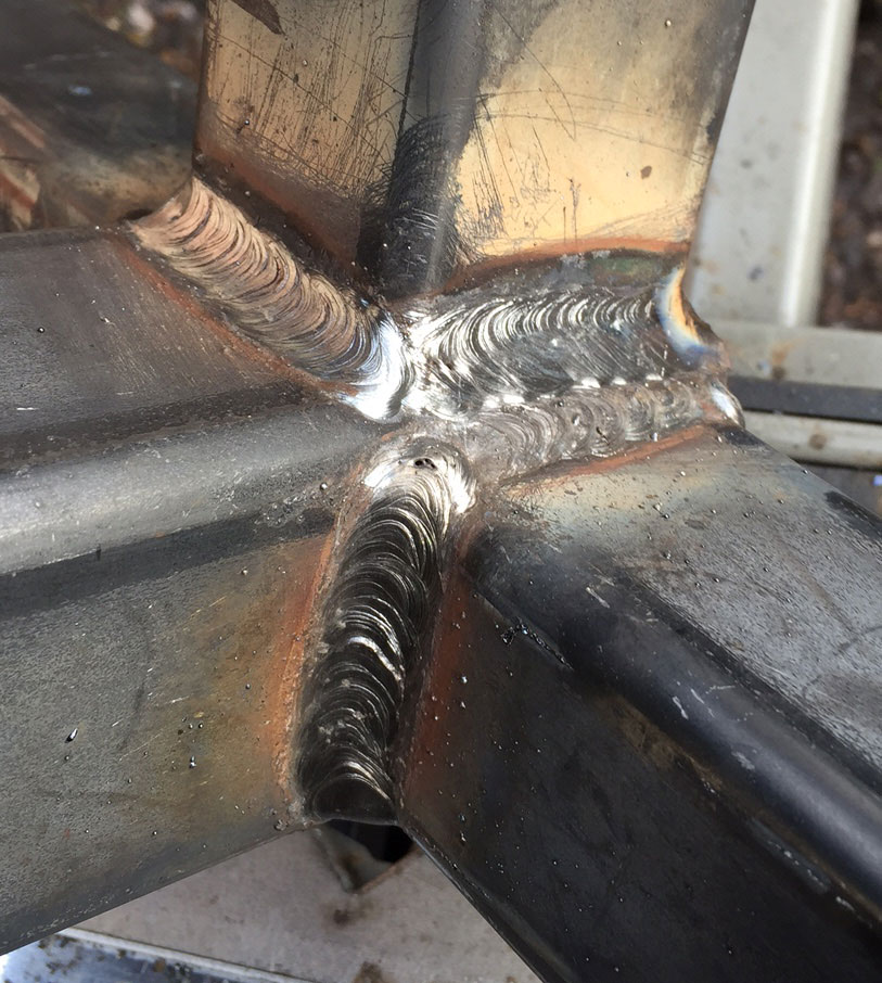

Oooops too late, I went simple already :D
It's made of 2x2x1/8" steel, and weighs 15 lbs.
417924d1427163562-question-about-steel-strength-3ptskidder3hitch-jpg
I welded the nut on the backside, then dropped it into the tube and welded all around.
417923d1427163562-question-about-steel-strength-3ptskidder2pin-jpg
417922d1427163562-question-about-steel-strength-3ptskidder1weld-jpg
Current plan: I intend to make a little cradle fork with 2 "tines" about 12-15 inches long (?) for lifting logs. I suppose it will have a crossbar so a smaller log can't drop between the tines. It will poke in just like a receiver hitch, and drop down the 11 inches to ground level. I'll add some chain attach points once I hang a log on it and see where they ought to go.
417925d1427163562-question-about-steel-strength-3ptskidder4-loglift-jpg
