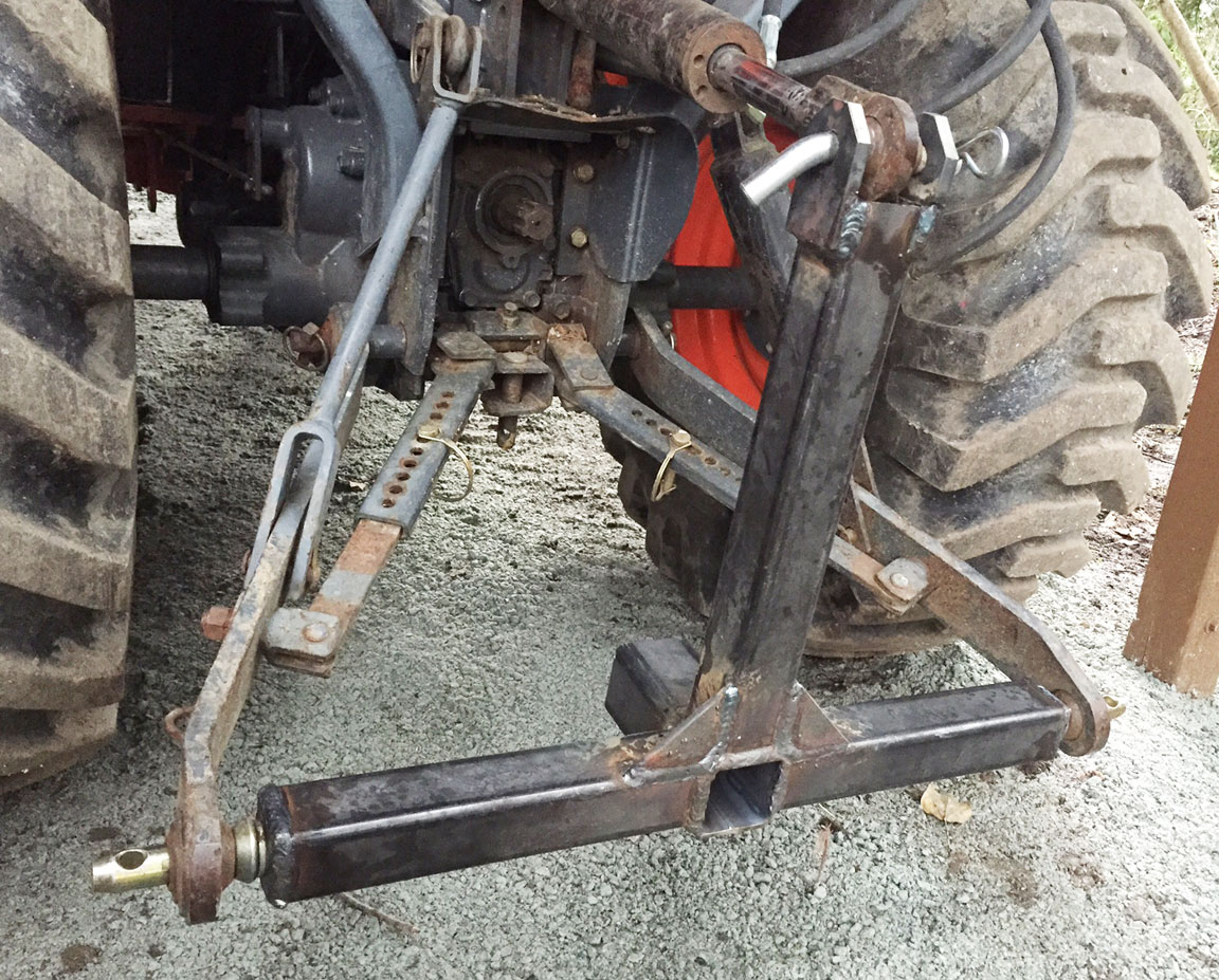

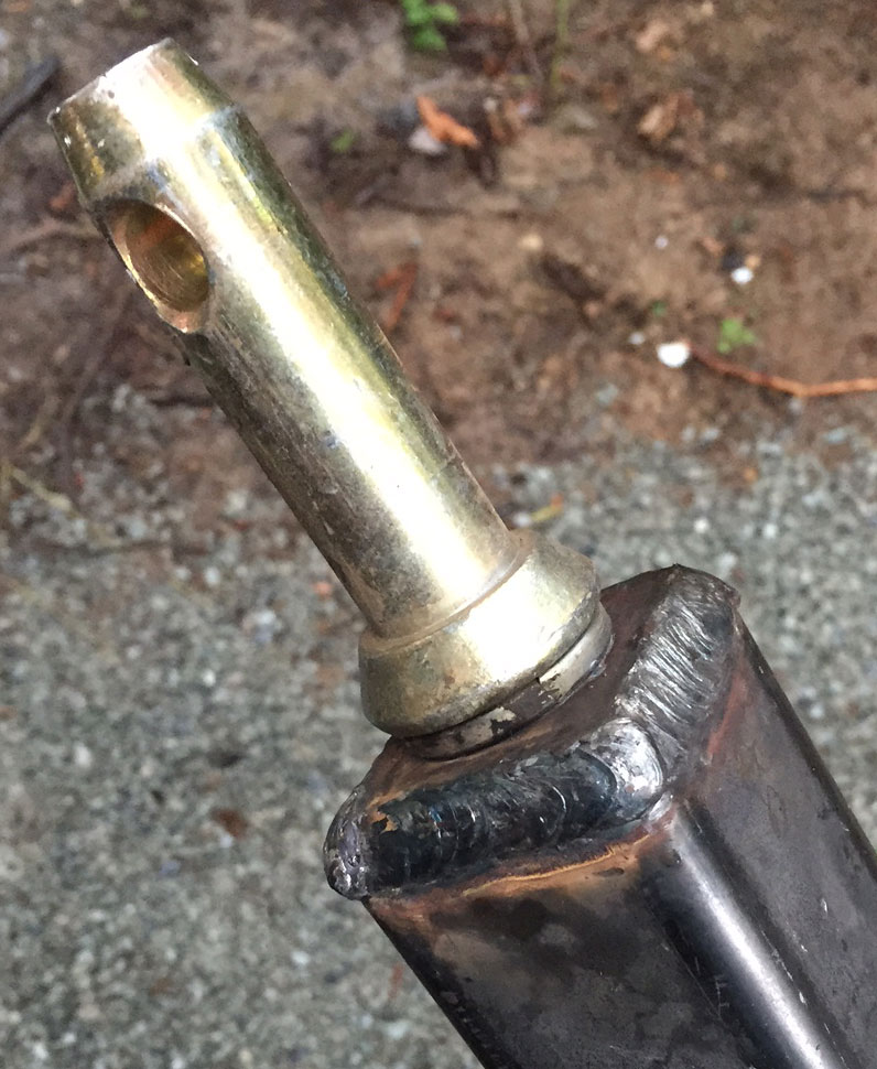

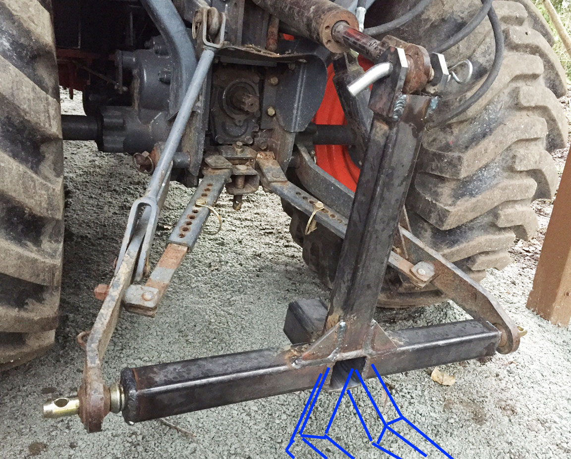

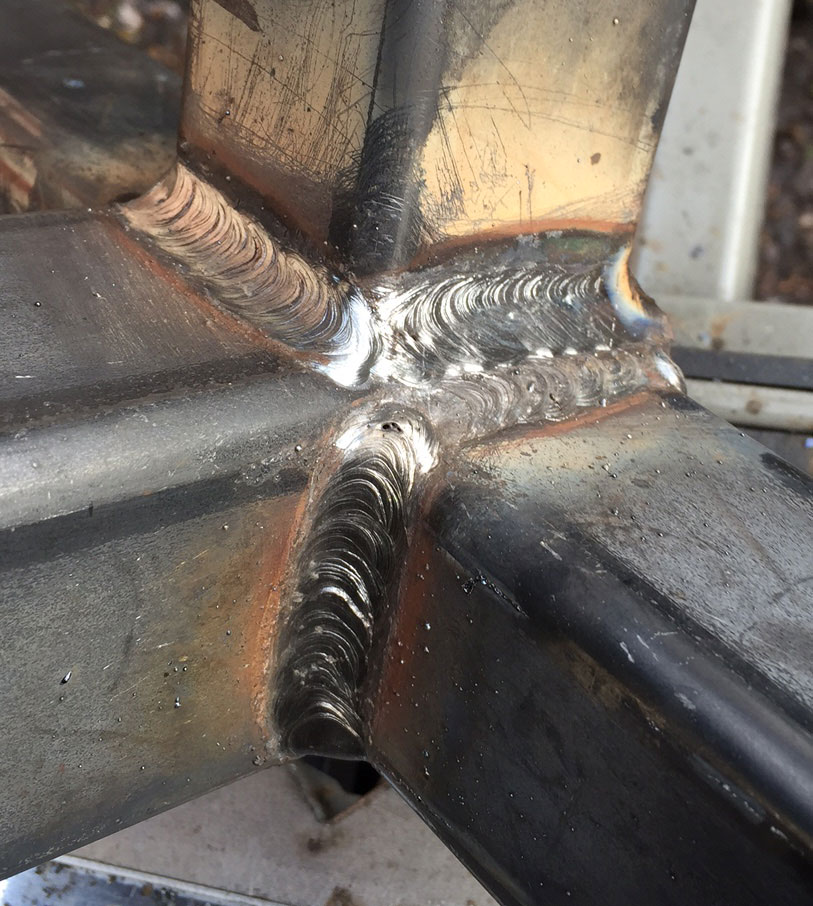

i4 around "1" is twice as strong, twice as heavy, twice as long to drill each 5/8" hole ( ! ), more weld-prep to get 1/4" penetration, and no need for all that. Metal will be twice the cost. And when you go to store it, move it, the thing is twice as heavy.
You are looking building at an attachment for a large tractor - to use on a small tractor. Considering adjustments for a small tractor is a reasonable course of action. As far as an i4 about "1" the forks in this pic probably have an i4 around 1.25 and a B7800 can't even think about this capacity.
418112d1427248196-question-about-steel-strength-p1020979-jpg
That said, I don't think you will be sorry if you just follow the drawing. It could bother your welder to have a drawing in hand and you're telling him something different. All depends on how he does his stuff. If he makes everything heavy thats one way and if he likes to optimize that's another way.

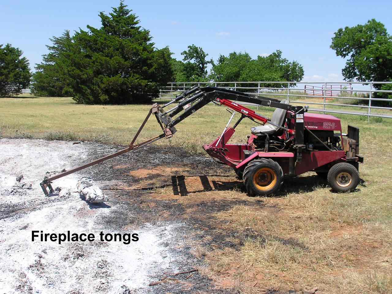

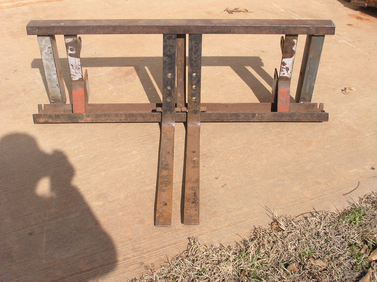

Do forks ever get used close together for "special purposes"?
Wondering if I need to add closely spaced receivers for any good reason?
That is the advantage of sliding forks. I made this frame over 30 years ago for a Craftsman garden tractor.
Added angle iron later to fit the TORO+Loader.
Made a boom pole out of thin wall 2" square tubing that fits between the forks.
Clamped on some "fingers".
Maybe you could make your frame with sliding sockets? :thumbsup:
