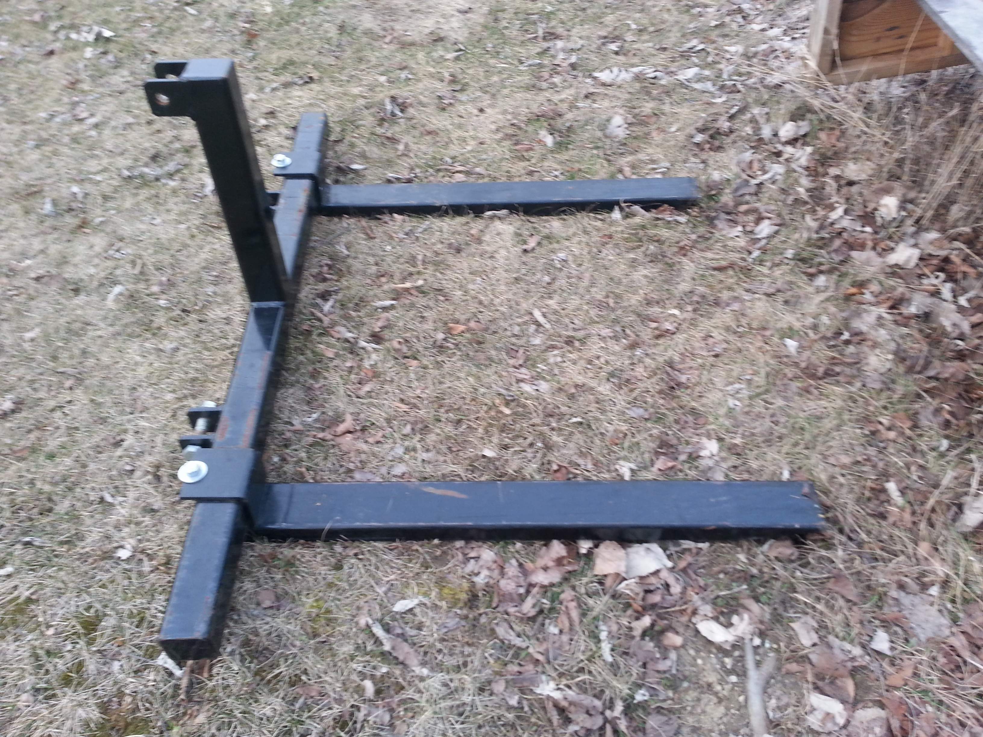

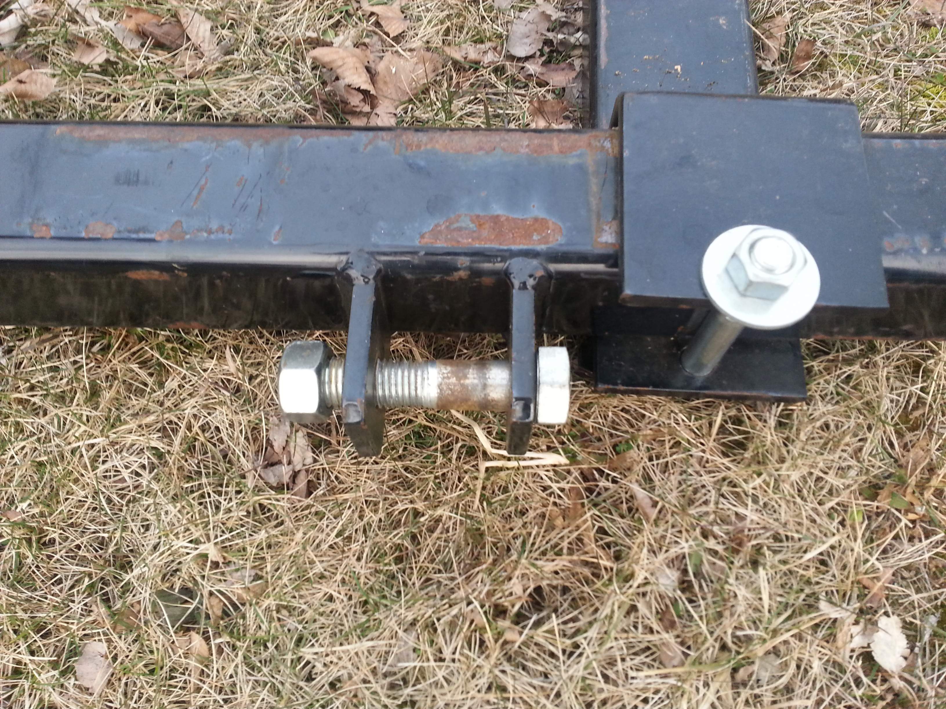

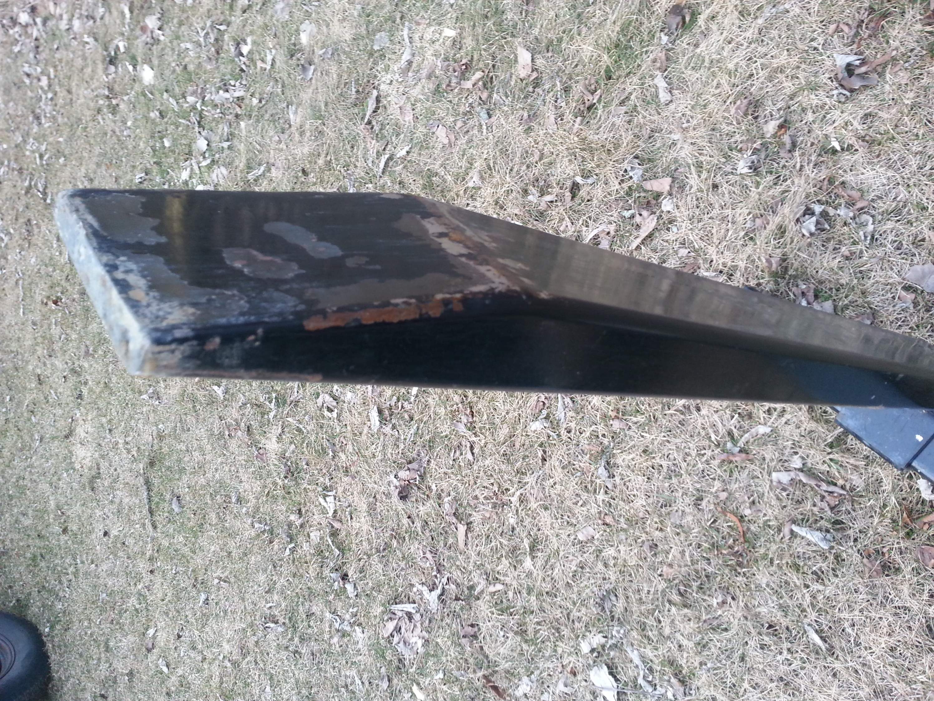

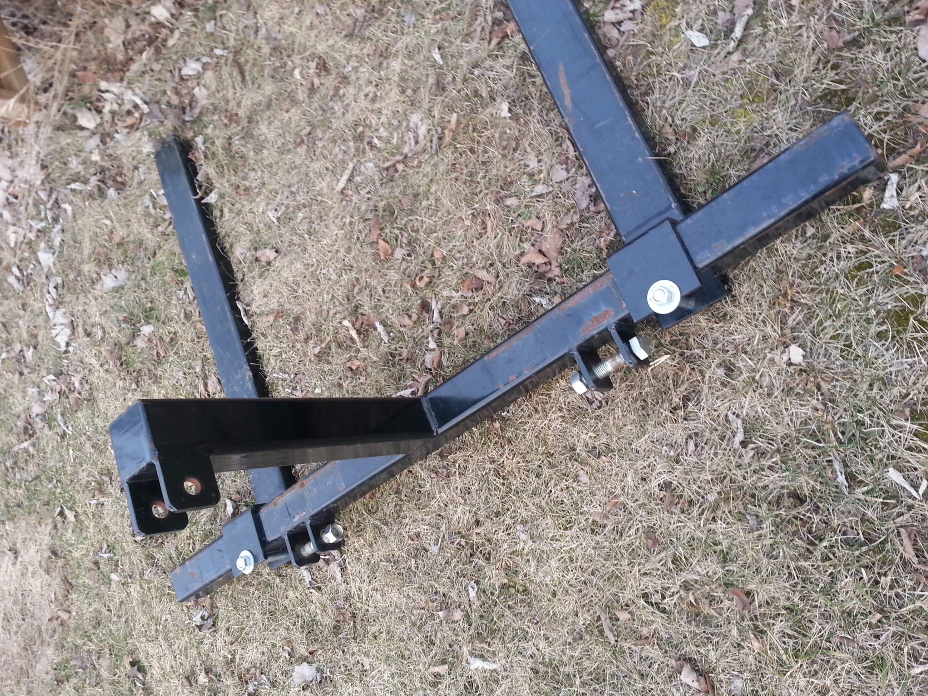

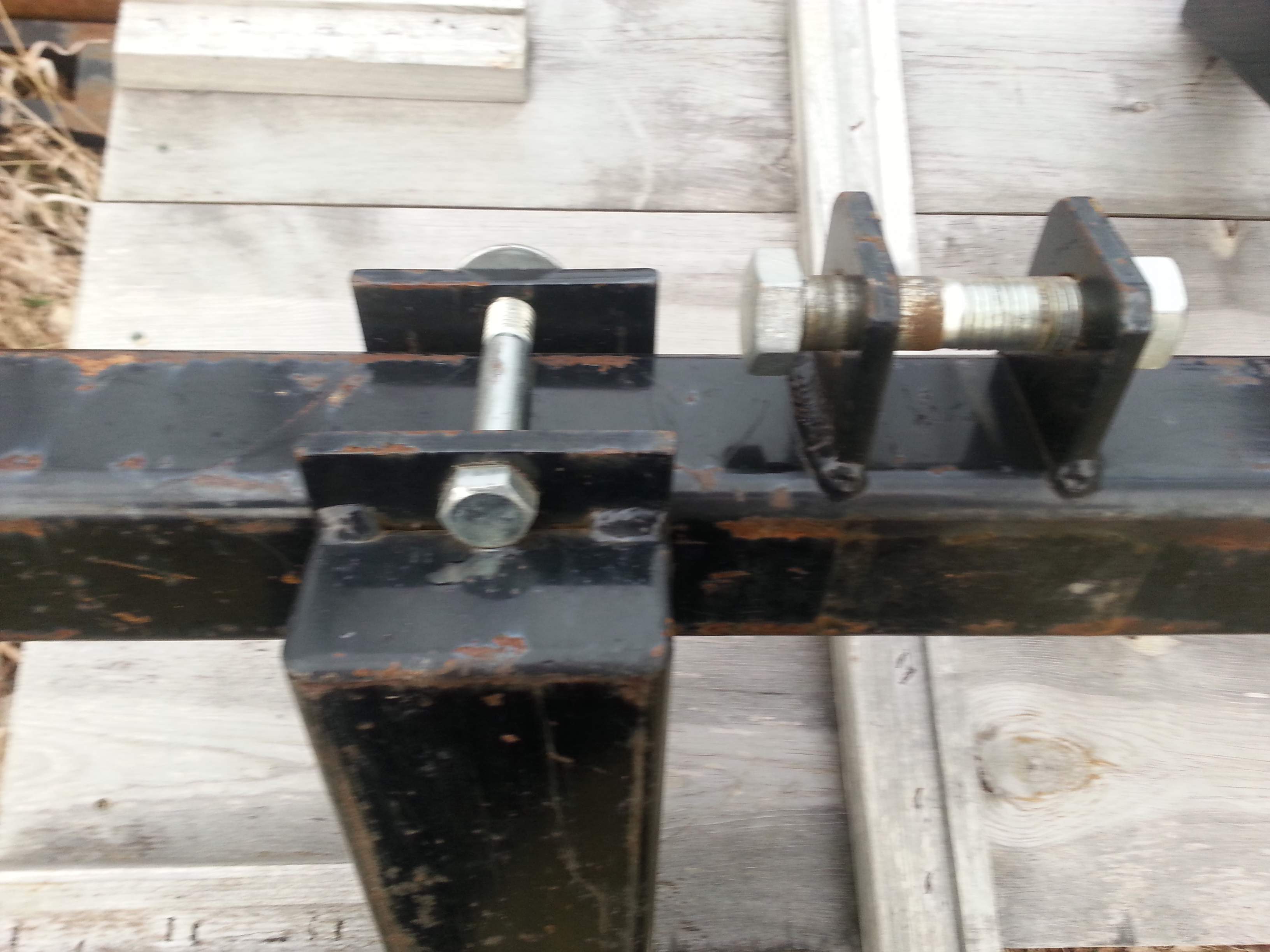

Here are a few pictures of the Forks I had built. The fab shop built this for $400 including paint a couple of years ago. I misstated the fork size in my earlier post - my memory is failing. The forks are 4x2x.156" wall. Also the Cs to attach the forks to the tubes are on top of the tube as shown. As you can see by the photos the ends are all capped for no water, i.e. interior rust. The tips of the forks are tapered as well. I have not weighed them. They are heavy but I can pick the assembly as shown and carry it so am sure they aren't over 150 lbs. I just used bolts for tractor connection for cost reasons but I use them so much I wish I would have put standard pins in.
I like the way they are built. :thumbsup:
Just go buy two standard pins now, and be happy! :D

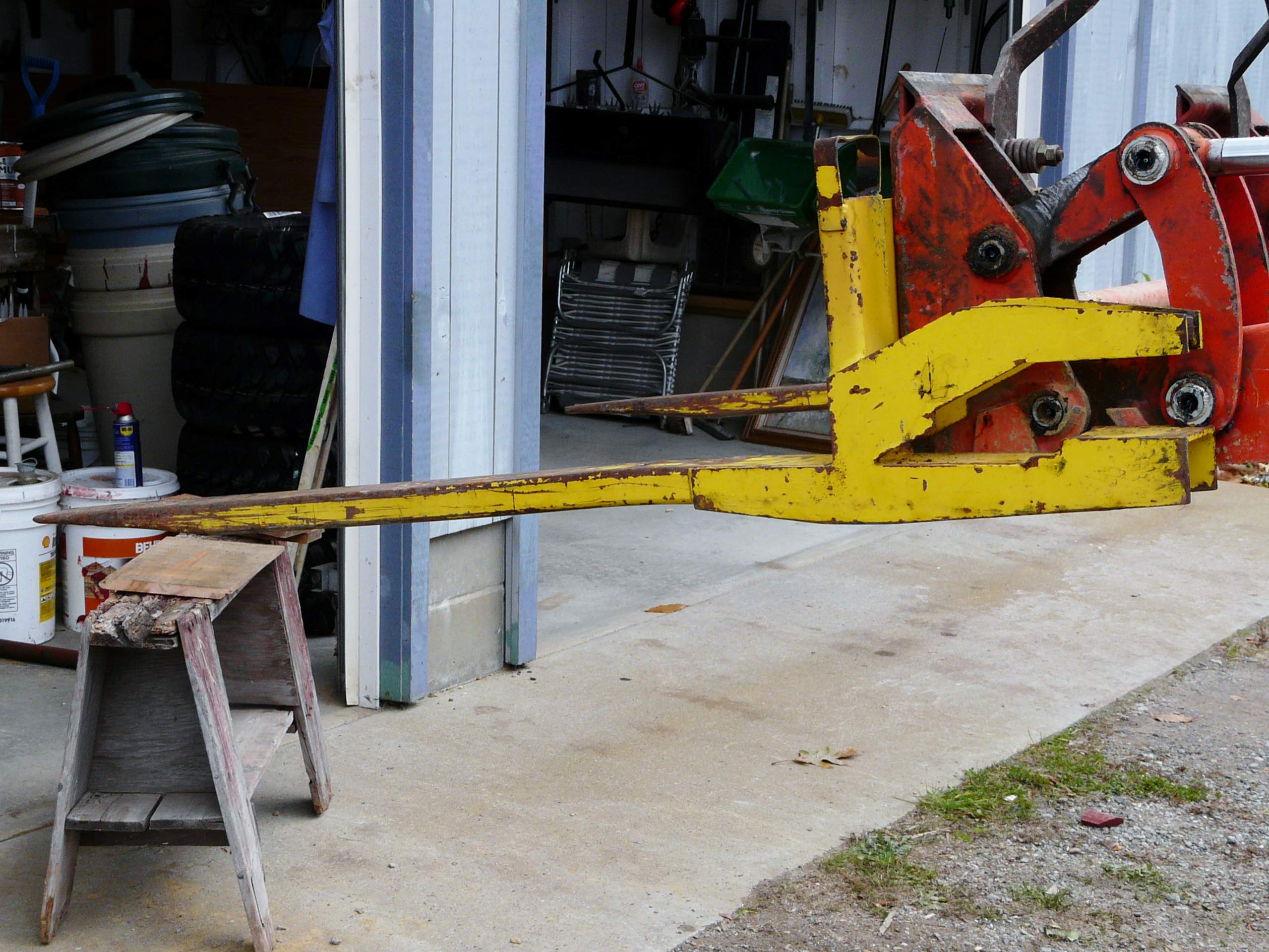

Jodebg - Don't know why I didn't read thru your post earlier but better late then never! I've just built and used my forks - see my posting if you haven't already:
http://www.tractorbynet.com/forums/build-yourself/329493-looking-tbnr-who-posted-their.html
Mine are currently only set up for the loader but later I'll do what Zick did (see post below) to set it up for the 3pth:
http://www.tractorbynet.com/forums/build-yourself/328811-anyone-built-set-forks-front-2.html

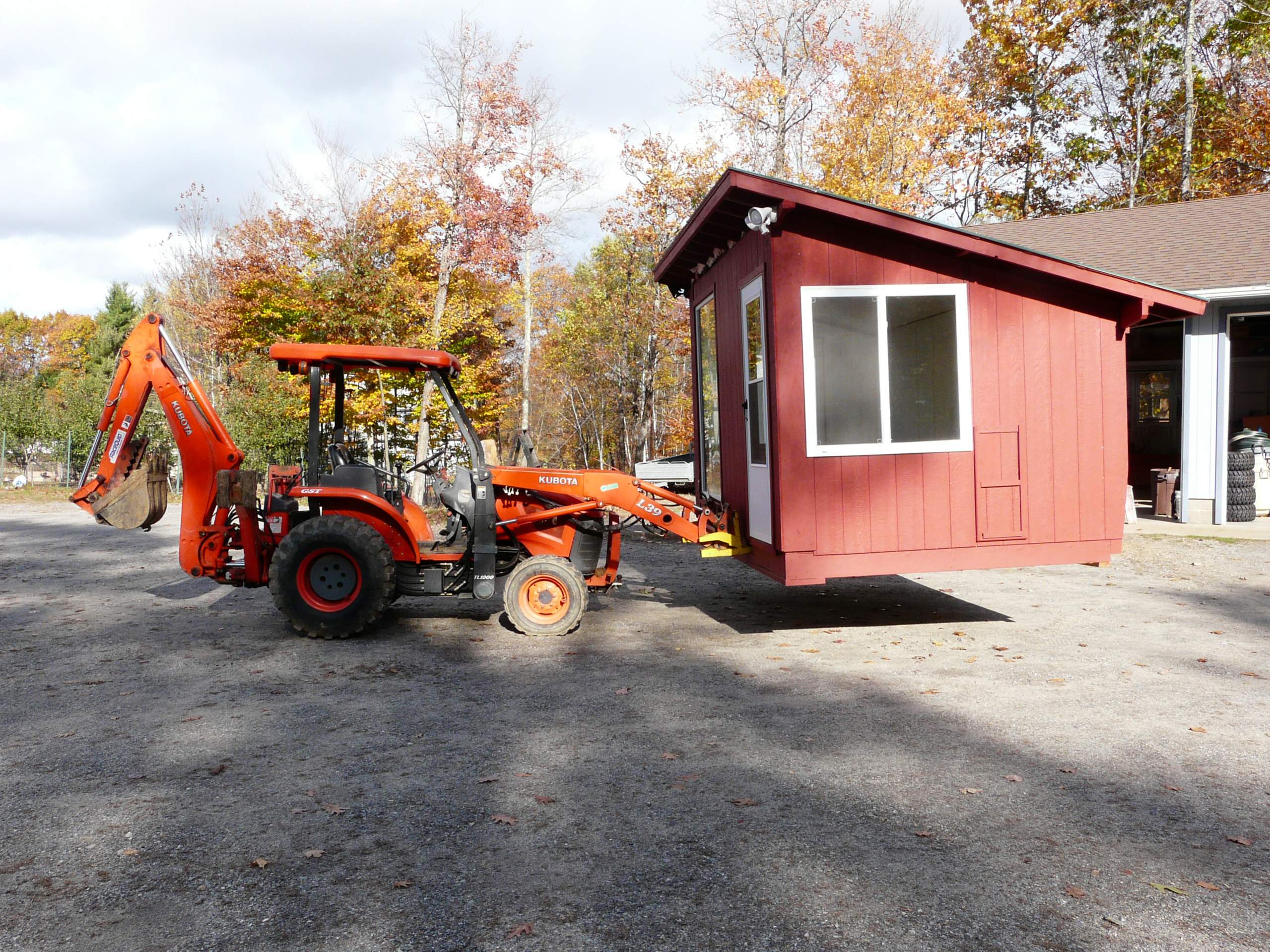

As far as strength is concerned check out my posting for that - I've posted photo's of the loads I've carried thus far. The "C" Channel I used is called "C3 @ 4.1" Measures 3" by just shy of 1.5".
At this point I'm quite confident they are strong enough for all the lifting I'll ask. Plus they are reasonably light, and fully adjustable. The only way I'll damage them is by pushing a tine into the ground at an angle and then driving forwards. But with a little careful operation that won't happen. For that matter if the weak point is the tine and it bends vs breaking something else on the tractor frankly for the few dollars those forks cost I'll happily make more!

Again, thanks for the headsup on this nice design.
You mentioned that you wished you had used pins.
Do the bolts offer any tightening force or only serve to lock the
c-clamps iin place? Pins would provide the same fundtion as the bolts?
What thickness steel did you use for the c-clamps?
Picture 1 and 5 are overall views. Pics 2 &3 are close-ups of the Forks attachment to the frame and the connection for the lower 3 pt arm. Pic 4 shows the tapered end of the fork.
View attachment 419046View attachment 419047View attachment 419048View attachment 419049View attachment 419050
/ Question about steel strength?? #151
I used 1/4" for the ears for the 3 pt attach points. I only tighten the nut on the bolts hand tight - just so I do not lose them - so know there is no clamping. I want the joints to be free to pivot.
the nuts can stick sometimes so i will be finding some pins that I can replace them with.
