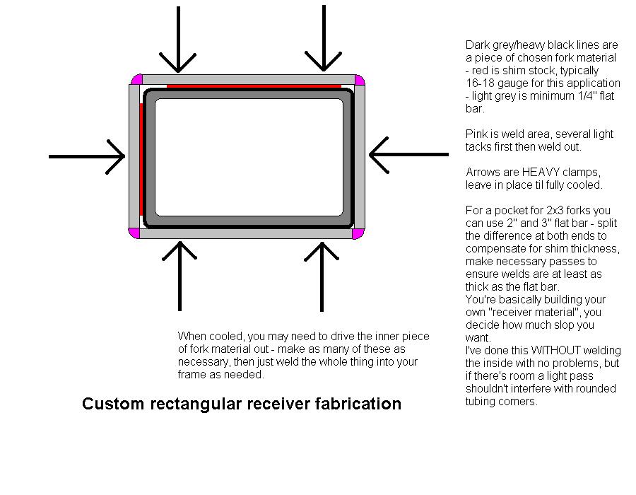

Joe, sorry I'm just now getting back - tax time, etc...
That 2.53 stuff you've been drooling over, AFAIK is ONLY available in SQUARE tube because that's what standard hitch receivers use.
My suggestion is something I've used a couple times with good results - build your OWN custom sized receivers, as many as you need, and weld them into your frame. This way you get the amount of clearance YOU need AND a receiver that isn't the weak link AND a PITA.
Here's how I do it - and if you're not experienced enough to know where, when and how much to weld and you're gonna have an experienced weldor do it, that's fine - I don't know what you're capable of, so take this sketch for whatever it's worth to you... Steve

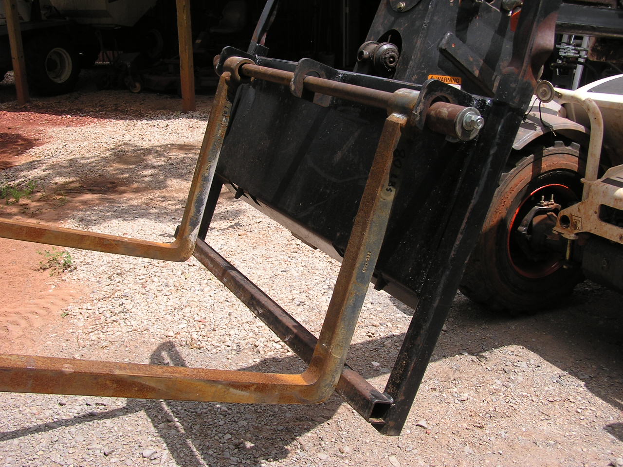

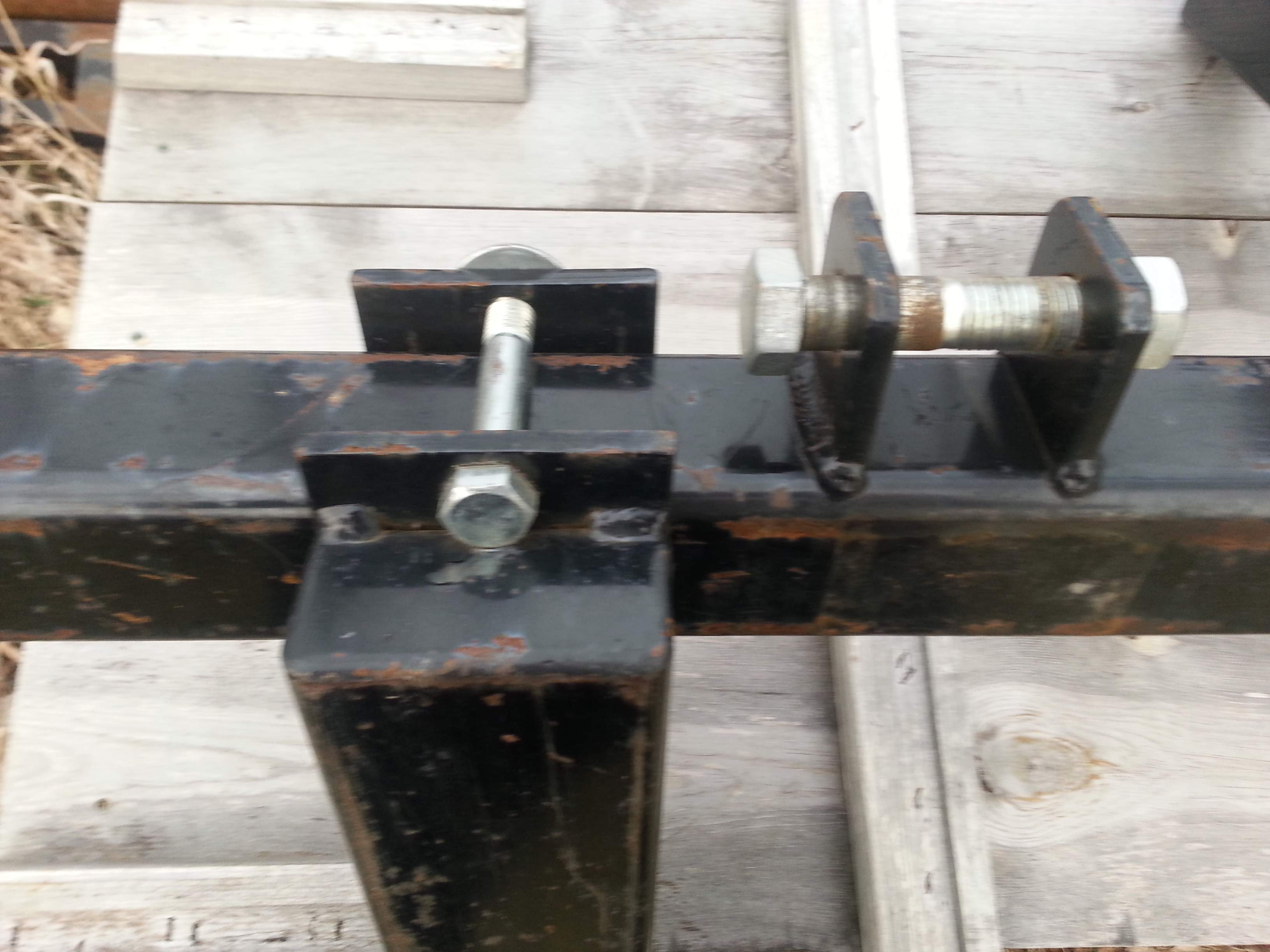

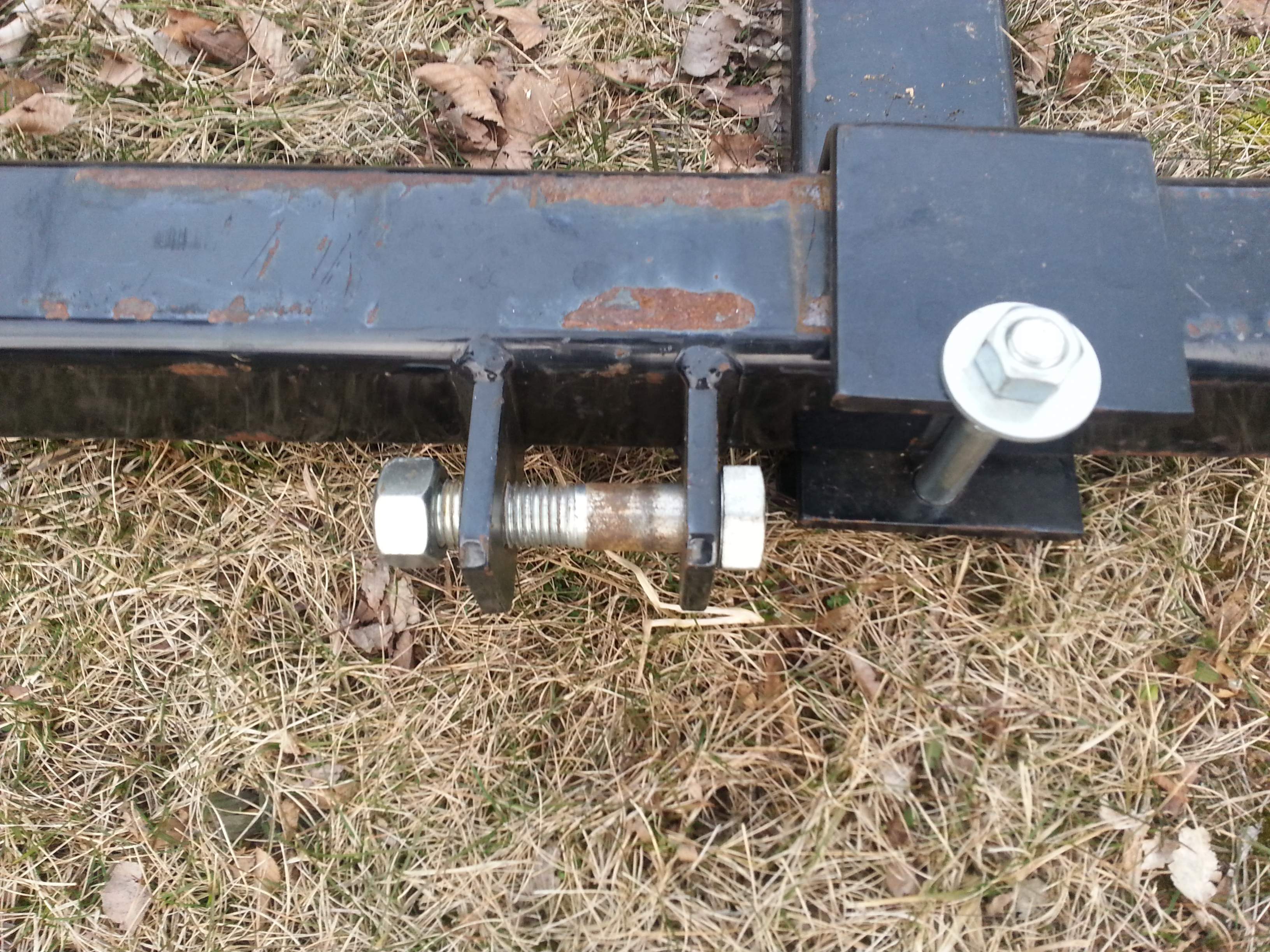

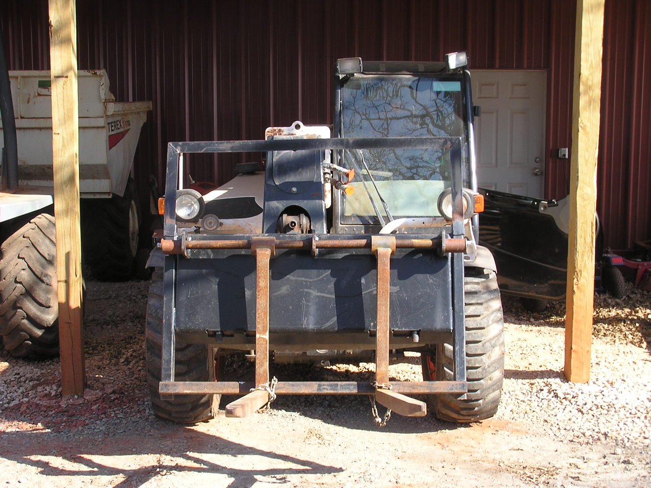

Here are a few pictures of the Forks I had built. The fab shop built this for $400 including paint a couple of years ago. I misstated the fork size in my earlier post - my memory is failing. The forks are 4x2x.156" wall. Also the Cs to attach the forks to the tubes are on top of the tube as shown. As you can see by the photos the ends are all capped for no water, i.e. interior rust. The tips of the forks are tapered as well. I have not weighed them. They are heavy but I can pick the assembly as shown and carry it so am sure they aren't over 150 lbs. I just used bolts for tractor connection for cost reasons but I use them so much I wish I would have put standard pins in.
Picture 1 and 5 are overall views. Pics 2 &3 are close-ups of the Forks attachment to the frame and the connection for the lower 3 pt arm. Pic 4 shows the tapered end of the fork.
Pallet Forks.jpgPallet Forks - Attach.jpgPallet Forks - Attach2.jpgPallet Forks - Tip.jpgPallet Forks Iso.jpg
