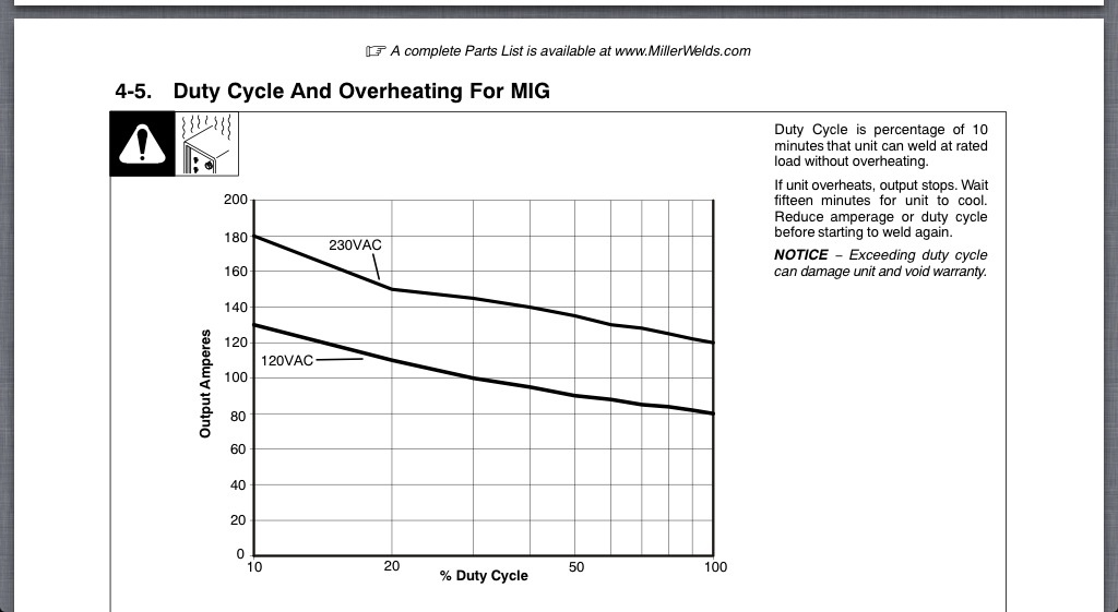

Miller Is usually pretty good about having a chart with the welder in the manual or online showing the duty cycle vs amps/volts for the entire output range of the machine
I agree, Mig duty cycle chart for the multimatic 200.

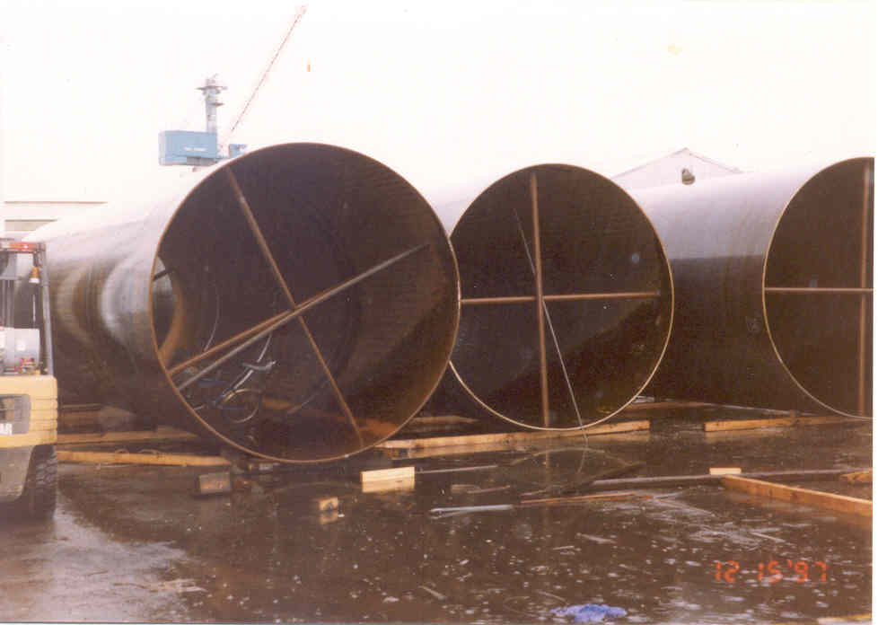

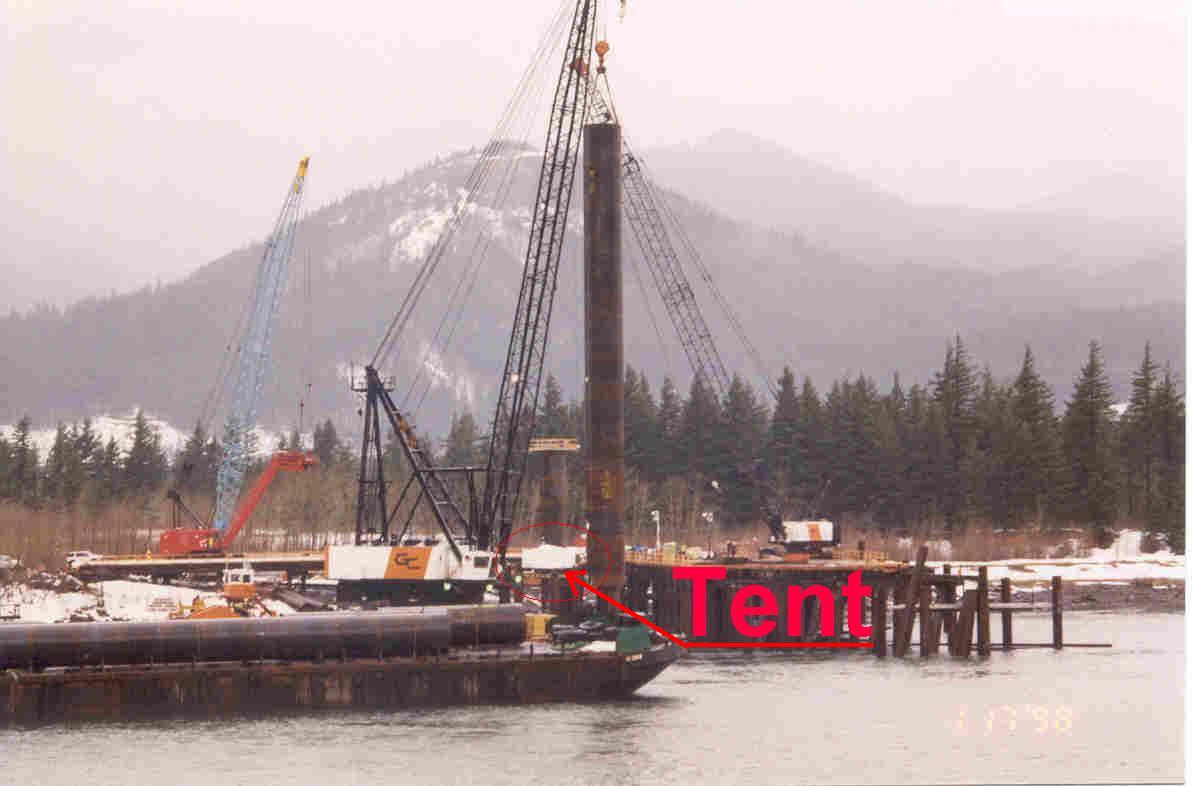

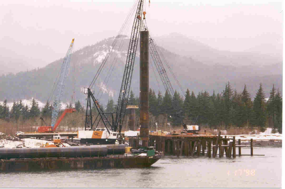

I've been on some pretty big welding jobs. Most of the time we try to have enough fitters where the welders do nothing but weld. Then again there are times when the welders have to do their own fitting.
On this job just down river of the Bonneville dam the welding crews were splicing these 1-inch wall 10-feet diameter pipe. 100% x-ray. Never had a duty cycle problem.
