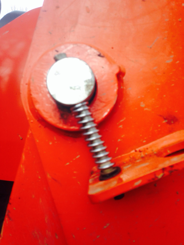

Richard,

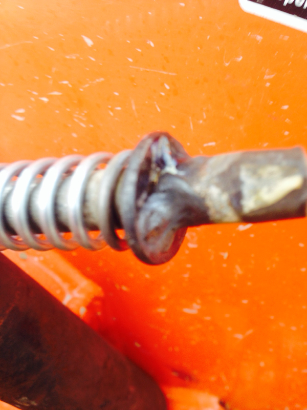

Do you see anything wrong with tac welding the washer to the pin instead of drilling for cotter pins?

Nope. Would be easy to bust it loose if you ever needed to replace the spring.

Because the ends of the small pin have been flattened so the pin can't fall out, you hafta use a larger washer. If I was gonna weld I'd grind the bottom end of the pin down to pin shaft size and then use a washer that fits tighter. Would be easier to tack weld that way.

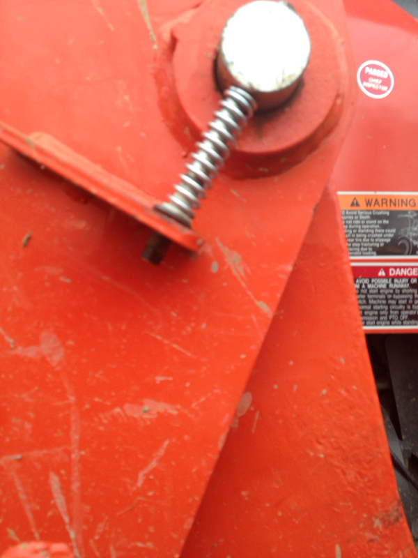

With the pin in position I marked where the washer needed to be.
We ground off a bit of the flared end to get everything to slide on easy.
I used a 10mm washer.
The spring came from Century Spring Corp. part # C-740 (5/8 x 2 1/2 x .080)
I removed half of a coil off the end of the spring but it turns out I wouldn't have had to.
