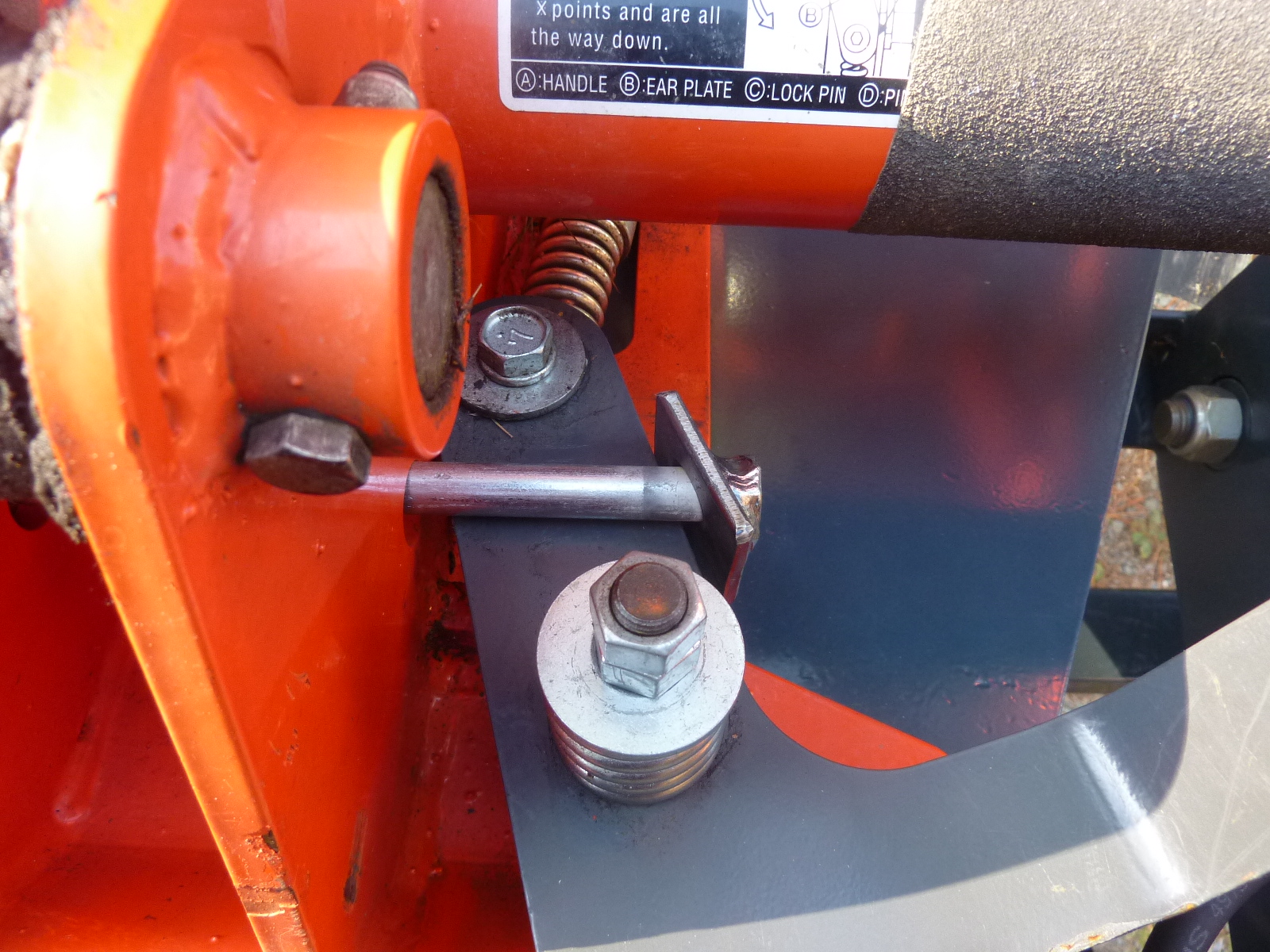

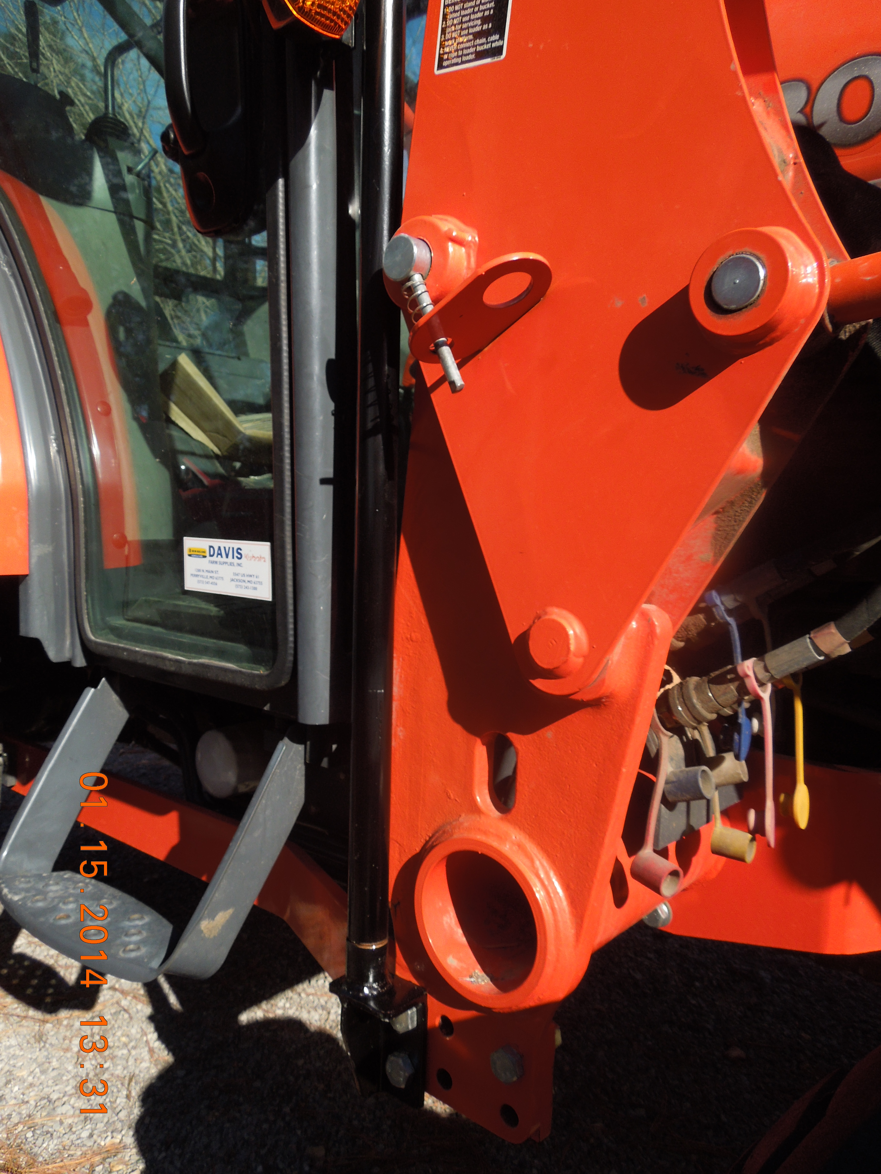

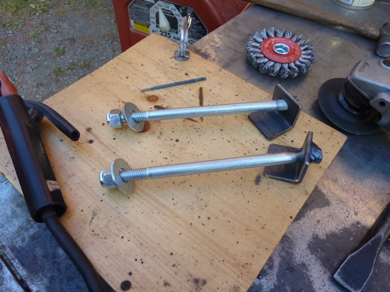

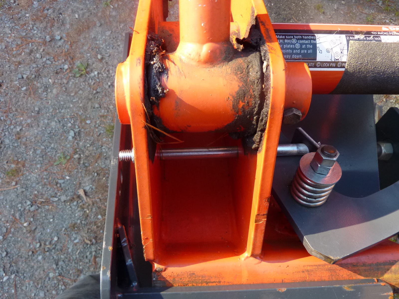

This is what did. No mod to the tractor. I made a hook from a piece of angle and an 8" long 1/2" bolt. Using the existing holes in the frame the bolt slides behind the lever below the pivot point. The hook holds the lever in the locked position.
Use the upper holes
Hooks
Hooks in place
You need a wrench to change attachments so it is not exactly QA anymore but I won't drop anymore attachments.
