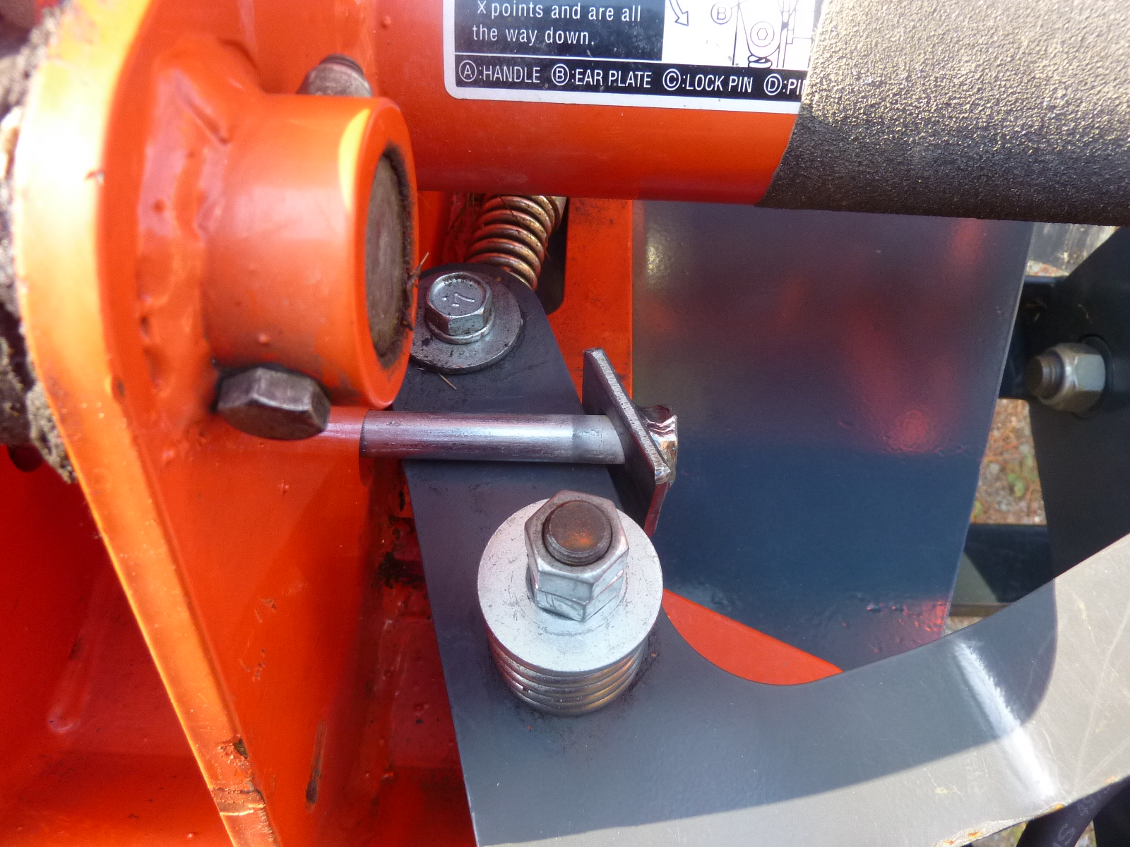

What size cotter pin and spring did you use?
/ QA Loader Frame Latch Pin Safey Modification
#62
I didn't pay any attention. Just bought a couple springs that I thought would slip over the end of the pin. Actually could have gotten a size smaller. The cotter pin was probably 1/16" diameter or something like that. If you feel it would be hard to figure out while at the store, pull the large pin and take it all with you. Before removing, mark the small pin just above your frame bracket with a sharpie so you then know how long of spring to get. Having it with you will answer the spring diameter/length question as well as the washer size and logical cotter pin size.

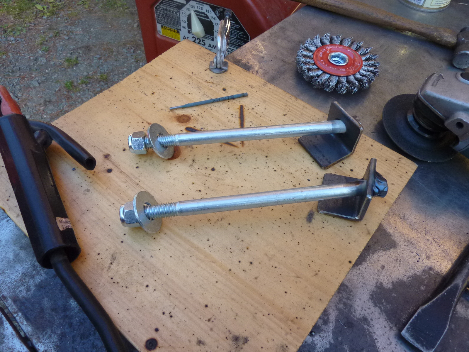

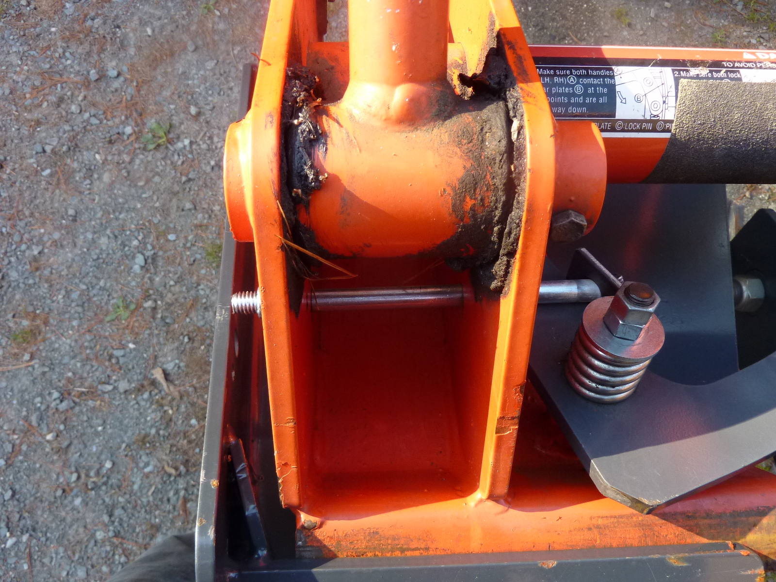

The same thing happened to me using my grapple to move and crush down brush. A branch pushed up the latch lever and while pushing down on the brush one side of the grapple came loose. Luckily I caught it before any damage. I can't see what you did either. Your pics don't come thru.
This is what did. No mod to the tractor. I made a hook from a piece of angle and an 8" long 1/2" bolt. Using the existing holes in the frame the bolt slides behind the lever below the pivot point. The hook holds the lever in the locked position.
Use the upper holes
Hooks
Hooks in place
You need a wrench to change attachments so it is not exactly QA anymore but I won't drop anymore attachments.
