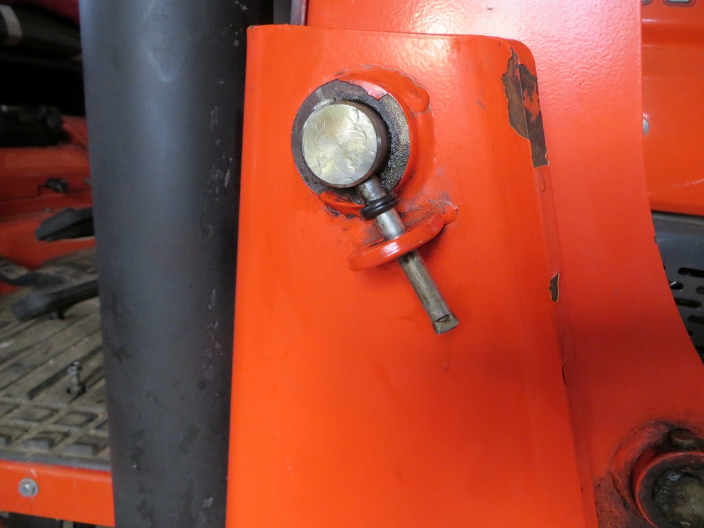

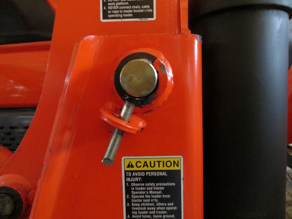

IMG_0044 (Medium).JPGIMG_0046 (Medium).JPGOvrszd, your spring setup is a nice improvement, looks like a factory job. I went out and looked at my pins, and while it's a similar arrangement, there isn't room enough to do a spring thing. I thought that a tight fitting o-ring would serve to give the locking pin enough friction to stay in place. I couldn't find the right size o-ring, but I found a couple of rubber grommets that fit. I must say that I've been using this loader for ten years, 1100 hours, and neither pin has ever come out on it's own. That said, if I didn't take your advice and secure them, one would be sure to pop out tomorrow. I believe it's called Karma...

My brother has my 5740 in his shop doing some work on it and he is going to modify the pins on it, my son will be doing it on our 8540 when the weather improves,:thumbsup:
/ QA Loader Frame Latch Pin Safey Modification
#28
View attachment 354040View attachment 354041Ovrszd, your spring setup is a nice improvement, looks like a factory job. I went out and looked at my pins, and while it's a similar arrangement, there isn't room enough to do a spring thing. I thought that a tight fitting o-ring would serve to give the locking pin enough friction to stay in place. I couldn't find the right size o-ring, but I found a couple of rubber grommets that fit. I must say that I've been using this loader for ten years, 1100 hours, and neither pin has ever come out on it's own. That said, if I didn't take your advice and secure them, one would be sure to pop out tomorrow. I believe it's called Karma...
Yes Sir, I'm a firm believer in Karma!!!
I like your setup. The pin has to jump farther to get out of the slot. The chances are extremely small. But then, Karma.
I tried the O-ring thing and believe it would work fine. Only concern was the o-ring degrading and falling off. Grommet would last longer. Great idea.
