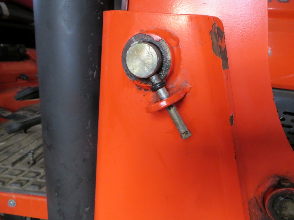

Richard,
Do you see anything wrong with tac welding the washer to the pin instead of drilling for cotter pins?
I'm headed to town for parts in about 30 min.

Nope. Would be easy to bust it loose if you ever needed to replace the spring.

I like the cotter pin design because it is easy to replace/repair with no tools.

Because the ends of the small pin have been flattened so the pin can't fall out, you hafta use a larger washer. If I was gonna weld I'd grind the bottom end of the pin down to pin shaft size and then use a washer that fits tighter. Would be easier to tack weld that way.

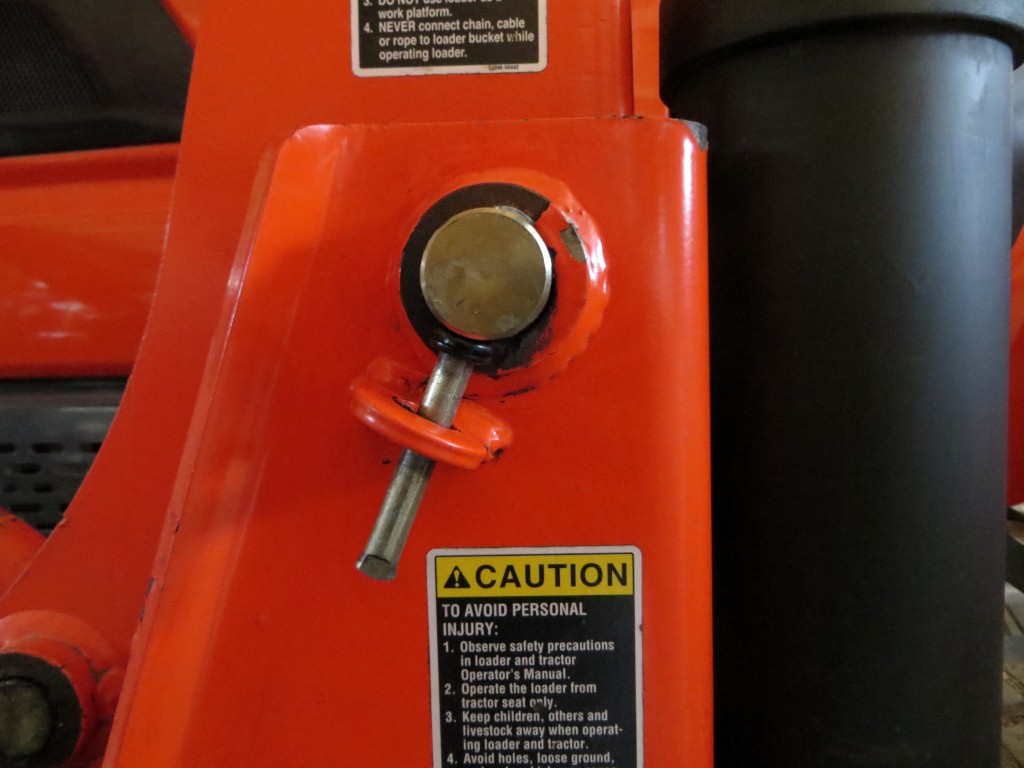

With the pin in position I marked where the washer needed to be.
We ground off a bit of the flared end to get everything to slide on easy.
I used a 10mm washer.
The spring came from Century Spring Corp. part # C-740 (5/8 x 2 1/2 x .080)
I removed half of a coil off the end of the spring but it turns out I wouldn't have had to.

Those pins ain't jumpin out Derek!!!! Good fix. Now the "rust police" are gonna jump on ya cause you didn't paint em. ;)

Easy boys! It's too cold to paint today!!! I have some other projects that I'll blast and paint all at the same time, come warmer weather.
I edited my previous post to include a few instructions that may help others.

I know this wouldn't be as fancy, but what about drilling a hole at the very bottom of the small pin and install small linch pin in to keep it from "bouncing" up?

Yep, that's another good fix for the problem. Only down side is it requires the operator to maintain a loose part and to remember to install it.
Someone mentioned their Kubota Operator's manual for their loader talked about such a latch pin. I've never saw one. You know how sometimes when you read a Kubota manual the wording seems oddly organized and the sentences don't quite make sense??? Written by someone of a different nationality and vocabulary. I'm thinking maybe the comments about a pin is in reference to the small pin we are trying to keep in place, rather than a separate latch pin.
